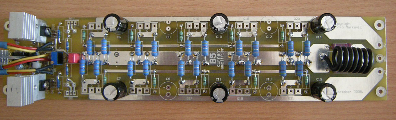

You have to read a lot about how to make a very good PCB, immune to parasitic oscillation. You have to make the PCB material work for you not against you. More than that, you have to iterate many times in order to obtain a stable amplifier.
Are the locations of the base stoppers critical?
Gate stoppers require to be close to the FET, to minimise the resistor to gate inductance.
Yes, the stopper resistor location is critical and must be as close as possible to the transitsor base

I have never sed "no basestoper resistors" or "no decoupling-capacitors" are required, only a good PCB layout is required to to tame HF oscilations in EF stages!
That is the brute force approach! The true art is to stabilize the circuit only by layout.
Base stoppers usually want to be right at the base. Stray trace capacitance on the base line outside the package will tend to defeat some of the action of the base stopper.

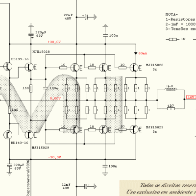

I'll always prefer only base stoppers and collector decoupling capacitors. A good layout do not require anything else beyond this.

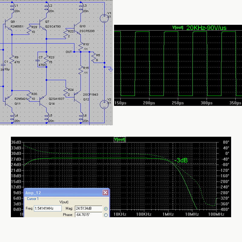

Have you ever heard about gyration theory in EF stages, where in some operating conditions every base resistance gyrate into emitter inductance? I will search trough my archive for that document...
Mihai
Mihai
Very good!!!Thanks for that one. I tried the inductors in my quest to turn my OPS into a Colpit's oscillator , success !! 😀 Adding that resistance absolutely stopped it , even with 100's of nH's on bases/collectors ,just small a burst of damped lower freq osc.... and with the 20nH .. nothing.
So with basestoppers everywhere , current sourced drivers , and those "magic" 10R driver collector resistors , this might "fly". Here is the "close" version (attachment) Another plus is the THD 20 dropped a little more (.002% @ 300w/2R 🙂 . PS - 2 more "christmas lights" (CCS led's) it will be a cool OP board (separate plugin voltage amp/ input board).
OS
My simulation "traditional" Locanthi T circuit

Guys,
Mihai
Yes, I am very familiar with it, and you are correct. We always need to do the math and take these effects into account.

One more point that is important in regard to the use of base stopper resistors. Their use does tend to decrease thermal bias stability. This is due to the voltage drop across them that results from base current. The base stopper should usually be sized so that this voltage drop is less than 10 mV with the lowest beta expected. Less than 5 mV is even more desirable.
An output transistor biased at a current of 100 mA and with a beta of 50 will have 2 mA base current. A 5-ohm base stopper will drop 10 mV.
Bob
