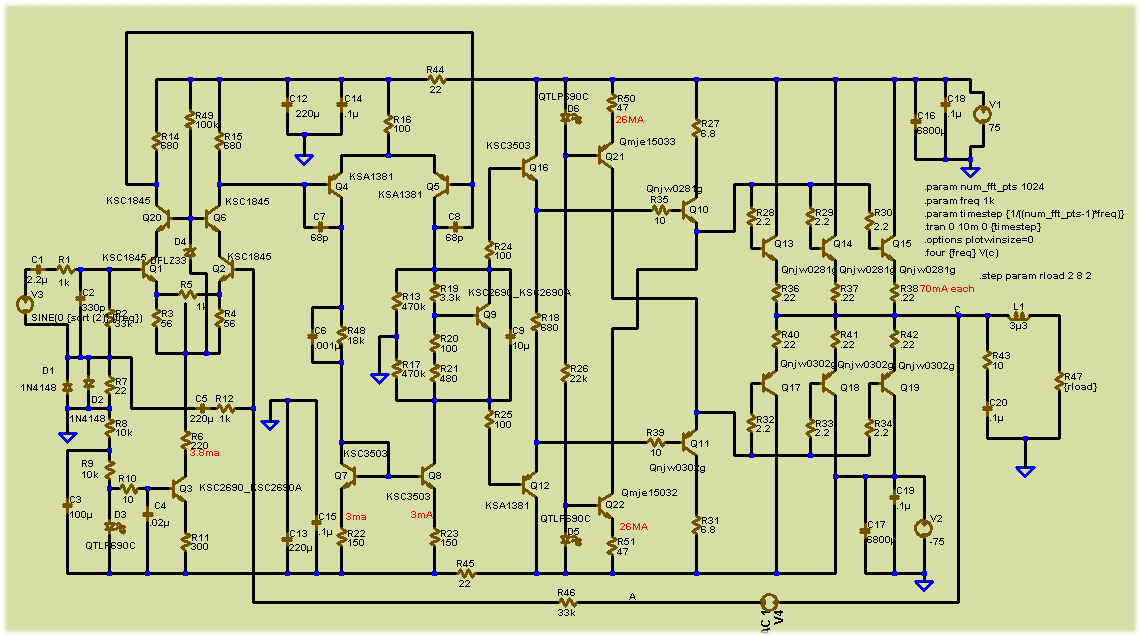

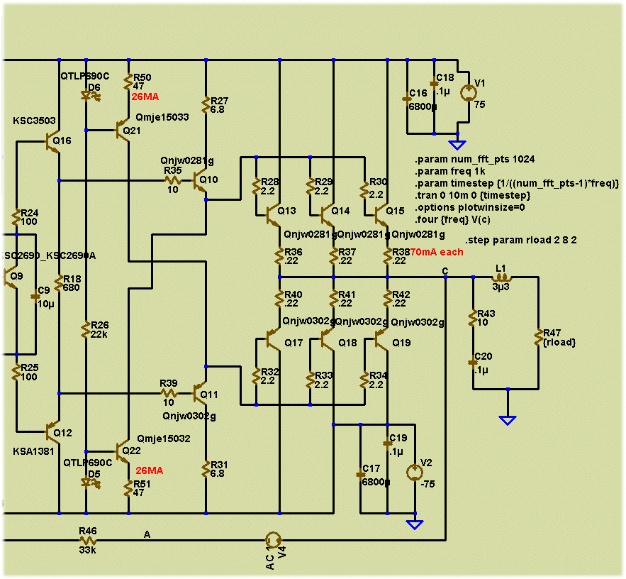

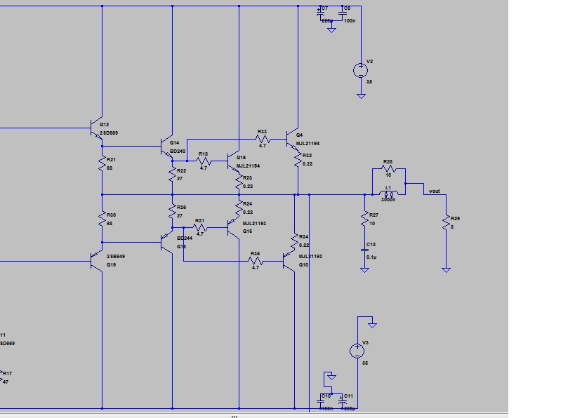

By roender - If I were you, I would try to decrease R27 and R31 to 1ohm and put 1uF from driver collector to ground
please explain ?? Those 2- 6.8R resistors do increase the "margin" against oscillation(as B. Cordell explained). They also cause a .1v drop from the rails to driver collector(not too much). The caps you mentioned , 😕😕 what are their purpose ??

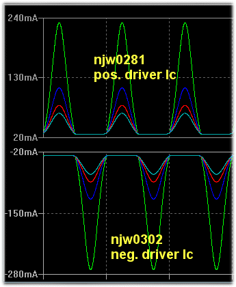

You would need more than 15mA trough drivers in order to have a good sounding amplifier ... I would say at least 100mA 😉
Do the math again, for voltage drop over thous resistors, and tell me if you'd accept such headroom lost 😉

Sorry , that OPS I just posted was my "jury rigged" triple to see if I would get a

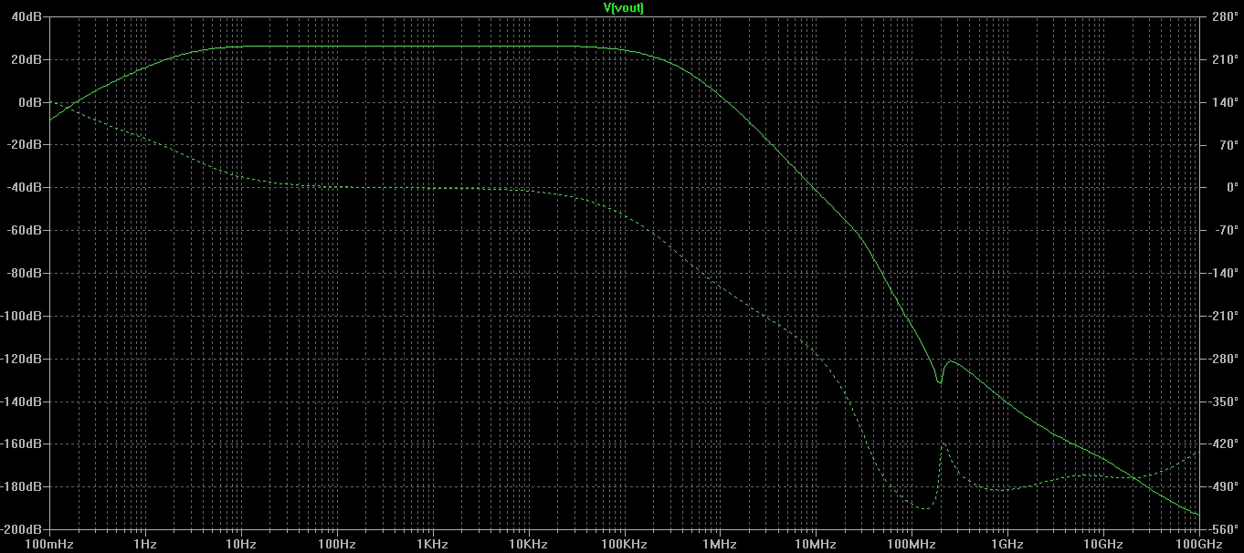

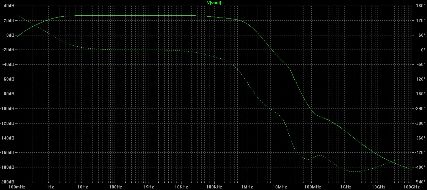

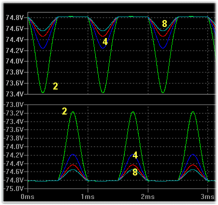

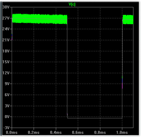

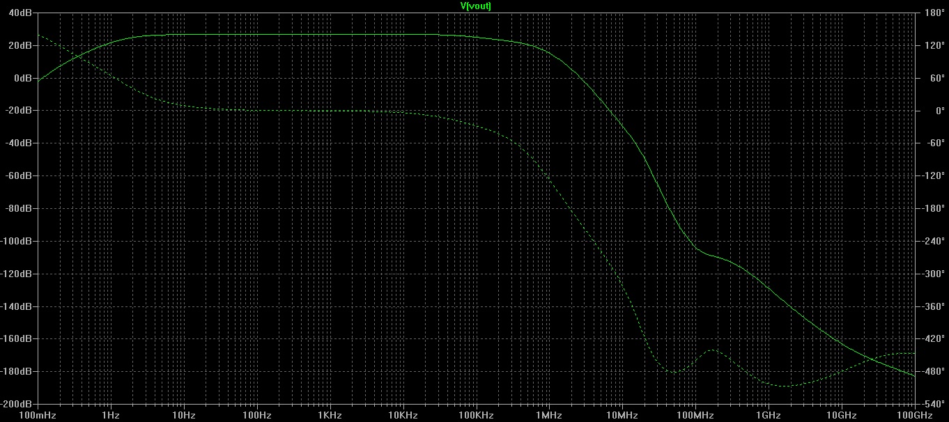

The final version will be this .. (attachment 1) , it will have trimmable CCS's (r50/51) , allowing for adjustment between 20-100mA . At 26mA , nothing switches off (attachment 2) simmed at 2-8R. If you say the best sound is with the higher bias , that will be just a twist of the screwdriver away. (attachment 3) is the voltage drop across R27/31 at 26mA. At higher driver currents , I agree the drop would be excessive , especially with a 2R load!!

ostripper ,
congratulations, this is the very best triple Darlington implementation so far, carefully chosen resistor values.

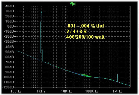

Thanks, by the fact that the simpler "T" version of it is still not malfunctioning , this conceptual version "T3T" will at least work , maybe even give me the H3/5/7 free result like the FFT (attachment 1).
Just a "sneak peek" at the full package (as it will be built - attachment 2).
Roender is right , the 6.8R driver collector resistors would be better as 1-2R (better for difficult loads).
PS .. on the fft I stepped 2/4/6/8R.... remains the same. Distortion and FFT also stays nearly the same at 10 or 20k !!

Nice circuit... you don't need the 10R base stoppers on the drivers. They never turn off.....

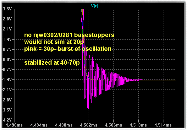

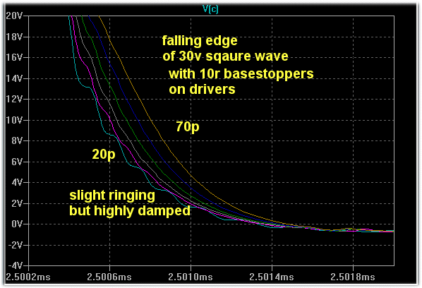

While nothing goes crazy without them 10R's (you are right) , I did notice while turning this triple (the whole amp)into a oscillator (too much OLG , not enough Cdom , highest Hfe in OPS) ,the addition of any low value basestopper to the driver (you notice it is an output) further damped the ringing that I was purposely creating (increasing the margin).
The simulations tell the story... (attachment1) is with ..and (attachment2) without.
Harmon Kardon , the apt , nakamitchi all use the stoppers between pre/driver.
To be fair , I tried a lower Cob driver 2sa1837/2sc4793 ...same "effect" , but at lower Cdom . "cause and effect" seems to point to the Cob of the driver.
PS - the amp "choked" at 20p/ no basestopper. With the basestopper I could still simulate at 10p (2mhz UGP !!).

I think the stoppers on th e driver (and pre-driver in the case of a classic T Triple) are important event though the drivers do not turn off, or only turn off in case of very heavy drive. I got similar results to Ostripper on simulation and in practice on the classic T tripple. As discussed a few posts ago with Bob Coredell, I ommited base stoppers on the output device bases - this was a mistake on my part that I am rectifying. The only way I cured it was with the 1nF/27 ohm network on the bases of the drivers - but this creates a pole that causes its own set of problems.

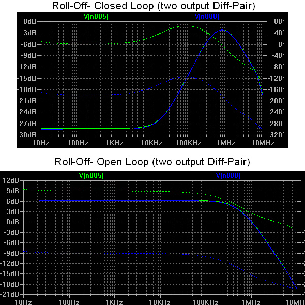

You should see the two Roll-Off (loop-DC) in outputs of the differential pair, if not is equal, may be unstable. I tried the VAS balanced of book Self and I did not like, Self also deals briefly this topology...
For example, Symasym is unstable at high frequency due to different roll-off. The solution was to reduce the Slew-Rate to make it stable (20V/us)
I tried several attempts, the better it seemed to me that here:

Slew-Rate is 90Vus
- I Not tried with current mirror
Roll-Off Supersym2:

hi . this is my output stage should i put base stopper resistors at the base of the drivers as well as 2 ohm collector resistors, and base stopper resistors at the base of the predrivers for better stability?

10-22R base stopper - Q14/16
2.2R - 10R collectors - Q14/16
100R base stopper - q12/19
You biased q12/19 with 68R , lowering the current gain of the triple , while this will increase stability , it goes against the whole purpose of a triple EF ,(minimum load on the VAS / VERY high GM).

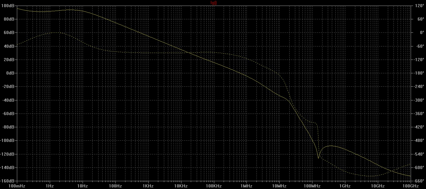

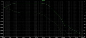

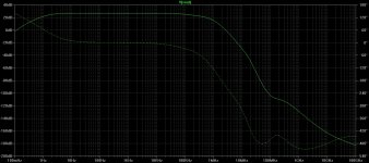

I have another questions.these are 2 loop gain (not closed loop gain) curves of the same amplifier using different values for lead and compensation capacitors.The output transistors are TOSHIBA 2sc5200-2sa1943 with a Ft of 30Mhz.
LTspice shows that there is a gain peak at a frequency of above 100Mhz.
should i ignore this because of its being at a frequency very higher than the transistors Ft or should i always aim for the curve to be a falling straight line with no peaks even at higher frequences than the Ft of the used transistor??

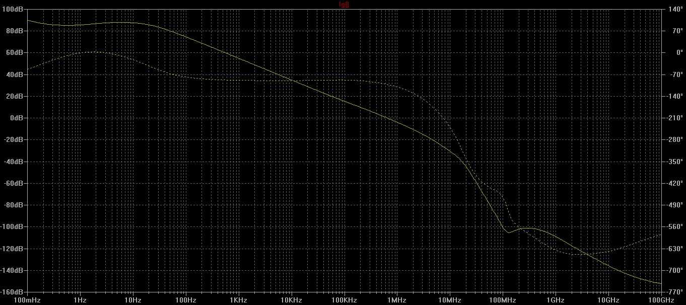

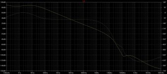

...and these are the closed loop gain curves that correspond to the previous loop gain curves. which one is better? i think the second one because the curve is more smooth.
