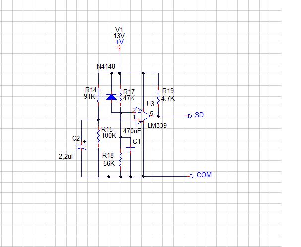

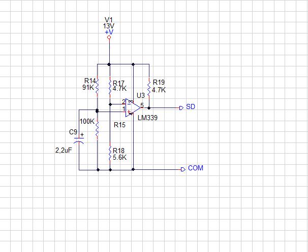

this circuitis lock only voltage drop.
indipendent from vc (10-15V).
tell me if you have also necessity of delay when enable SD.
Yeah, this will generate SD signal also when the power supply will sag under load 😀
And if the PSU will discharge slowly, then this scheme will not generate any SD signal... 🙄
But overall idea is very good! 😉

This scheme is a bit more difficult published in a post 68 on one transistor, what than advantage at it? It also makes signal SD for driver closing at decrease in a supply voltage and eliminates "a deenergizing impulse" what at it an operation threshold, V1 (13V) whence it is necessary to submit? Whether it is possible to replace lm339 on lm311?treshold difference is damping.
driver voltage not decrease significative at power.🙂
Yes, can replace with LM311 (this is only faster).
Cut-Off is Independent from Vcc.
function is immediately disable SD.
my help is difficult without your schematic.
If you put on this thread, I can control everything.
