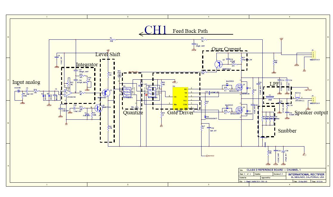

hi,
I understand that can be used to test, but you lose your time, work all signals incorrect up to driver .
In theory at Bridge 2 Amp (+ /-100V) produce 2500W @ 8R.
I do not think is appropriate for first Class D amplifier.🙂

If to replace on D1 on ad817 then it will be much better, what else it is possible to improve in this circuit? By my approximate calculations in bridge inclusion should be 4000W@4R.

your scheme is too simple to support a very fast op-amp or comparator.
new circuit must be designed, including pre-driver solutions must be good.

Hi all
This amp will work indeed, because its a circuit layout of a "irf example class-d amp application note" thats almost identical to the orignal ! i shall post the real deal on monday!

Otherwise you will need to have some reference voltage at the input integrator (TL081), you will get a big CLICK/POP at startup, maybe it will not start to oscillate at all, you will get the problems with non symmetrical clipping and so on... 🙄

The amplifier is work! But there is a problem: at inclusion sometimes there is a constant pressure (already 3 dynamics has burnt), and at deenergizing of races of 2 volts. What can it be and how to cure, it would be desirable to make stable smooth start and amplifier deenergizing, whether there was at you a similar problem? Output mosfets - irfp260, the driver ir2110.

Yes, scheme that I have resulted in the thread beginning, a power supply voltage +/- 65V
I have really burnt three dynamics from for constant voltage which appears and then at repeated inclusion it is not present also the amplifier normally works, I think that a problem in transient at start but I do not know as it to eliminate. Fuse did not use.

+/-65V without fuses - you are crazy! 🙂 Use it at least at the output! 😛
Did you followed your schematics precisely or you have skipped some parts from it? 🙄 Please post the photos of your prototype here (both pcb sides) and I can try to give some recommendations for you then 😉
I think it is almost impossible to remove the POP at startup in this schematic. Look at the startup circuit on T2, this is intended to generate a long negative output impulse at startup, to charge the driver bootstrap cap and to initiate the oscillation. In original IRAUDAMP1 they have used an output relay, which was intended to block this POP from speaker.
Also, I recommend to use some emitter followers to generate +/-5V voltage for input stage, because R11 and R12 with 4.7K can produce too low current to power up the input stage (at +/-65V this gives only 12mA).
This is the original circuit from IR, i dont know where the author got hes design from no wonder NO "design" or implmentation detail is given(typical when you copy and paste other peoples work.)
see below for the orignal design, the one posted here has some addtional changes supply changes and active component changes ect.. without reason behind it.
http://www.irf.com/product-info/audio/classdtutorial.pdf
