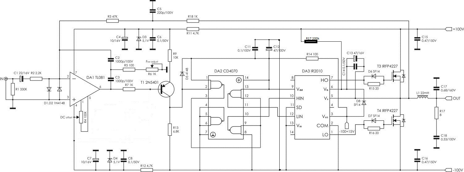

i never tried aCD 4070, but a CD4049 gives outstanding results as a comparator
I get 1.3mhz self oscillation
This is why the startup circuit on T2 was here 😉
Measure a voltage on C13 when the amp is 'not working' (before giving input signal). If it is less than 8-10 volts, then it is needed to reduce the resistor between Vb and +65V. Also, if the resistor is too small, then it can produce too high voltage on C13 and damage the driver. To be safe, simply put a 15V Zener diode (стабилитрон) parallel to C13.
Also, if this will not help, then it will be needed to insert delayed SD signal for IR2110.
Hi ,I have try as your suggestion . But there is 15VDC offset on out output also and amp did not start. Why?

btw: Your design lacks many important things.
btw2: An high-speed op amp can't do the work as a hi speed comparator, and vice-versa. A comparator is a one bit analog to digital converter. An op-amp is intended to produce an analog output. Comparators exhibit very high gain and slew rates at the expense of the inability to make them work in a NFB loop. 5mV of overdrive are enough to change the state of the outputs completely within a few dozen nanoseconds.

My post "LM339" circuit solved two problems.
startup and no"PUP" when switch-off psu.
