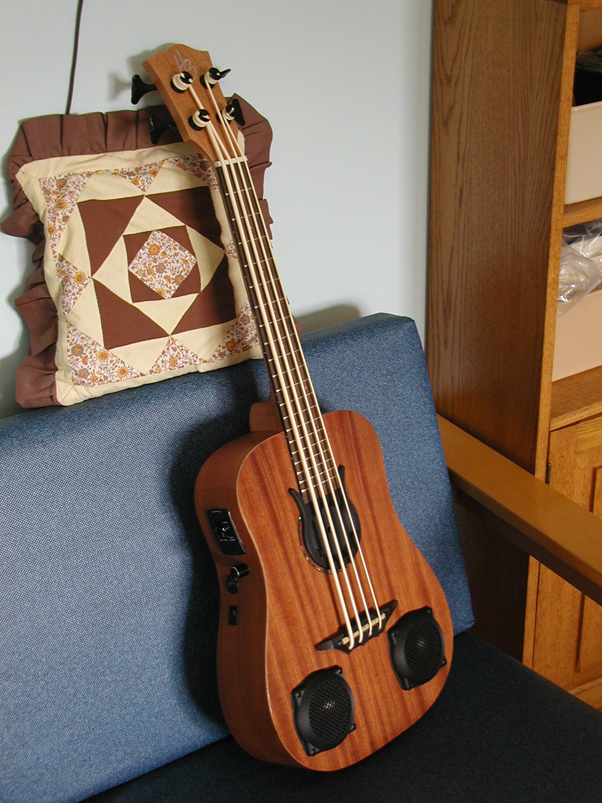

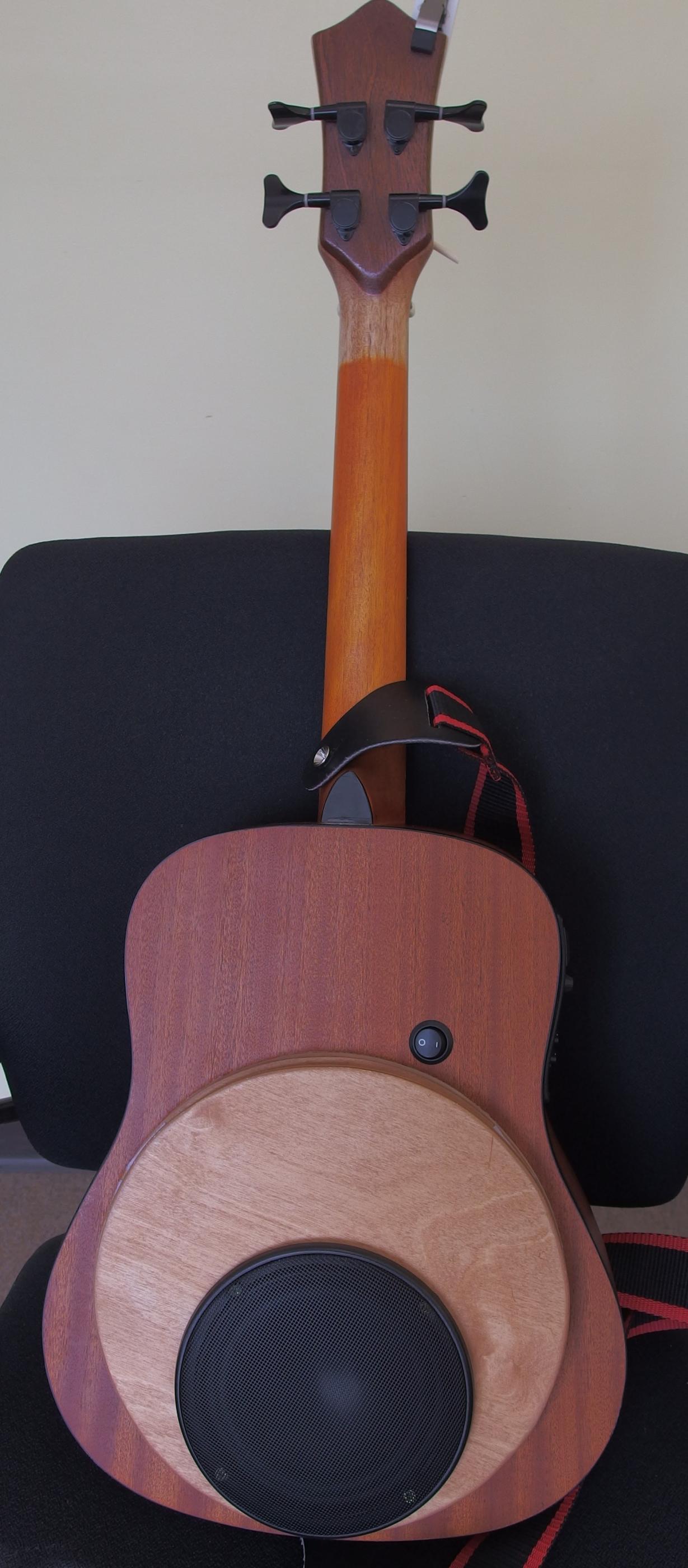

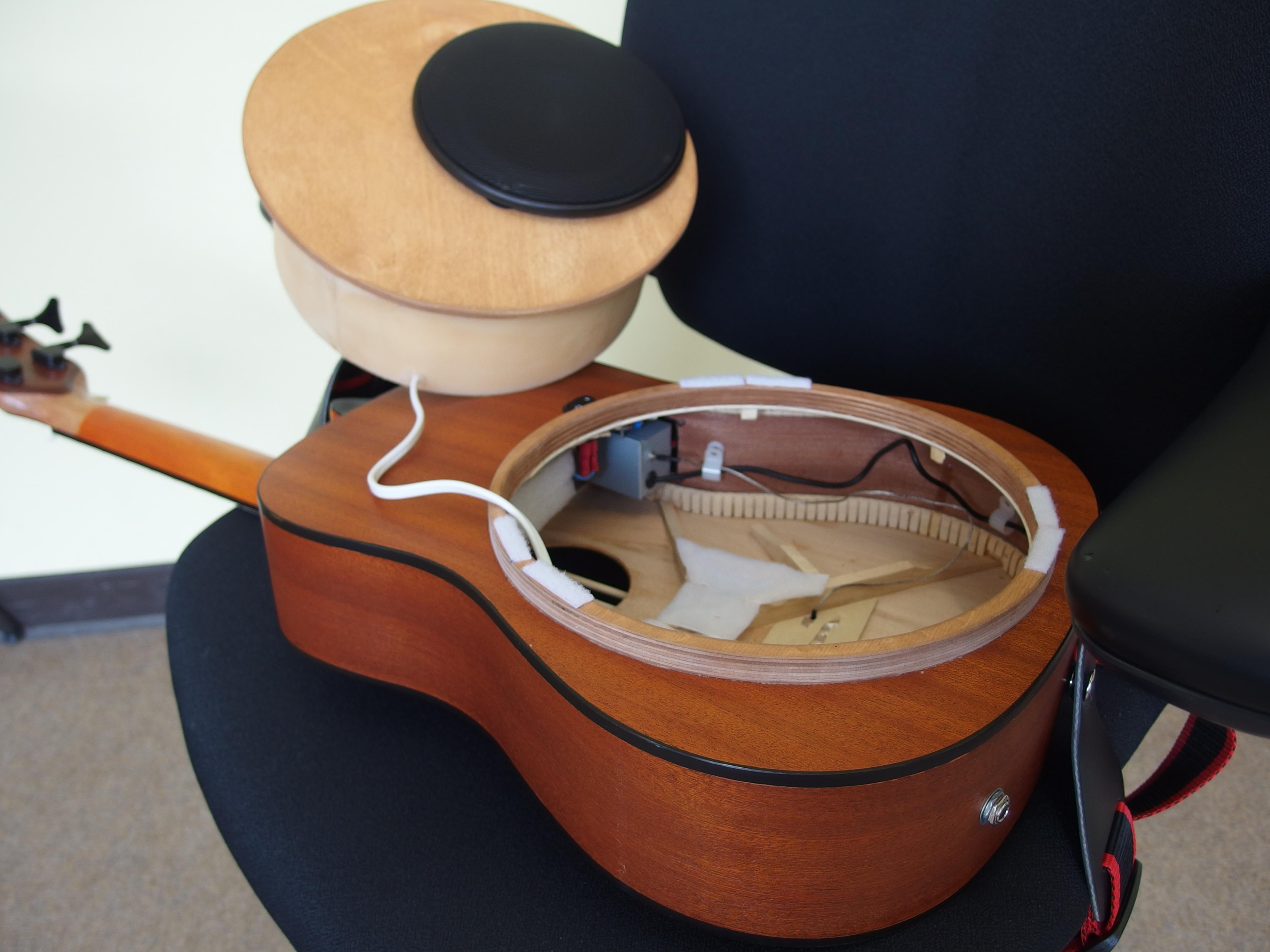

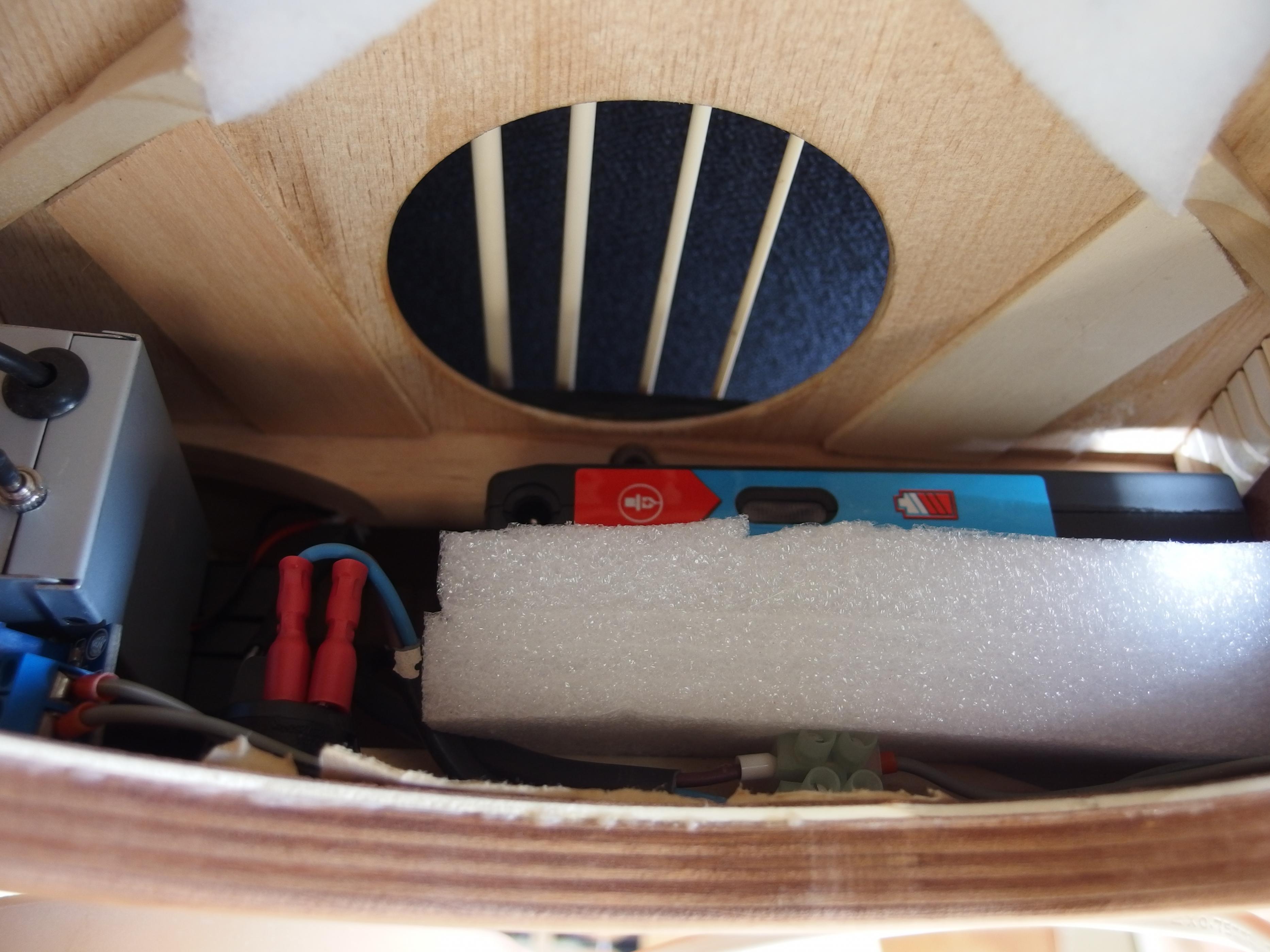

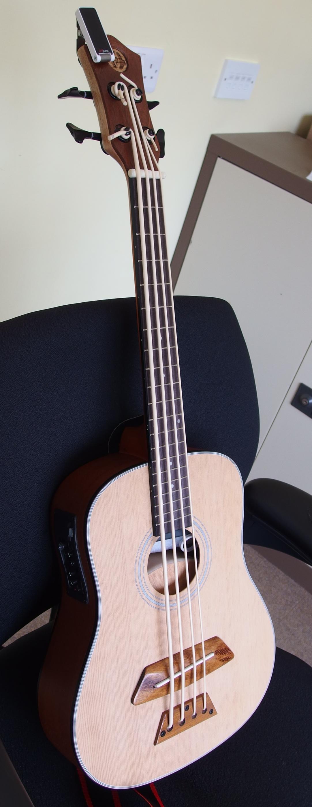

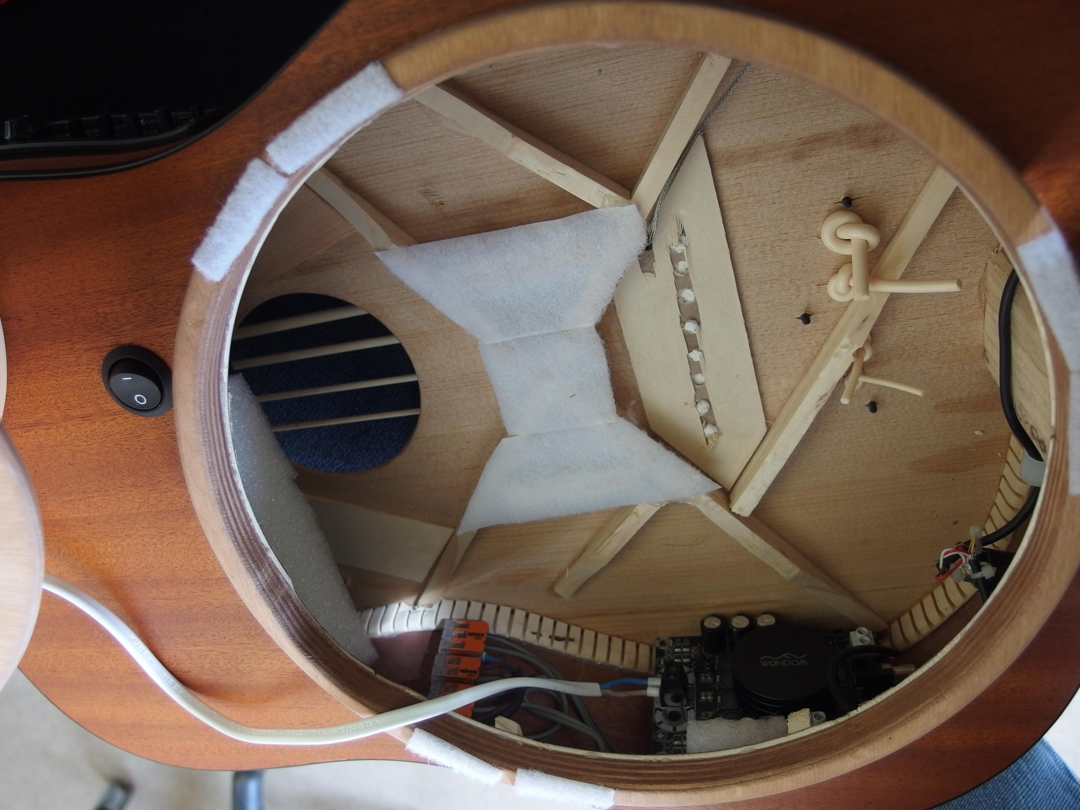

So I went ahead and built it.
Attached are a few pics of the finished article. I ended up having to change a few of the components. The amp did turn out to be bad, or at least when I replaced the cheapo Ebay one I originally got with this from Sure: WONDOM | STORE which is very nice, and solved all the problems I had been having with the first amp running at 24V. Same TPA3116 chip, but just a more quality build, I guess. Then I upgraded the battery. I figured out that the market that has exactly the batteries I need is the cordless vac market, and this battery is perfect: Spare Replacement 22V Lithium Battery For BCS01 Cordless Stick Vacuum | Vytronix with built in charge and cell management, and a clean (no DC-DC converter) 22V output. I got this linear buck converter: DC Linear Converter Buck Step Down LM317 Low Ripple Module Power Supply CF UK 664091564164 | eBay since I have been told that a linear buck converter makes the cleanest supply, and it seems to work great, converting the 22V to 9V to power the pickup. The Dayton driver in a 2.78L (biggest I could fit in the tiny uke) works fine, even though theoretically the enclosure is way too small. I may one day get a bass guitar EQ to shape the tone better, and boost up the bottom string a bit, but it works pretty good without, and I can get serious volume before it starts feeding back. Actually, at top volume it still works OK, though it can start feeding back if I don't keep the strings damped. Reduce the volume off the top slightly, and I get no feedback at all, but still get a seriously loud sound, enough to rattle pots in the dish drainer on the other side of my living room!
Overall, I am very happy. The uke has already had it's debut jamming with some friends, to favourable reviews. It really does sound like a upright bass in a much smaller and more manageable package.
Anyone else want to have a go?
Congratulations!Overall, I am very happy.
No comfort issues from the loudspeaker firing directly into your tummy / chest while you play?

Congratulations!
-Gnobuddy
Thanks!
Actually, I carefully positioned the speaker so it fires just past my side, at least with playing position I use, and it seems not to make a difference to sound levels to have it firing out the back.
That was the surprise to me, the speaker on the back and enclosed. Both which should help with feedback. Would love to hear it.
I might get around to posting a recording, though I'm not sure I want to embarrass myself - I'm no bass expert like this
You can see why I put the speaker on the back if you compare my uke aesthetically with my friend's uke that I got the inspiration from, see pictures attached. I wanted mine to not be obviously electric...and I knew that the sound would be heard from the front no problem, since the low frequencies are not really directional at all.
