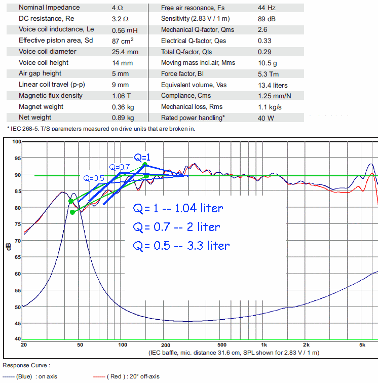

Even without WinISD, we can hand-wave our way to some interesting conclusions. Your chosen speaker has a 44 Hz resonant frequency, and a Vas of 13.4 litres.
If you mounted your speaker in a hypothetical infinitely large sealed box, it would have a 44 Hz resonance. If you mount it in anything smaller than that, that resonance frequency gets pushed higher. The springiness of the air trapped in the box adds to the springiness of the speaker's own suspension (surround and spider), and has much the same effect as putting stiffer springs in your race car - it raises the resonant frequency.
The concept is easy enough, but we need something a bit more quantitative. How much smaller than "infinity" does the box have to get, to have a significant effect on bass response?
Well, by definition, Vas is the volume of air which (if contained in a sealed enclosure behind the speaker) has the same spring stiffness as the speaker's own suspension does. In other words, if you were to mount your speaker into a box with a volume of 13.4 litres, that would double the spring stiffness of your speaker's suspension - which would raise the bass resonance frequency by the square root of two, or roughly 40%, to around 60 Hz.
Adding a sealed box also changes the flatness of the frequency response. A smaller box will cause the bass to start falling away more abruptly below resonance, and may cause a bass peak on resonance. Which is why we use software to work out an optimal volume, usually to produce a maximally flat response.
So it's not clear that 13.4 litres is the optimum size to use - but it IS clear that anything smaller than this will push your bass resonance frequency even higher than 60 Hz.
That's why I think you're going to need all the volume you can get inside that U-bass.

Don't need software to compute sealed-box response. Fs and Qt tell the tale. For 44Hz and 0.29, infinite box response is down 11dB at 44hz. If we stiffen the suspension (usually by enclosed air to be less-infinite) F and Q go up together nearly as square-root of box volume going down. Generally response above F is flat and response below F is -12dB/oct, though with low-Q tune the slope is less.
We would usually set F a hair higher than the lowest note to be reproduced. For Rock in small boxes it is OK to set F around 75Hz so the e-bass and kick main range is covered (few stage/portable bass amps really go near 42Hz). A ukulele band may have different balance (half the band can't go below 200-250Hz).
Q=1 gives maximum "punch for the money/size" but this driver will be falling through most of the bass uke's bottom octave. Q between 0.5 and 0.7 seem likely compromises: falling bit not as fast at the bottom. I have noted the per-driver box volumes for the several Qs.
What space is available? I eyeball the gourd as 8.5"x13"x4" (correction welcome) = 413 cuin or 6.8 L. Curiously, this suits two of those speakers (if soundhole is blocked).

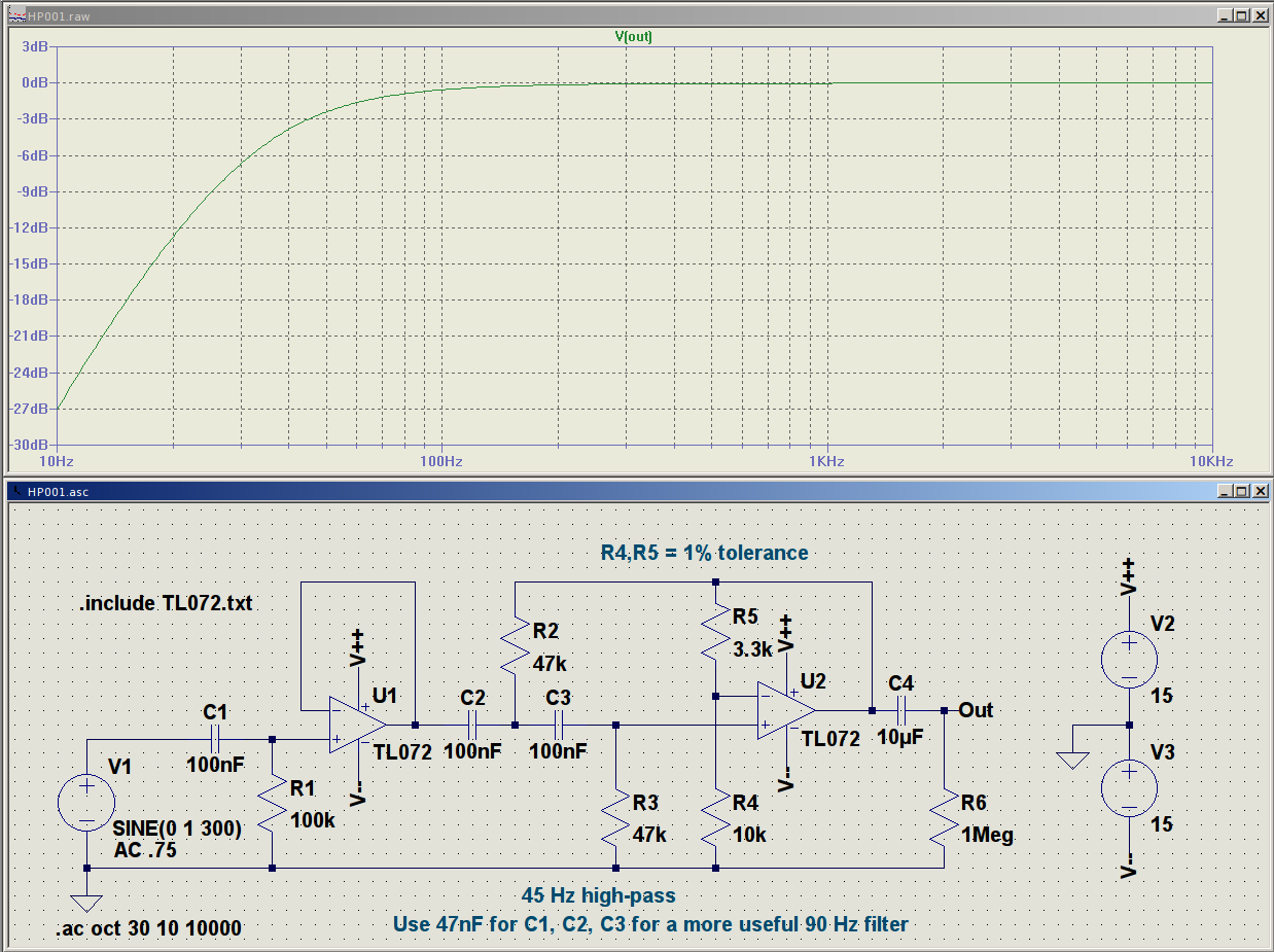

I designed one for you. Schematic and LTSpice simulation attached.Can someone point me to the best way to figure out component values for a high pass crossover with a cutoff of 45Hz or so?
No guarantees on whether this will save your 5" driver's bacon, though. I am doubtful that a 45 Hz high-pass will help the tiny speaker adequately.
If you halve the values of C1,C2,C3 (use 47 nF, i.e. 0.047 uF), this will be a probably more useful 90 Hz high-pass filter. By "more useful", I mean "More likely to save the little speaker's bacon." 🙂

A custom-designed high pass filter may provide steeper bass roll-off and a more well-defined EQ curve than you can get just from the EQ pedal. But building your own is certainly a little bit of a pain in the rump.
Also, if you find out that 45 Hz is not sufficient filtering, the graphic EQ pedal is quicker to adapt to the new reality - all you have to do is turn down the 120 Hz slider as well as the 50 Hz one. If you use my circuit, or something similar, you have to desolder and remove the three 100 nF (=0.1 uF) caps, and replace them with 47 nF (=0.047uF) caps. And then you have a 90 Hz high-pass, which may or may not turn out to do what you want it to do.
IMO it's not a bad idea to use a bass graphic EQ pedal to experimentally determine exactly what frequency response is necessary to avoid killing the little 5" speaker. Having determined that, then go ahead and design the custom filter, knowing that it will do what you actually need it to do. However, that Behringer pedal doesn't give you a lot of options down at the low frequency end - you can only choose between 50 Hz, 120 Hz, and 400 Hz centre frequencies.
