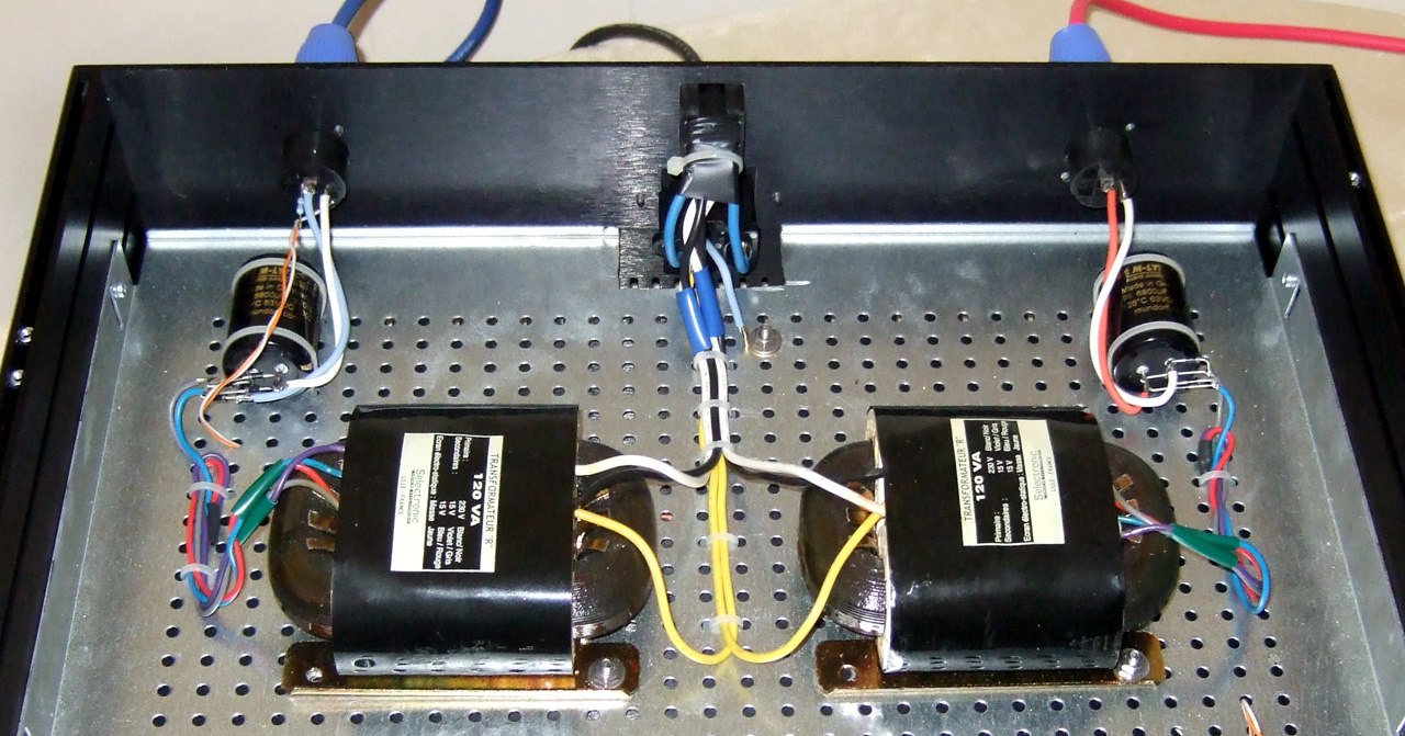

Received today Selectronic answer:
White : Hot
Black : Neutral
but with R-Core it is't very important
Thanks Merlin. Nice that I got it that way... Last thing I would like to do with 41C now in Athens would be to rewire such stuff.
Mine are also 220V primary, It were wired for double voltage secondaries.

Yes, my three Selectronic (France) Rcores are all clearly embossed "SHILCHAR"........................
Below link to manufacturer of R-cores sold by Selectronic.
Shilchar Technologies Ltd.
But the big one has no labelling to indicate wiring codes, nor voltage/current/VA ratings.
All of them have misleading colour codes on the wiring.
The two halves are out of phase with respect to the other half.
