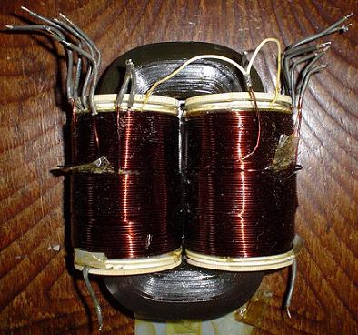

Bottom left wire is the Black, bottom right is the White primary connection.
Now which is which ? :clown:
hmm haha the thing is symmetrical there is beginning and end on this or not? but going by my reading, if thats the right way up the right wire would indeed be the beginning wouldnt it?. it would be quite an achievement to make an RCORE that didnt pass isolation standards, the windings are completely separate.
the grain is symmetrical too yes?
if you flip it over its axis, it looks exactly the same in the other direction
Not seems a Shilchar R-Core sold by Selectronic
It's the 500VA/2x24Vac model, has 4 windings per secondary.

2x24V 500VA Selectronic attached pic shows total only 7 cables (primary: hot, neutral, screen, 3 cables) (secondary: 0-24 & 0-24, 4 cables)

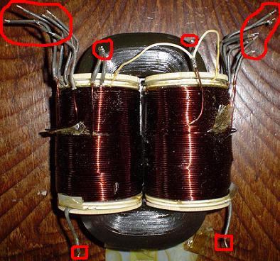

The grey wires on the top left and top right are the wires of the secondaries.
8 grey ends left, 8 grey wire ends on the right.
Each secondary on a bobbin is made up from 4 parallel windings, one on top of the other.
The wires for the secondaries can be thinner that way, which is easier to wind, and tighter.
For a perfect R-core, one bobbin should be exactly the same as the other one.
The two yellow wire ends between the grey ones on the top are the ends of the primary windings, meeting point is the ground.
So bottom left and right : Black & White
Top middle : Yellow
Top left ;
4 on the left :Grey
4 on the right :Red
Top right ;
4 on the right : Purple
4 on the left : Blue
Under the brown paper layer around the bobbins is a square piece of plastic with solder pads.
The colored external wires are soldered there, together with the ends of the windings.
