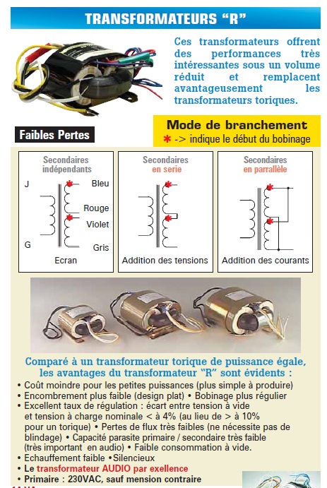

Anyway, just for the sake of knowledge here you have the original selectronic info.
Hi Salas, based on the drawings I connected Rouge + Violet to get 30Vout from a double 15v TX.
I followed Kevin suggestion and followed US colour markings for primary connections.

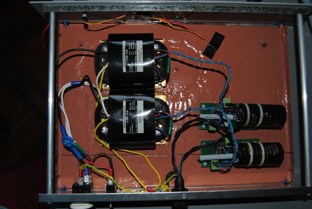

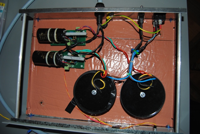

My r-cores have exactly the same label as yours, but the copy from selectronic manual states it differently.... Anyway, I just replaced the two nuvotem toroids by the two R-Cores in my personal simplistic build and I can confirm the differences are audible.
There is a wider soundstage and better diferentiation in the bass lines.... much better 🙂
Absolutely agree about the soundstage. Also love the general quietness of the background. Otoh, bass seems a bit lighter in weight and the general sound presentation gentler and calmer than similarly sized toroids.

Just for completeness here you have before and after:
The difference in soundstage is now amazing....bass is much better diferentiated and there is a sense of ease to the presentation not heard before.... (No placebo Merlin)

Received today Selectronic answer:
White : Hot
Black : Neutral
but with R-Core it is't very important
