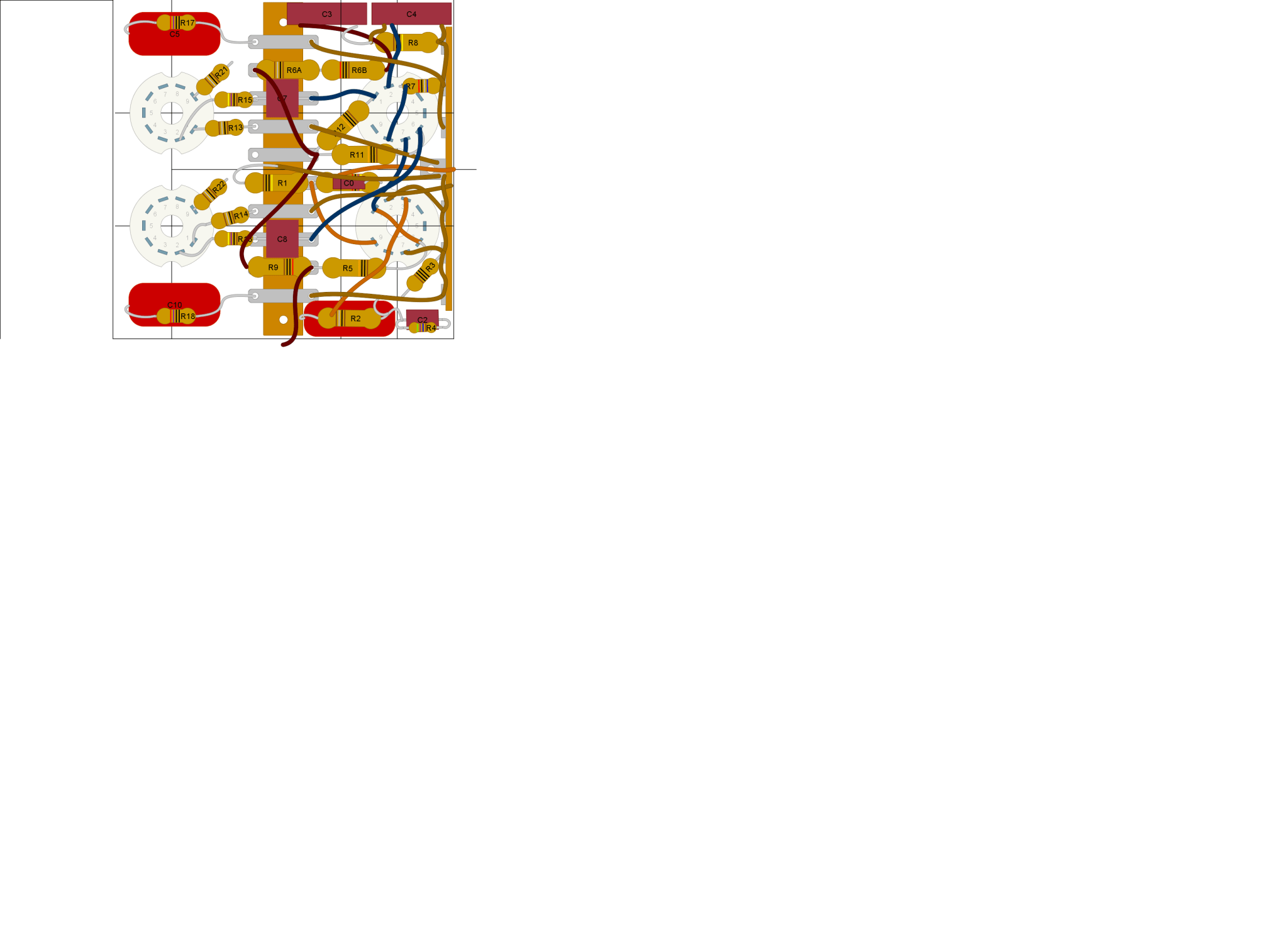

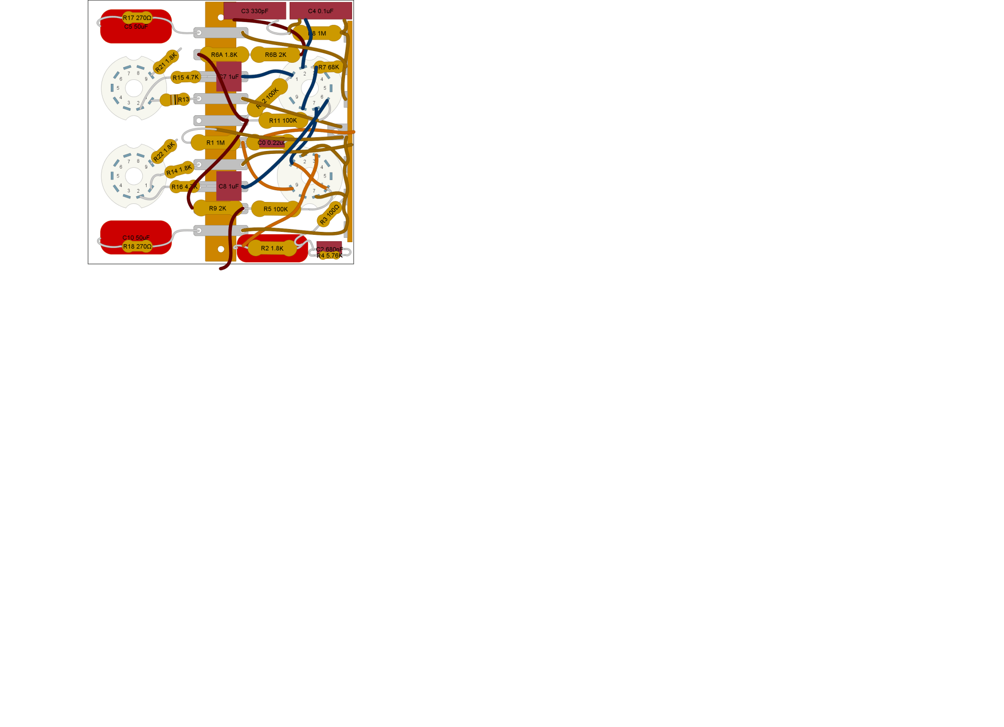

Almost there, got the revised layout done not that long ago, welcome to critique it and get this moving along. Once the layout is sorted, then order parts and move to the next steps.

Your DiyLC layout above looks neat. I do think you should label the pins on the valve bases so you know which pin is what, that makes it more meaningful to other people when they look at it. If you do not care about that, and you know what you did in 6 months time, then I suppose it makes no difference. You could also use the 'both' option for naming components so that the component number and value are both displayed. That also makes it easier to sanity check.
I was certain DiyLC has tag board, so I was quite surprised that is does not exist! There are other options, for example two tag strips with the same number of tags in parallel, or get creative with the different board options and spacing of solder pads. I would probably use the Eyelet Board, and fix the spacing to be the same for adjacent tags. As long as the basic spacing is aligned with real tag board then you can focus on the layout without any worries.

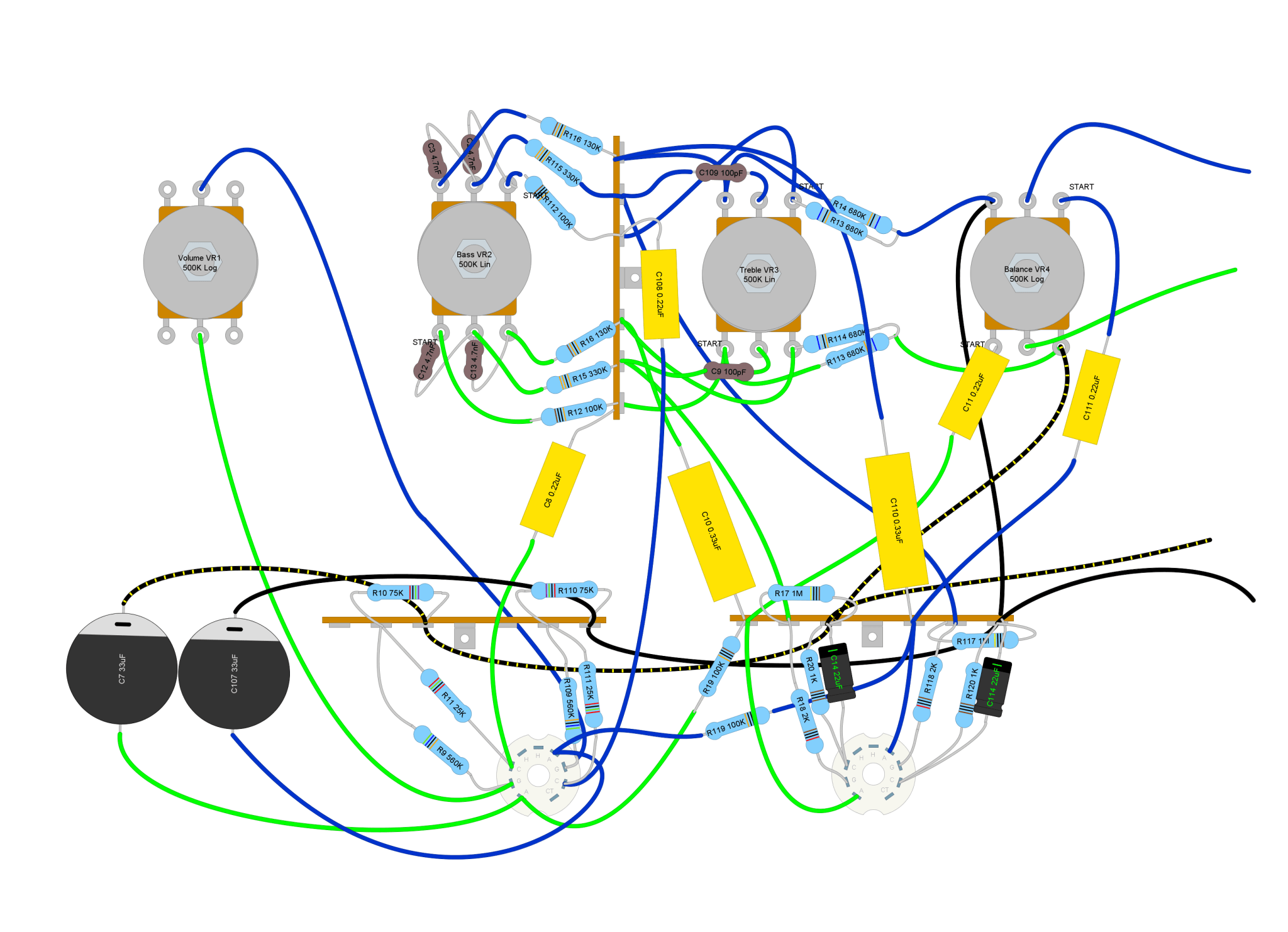

Apropos nothing, here is the layout I am working on. It is a Baxendall tone stack with volume and balance controls for an old stereo amp I am trying to breath life back into, but us starting to feel like a project too far. I have spread out the parts a bit to make it easier to do the layout. As mentioned above those bendy leads are a real pain in the derrière!

It didn't cross my mind we are the only ones using DiyLC or that wouldn't be obvious it was a layout sketch, good to know though maybe too late. Not sure how to resolve, other than start a new thread for each topic.
Thank you. 🙂
Okay, will see if can darken the text. Also need to do a .gif again, in a hurry last night.
Nifty. 🙂
You know you can copy and paste colors to make bent leads on condensers and resistors? I did on mine for clarity, though seems yours was only for your eyes.

By the way Adriel, just checking to make sure you are aware that tag strips are typically mounted on standoffs, not free floating?
Thank you! 😀
I was not aware until looking at the parts , thought like tag strips that mounted to the chassis. I have gotten myself confused on the mounting, think best leave alone, position is close for any of the options, more importantly parts are selected that fit and where fit best (starting with heat output), while avoiding the heater wiring.

Looks like C7, C8 may still be shorted in the wiring diagram?
Ah, yes, of course, signal jumping over, oops; what I get for copying and pasting. Well then, only bend one leg rather then both (they are legs and not leads), the original leg pointing down becomes the one soldered to the tang and the other bent out to connect to the resistor. Might need to create a little block for the caps to rest on so the resistor is not drooping onto the tang.

Please annotate the tube pins (when you choose the socket you can choose the tube type so you don't need to do this yourself), add the values to the components (use the 'both' option for name) and post the circuit you are planning to build.
Yes, I clearly forgot to change the color of the sockets.
I removed the banding in hopes make the text more visible, also the ones I selected don't have banding.
