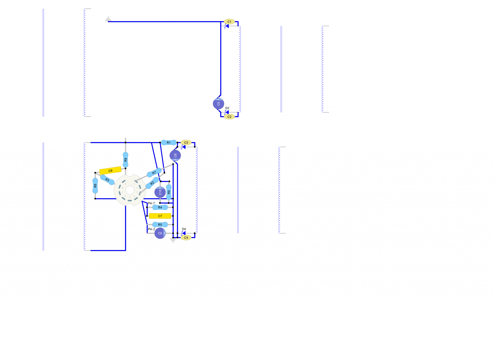

DIYLC comes with octal and noval tubes bases and you can label the pins. Just lable the pins for the tubes that you are using (for instance a, k, g, h, h, a1, k1, g1 for a dual triode) then use that to get the placement correct.
I saw that though wasn't sure be an advantage. Now it is very obvious as then allows for installing a ECL86 with its one Noval base. Here is the pinout so on the same page.

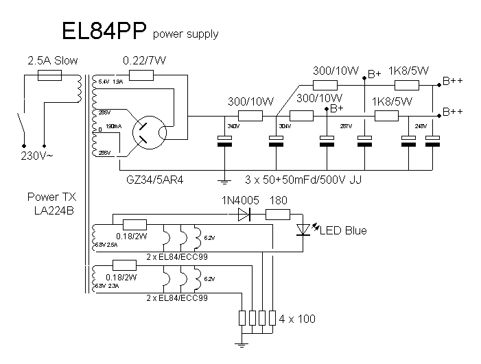

You have two schematics. In one the output tubes' power supply (V1) is 310V, in the other 325V.
Mine on the computer has both at 310. I looked at yours and only saw 325V.
That is the reason you get bigger dissipation on the one with V1 at 325V.
I know this, look at one of my early posts where concerned about the L1's 325 supply voltage, knowing the EL84 is rated to 300V. Also, just the other day said when I increased the B+ I would check the plate dissipation. Why would I do this if didn't know this? 🤔 Neurotypicals are interesting is all I am observing. Maybe this is a reminder? 🤔
I recall changing both B+ and B++ voltages for distortion, see no reason to run higher if going to be no benefit, worse, if going to damage tubes. As I understand, the ECC81 and ECC83 should not have more than 250V; I forget the EF86 though seems in this schematic to be the least affected by voltage.
Edit. Add that I am amused it is plate dissipation that is the concern, I thought really hear it regarding having two supply voltages.

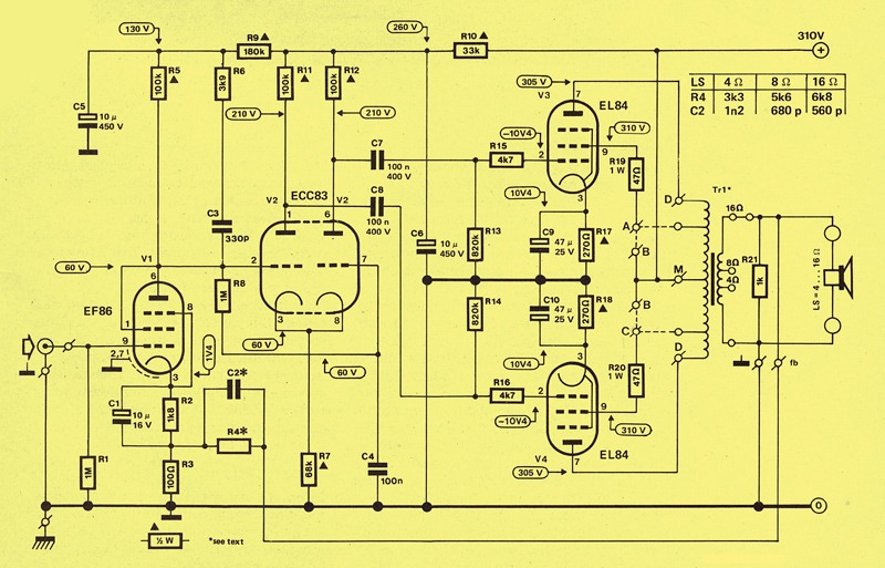

"Selecting capacitors " It is very important that some of these capacitors are of a certain type. Some of the capacitors the OP asked about, like the input low pass filter and the filters around the stages, should almost certainly be ceramic "high Q" capacitors. Their high frequency characteristics are vital to the correct performance of the circuit.
People talk about the nonlinearity of the capacitors etc but in these applications that is not the important parameter. If anyone tries to replace some of these capacitors with some kind of "audiophile" capacitors, there will likely be some noticeable nonlinearities. Cyril Bateman (and others) published an article about capacitor choices for circuits many years ago.
The schematic shows a typical "ultralinear" amplifier, quite nice.
Which one, this one?
High "Q" capacitors are high resonance, low inductance capacitors. Old tube equipment is filled with them. They are used for their high frequency characteristics. There is nothing to be gained by replacing them with "audio grade" capacitors - and possibly something to be lost; stability could be affected.
The coupling capacitors could possibly be replaced by "audio grade" capacitors. I wouldn't alter their value though. The low frequency pole is required for stability. Unlike modern amplifiers, transformer coupled amplifiers have both high frequency and low frequency poles to deal with in the feedback loop.

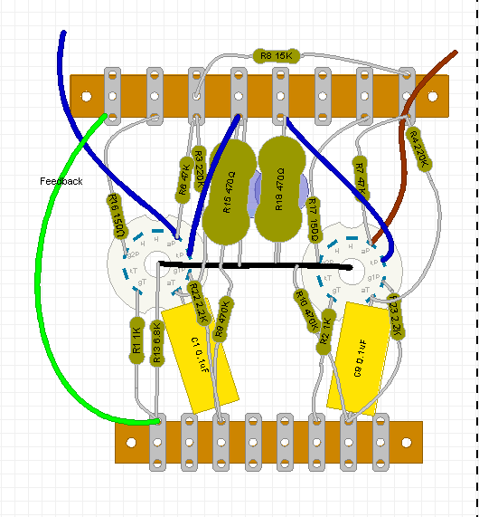

Hi Adriel, I think you are missing the point of DiyLC. It is to determine the layout, so use a 9 pin tube base on the drawing, label the pins, and work out how the grid will be connected from the tagboard, for example. You can route the heater wiring, and look at the best orientation of the bigger components. Tubes radiate more in certain directions, so once you have optimised the heater wiring, you can look st the plated on your tubes and have them pointing away from heat sensitive components.
I do in fact understand the purpose of DIYLC, rather, the interface is terribly lacking when compared to the professional drafting programs I already know. However, this is not required and require research to find all the dimensions, build components, all before laying out. Another way to say this is it is SketchUp, which is only good for sketching, versus ArchiCAD that is a true BIM program and draft assemblies showing all components, rather than just a thick plane. Maybe not the analogy, maybe substitute AutoCAD which is also professional, though takes extra steps to create a 3D model (few of us are left who know how to, replaced by the lackluster Revit (sp?)). ArchiCAD will always be the best structure's drafting and modeling program, the first of BIM.
As for tagboard, you prefer over running wire?
In this example, the warmest be facing pins six and nine, with the coolest facing pin one or facing three and eight, correct?

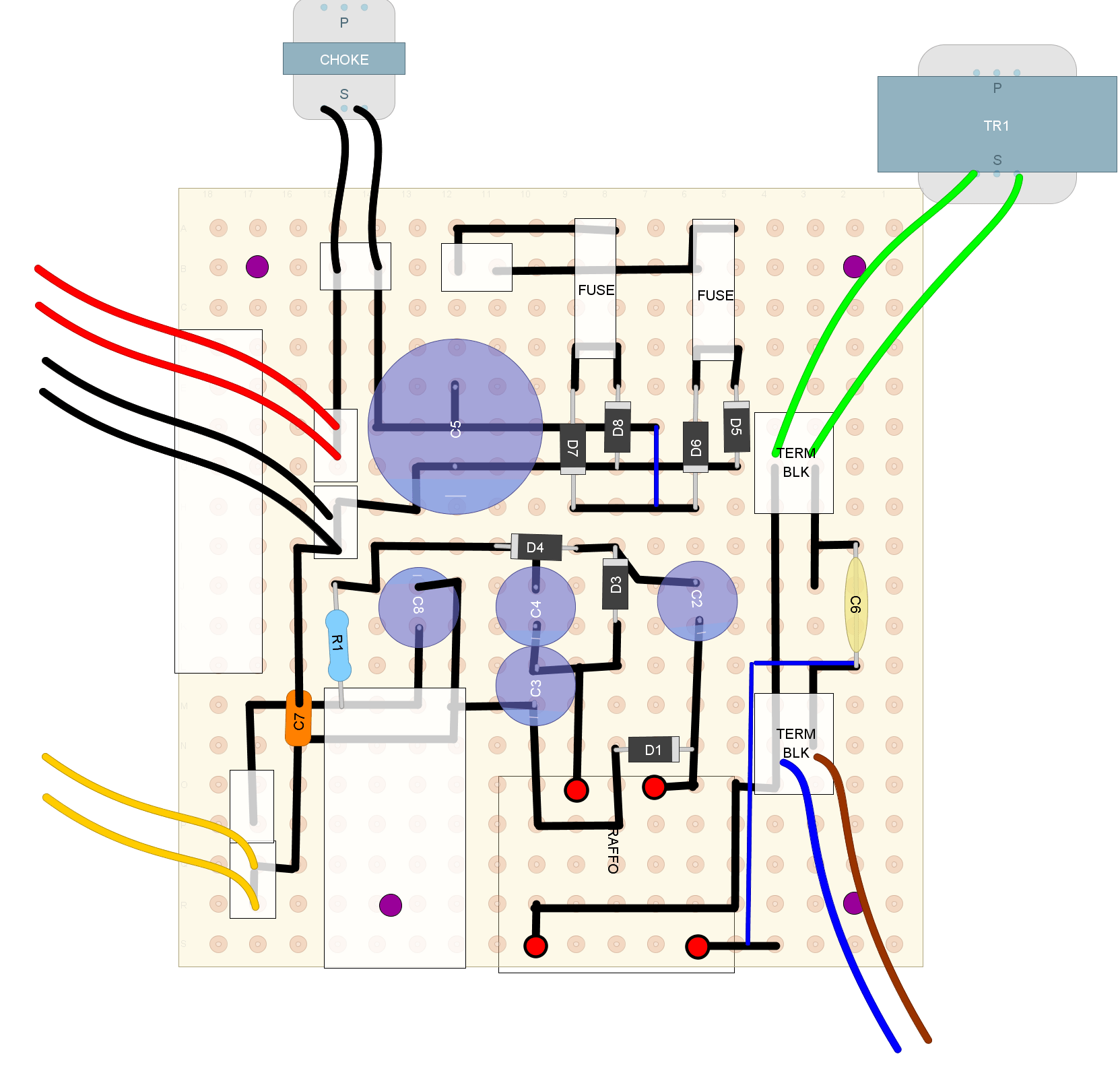

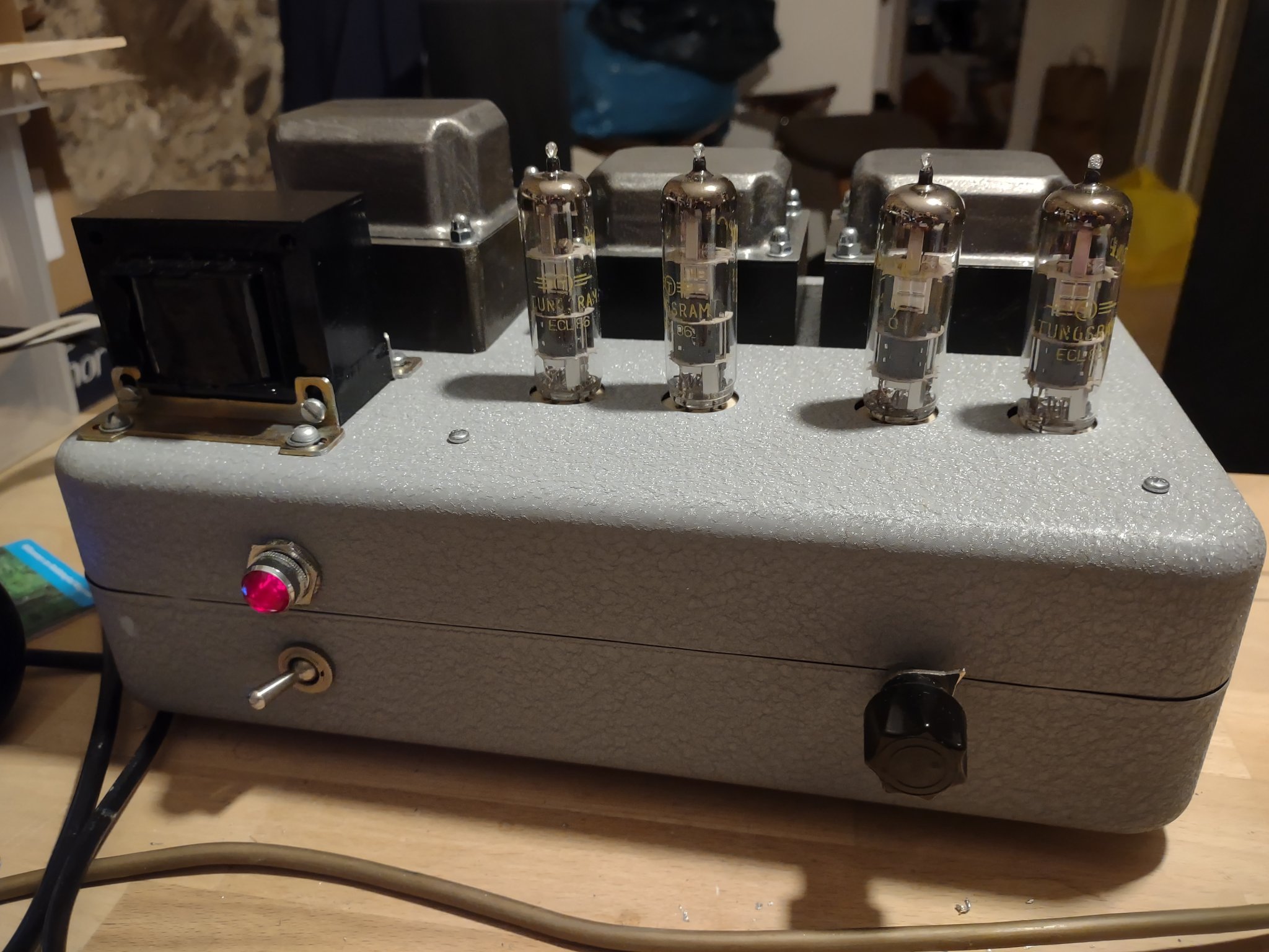

This is some layouts I did for my last project, the original Dissident Audio Baby Huey.
It was meant to be a compact build, and that was the main challenge. The transformers could not be mounted on the top plate and had to drop through, so a lot of my planned space disappeared.

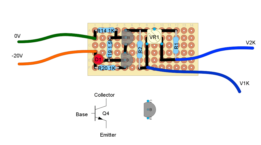

The power supply, with seperate supply for the negative rail ...PSU Final_B.png
Packing the the components for one channel of the amplifier ...Screenshot 2023-03-04 120432.png

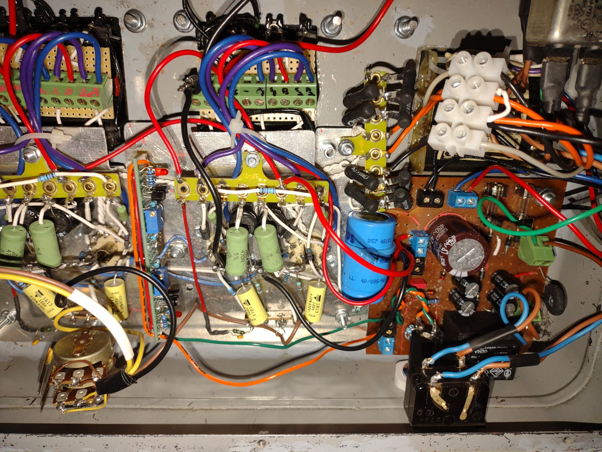

There were a lot of constraints that were not planned at the start, so it took a lot of iterations and a few months to complete. That is why I recommend getting started with a PCB build, like the Tubelab SPP, by reasonable parts, and cut your teeth.
I am sorry, rarely understand hints. So is the layout shown satisfactory?
Why?
I was looking for a rail and couldn't find one. Maybe I am totally missing it...
As built ...
Neat, thank you for sharing. 🙂
