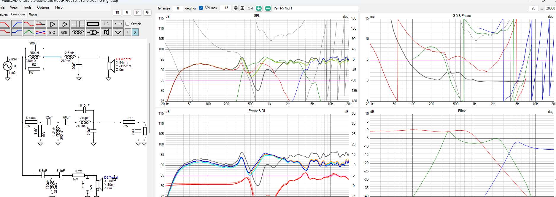

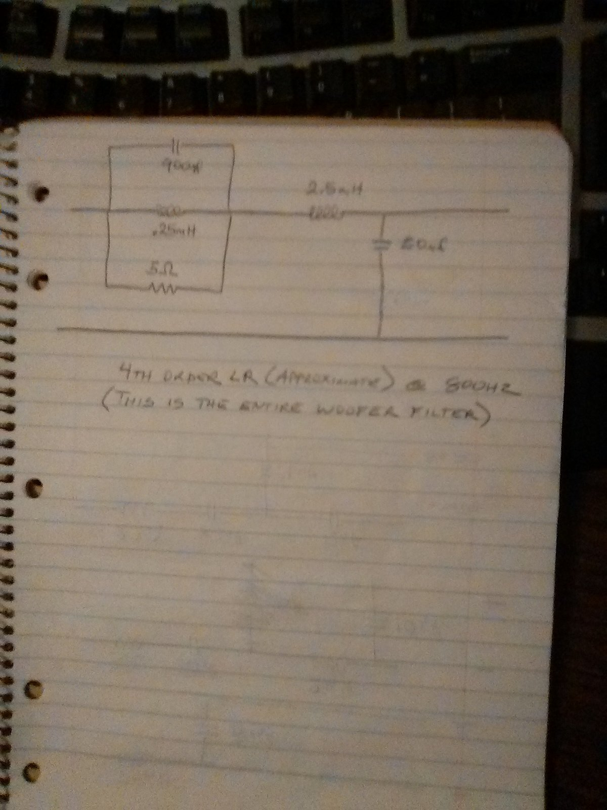

The filter I suggested will work, according to my sim. It has 5 parts, not the 8 or more you show in your sim. That sim does not work. Notch filters can be weird. This one needs to be in front of the rest of the filter.
Try this in your sim on the woofer only, with nothing else on the woofer, and see if it works . If I used Xsim, I'd show you myself. The PCD sim I posted shows that it works.
On the down side, you probably don't have room for the big caps anyway.
This is what should show on the woofer filter. No additional parts needed. The roll-off might not be what you want, but the spike in response is gone.
Also.... I do not know what power rating might be needed on the resistor. It might get very hot. I think your software can predict that information. I've never used a filter like this, but if I did, I'd be checking the resistor to see if it heats up frequently.
I tried it again. Similar result.
What sim software are you using? I am totally aware that VituixCAD is not the perfect sim software

I don't know why it doesn't work in your software. It does look like you connected it right in post #41 above . Why is the line blue right after the notch? Does a blue line mean something different than if it was a black line? I won't continue saying the notch works. You can try PCD if you like.
Edit. Here's the reason maybe. You have virtually a dead short in the padding to your mid in the above schematic. You need to change that even without a notch.
Here's a link to the software.
http://audio.claub.net/software/jbabgy/PCD.html
The mid padding is not the problem. I shorted the mid in my sim, and nothing changed with the notch.
I am relying on a sim. If I didn't have the software, I would not have tried anything similar.

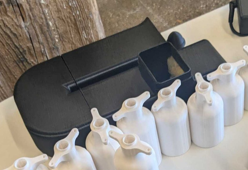

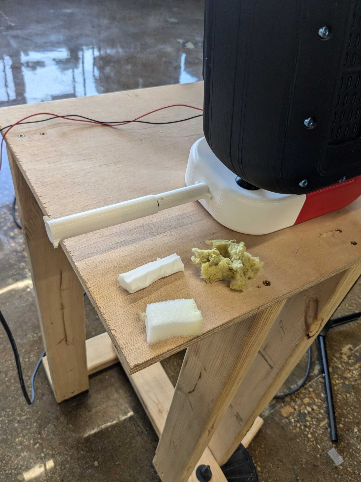

Ok, so I tried this out. I found the length that put me right on the money for hitting the peak. I then filled it with various material, only about 1/3 of it.
Filling it with any material at all makes it not work. I tired rock wool, magic eraser, and melamine foam.
What am I doing wrong here?

Is the absorber tube closed at the exterior end? (it has to be!)
Yes, it is.
Edit: I also noticed that below a diameter of 2.5 cm (1") the absorber did not work.
Well I guess I need to make it much bigger then. The one I made was only 15mm in diameter. 1 inch is wayyyyy bigger.
Filling broadens the absorption peak. If you don't need that it might just be ok to leave the tube empty!
So far, in my research, I have found that filling any of these devices either lowers their working frequency (I assume by making the volume effectively larger) or make it entirely useless where it has zero effect. I will try a much large opening and see how that goes.

I tried several notches laid out as I suggested. Not even one worked! The software is actually pretty useful, but this must be a flaw in it. It may work for broad notches, but not for the tiny width notch I was shooting for here. Sorry it didn't work.
If its any consolation, I have never once been able to successfully implement a narrow bandwidth notch filter.
I swear they are a dark magic that requires selling a portion of one's own soul to master

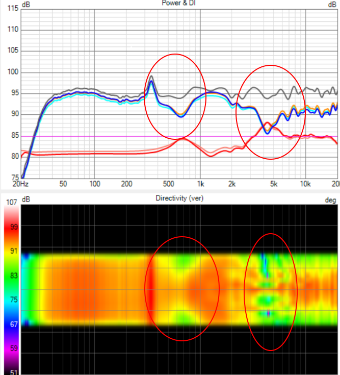

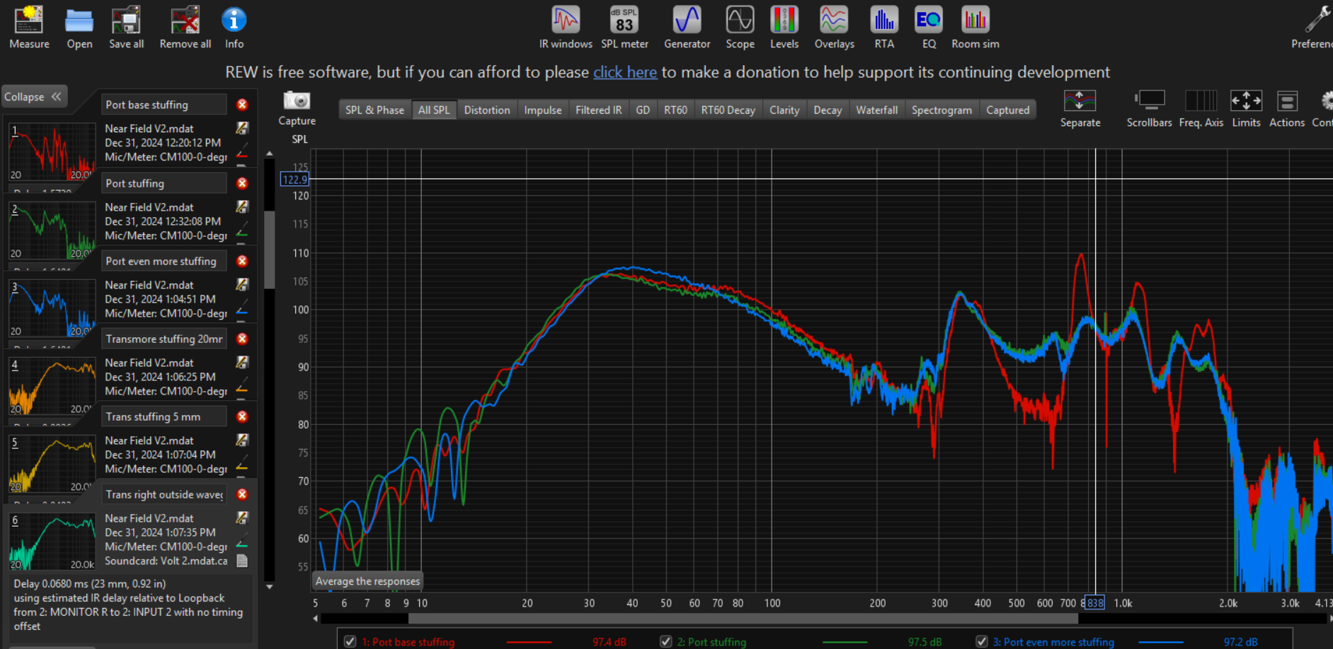

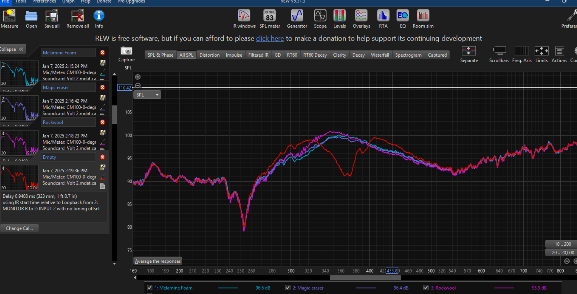

I suppose I never shared this date but it is peritinent to the current discussion.
This is empty vs half stuffed vs stuffed with as much rockwool and poly as I could fit into the shell.
As you can see, it smooths out the upper range output of the port but it does absolutely nothing to my 340 hz problem child.

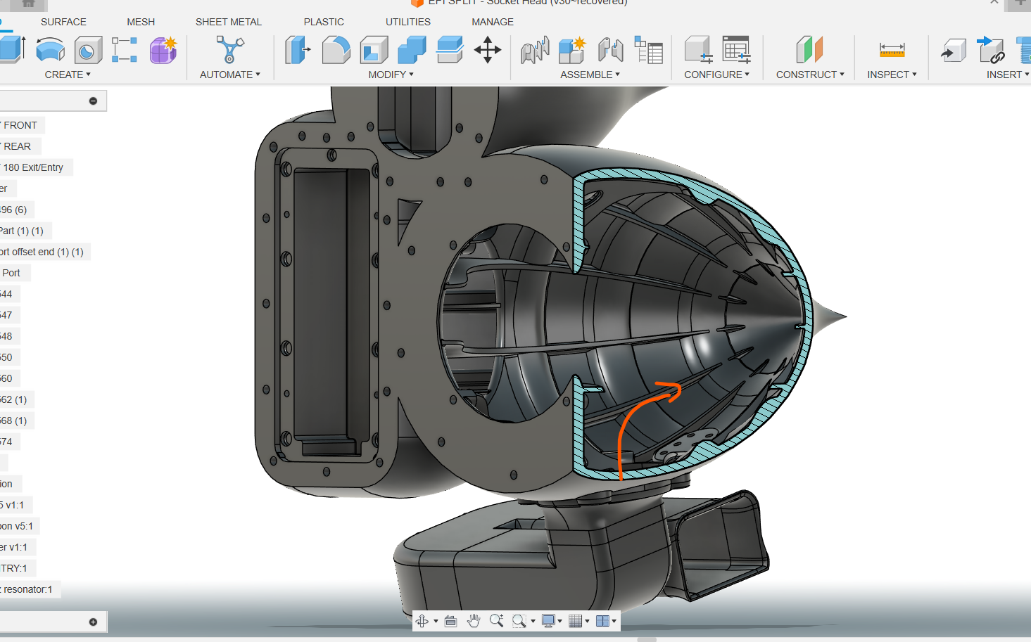

Can you add an elbow inside that would move the port end even a few inches. It would add length.
Technically I can add/subtract anything I want.
Are you talking about an elbow here so that the wave off the back of the driver doesn't go directly into the port?
If so, yes, I have thought of this. Even a plate would work too. Only issue I have with moving any part of the port inside is that it technically takes up enclosure space. Very precious and calculated enclosure space. I could probably print a prototype to fit in there without having to reprint the whole thing. Just to try it out.

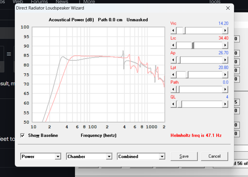

Playing with Hornresp I don't see exactly what I saw before but this is response. Its clearly way off on the low end. I do notice that it brings those nasty resonances forward if I move the LTC (rear chamber distance) further out.
Currently the back of the enclosure is about 30 cm back. I wonder if it is actually the circular shape causing that big resonance. It is possible
Anyone with some horn resp experience want to take a look?

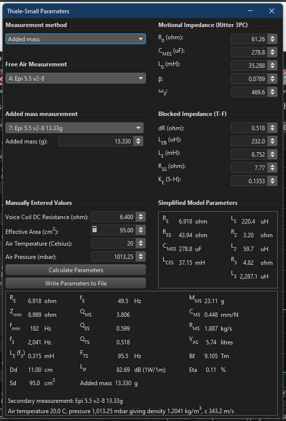

enclosure is currently 10.7 liters, port is 26 cm2, 18 cm long. I'll post the TS parameters. SD is 95cm2
