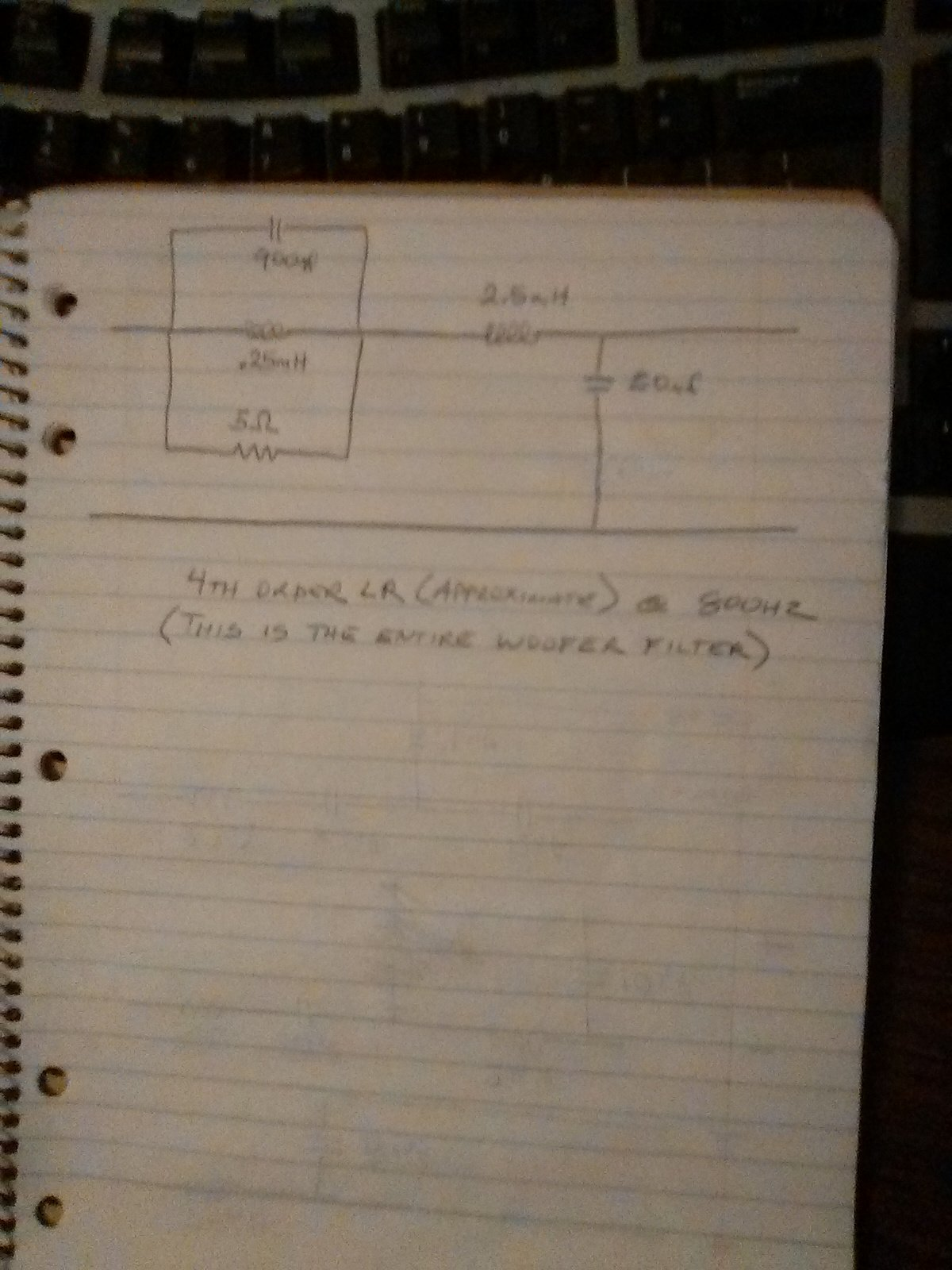

Still doesn't work quite right. Are you suggesting this to replace the entirely of the current filter? The impedence of the driver will throw off the values considerablyI don't see it in the above post. This is what I'm suggesting.

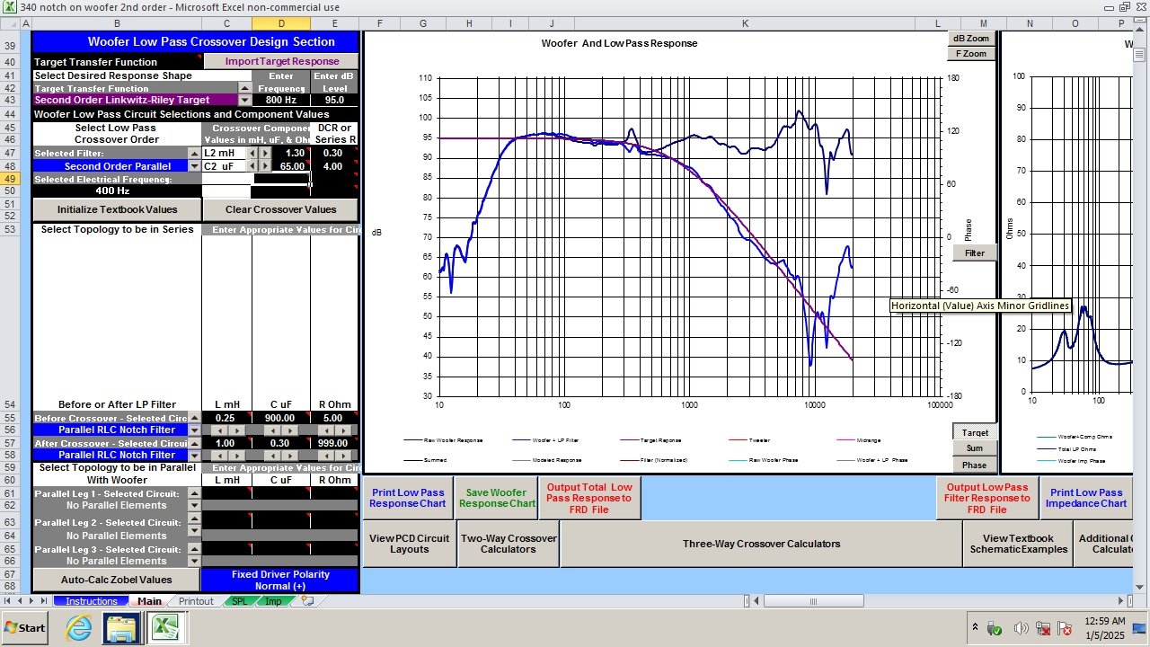

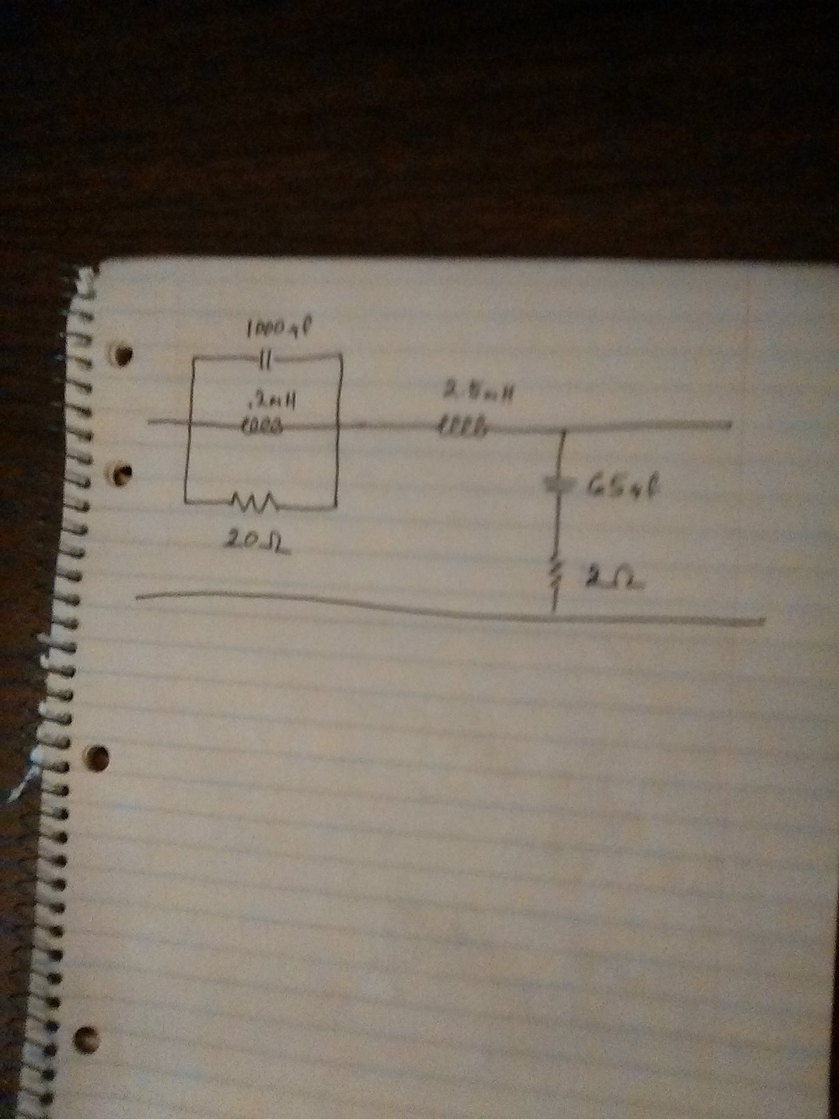

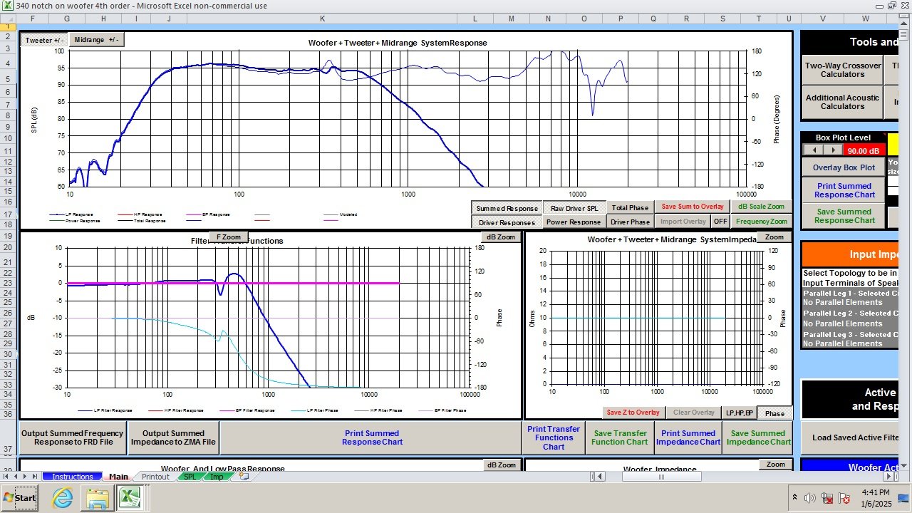

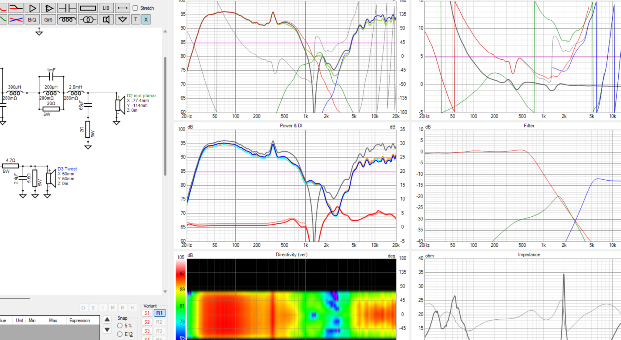

This is a sim using your woofers files. I only worked with the woofer. This filter is the entire woofer filter, and not to be added to other woofer filter parts.
Here's the response. I was shooting for 4th order. I can adjust for a 2nd order if needed. The notch portion is likely almost the same. The notch portion is the three parts on the left side in my hand drawn sketch.

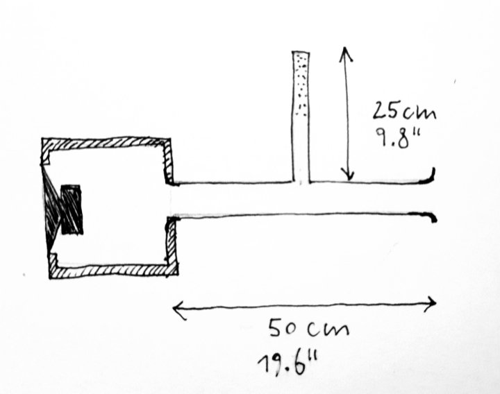

Length is exactly half of the port length.Is there a calculator to figure out the length and the cross section?
The port has two open ends and is a half-wavelength resonator. The absorber has the exterior end clised and is a quarter wavelength resonator/absorber.
Diameter that worked for me was about 2-3 cm, at a length of 11 and 5.5 cm.

Maybe its been a long day but I am not visualizing what you are saying here. Do you have a picture? The only picture I saw in the thread was the menagerie of tubes when you were doing the syringe testing. I'm a visual person so pictures help me a lot.Length is exactly half of the port length.
Port length is just my guess, based on the 340 Hz peak. The absorber tube should have half the port length.
Of course the tube does not have to protrude at 90 degrees from the port, as shown here. But it needs to be located at the middle of the port length for good effectivity.
Totally get it now. That makes sense. I will try this out and let you know how it goes.Port length is just my guess, based on the 340 Hz peak. The absorber tube should have half the port length.

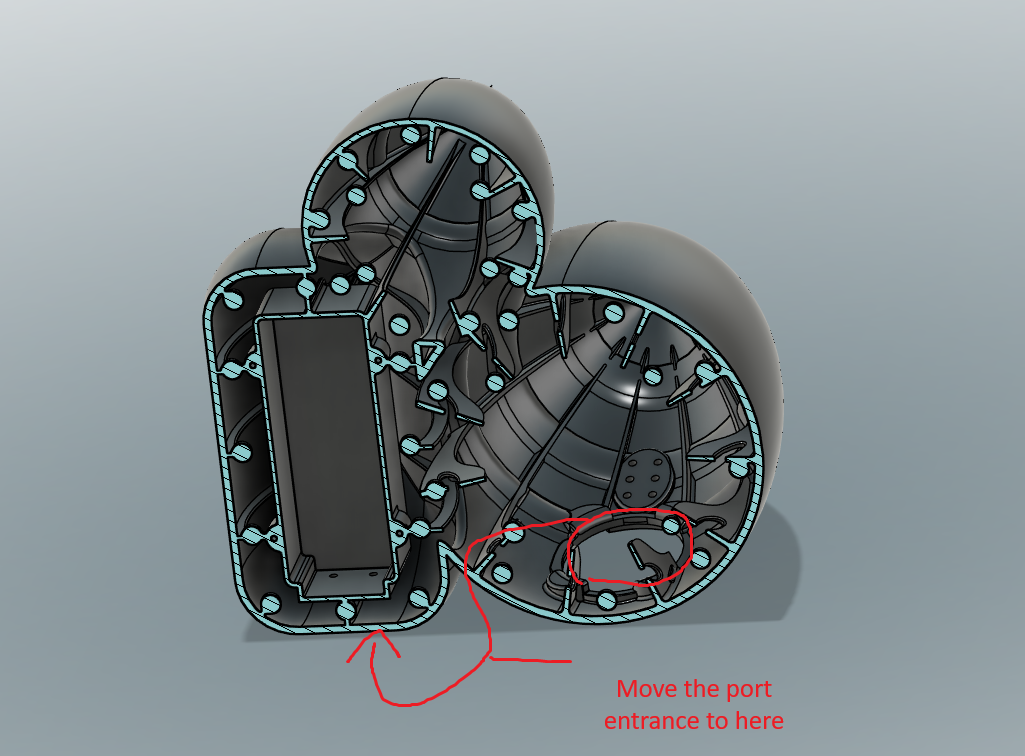

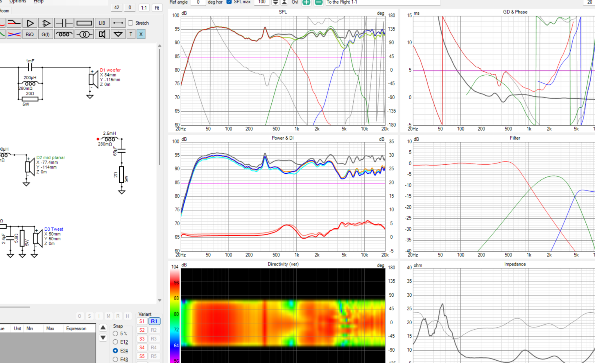

Do you think moving the port entrance to the other side of the enclosure would help? Is this a standing wave or definitely a result of the port geometry? I figure you're the best one to ask
I doubt that.Do you think moving the port entrance to the other side of the enclosure would help?
It's most likely the port - unless your port length is very different than I estimated.Is this a standing wave or definitely a result of the port geometry?

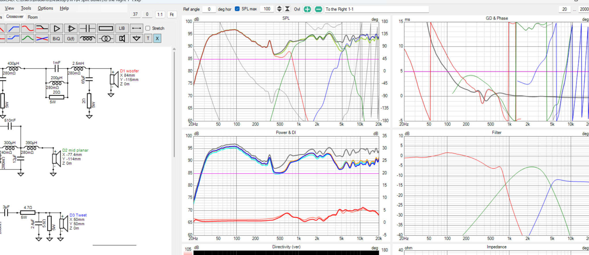

Did you try to simulate the enclosure in hornresp? Hornresp models the port resonances very accurately.
I did. It shows the hump almost exactly as it appears in real life.Did you try to simulate the enclosure in hornresp? Hornresp models the port resonances very accurately.
I was just hoping there was a chance I could just move it and all would be fine......... even though the logical part of my brain knows it's a facet of the design.

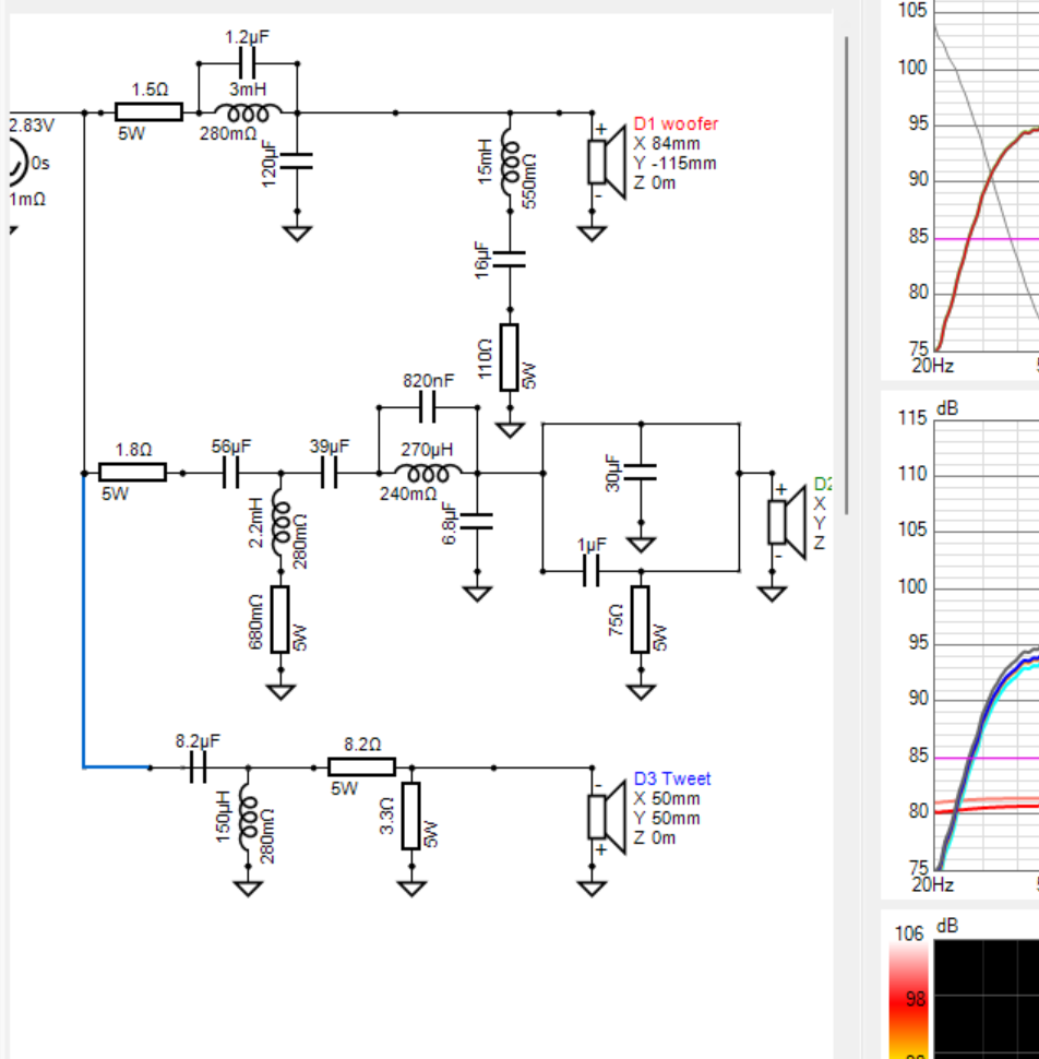

Yes, I did. I tried it, it did not workDid you even look at the notch filter I posted? It totally eliminates the peak.

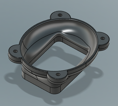

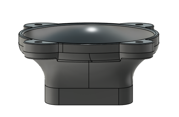

In this case you could reprint with a more flared port and by doing so reduce the port length and eventually push the port resonance out of the woofer pass band.The whole enclosure needs to get reprinted.
Let me know if that seems viable for you. I could use your enclosure as an example for SPL related dimensioning of an "ideal" port.
The filter I suggested will work, according to my sim. It has 5 parts, not the 8 or more you show in your sim. That sim does not work. Notch filters can be weird. This one needs to be in front of the rest of the filter.
Try this in your sim on the woofer only, with nothing else on the woofer, and see if it works . If I used Xsim, I'd show you myself. The PCD sim I posted shows that it works.
On the down side, you probably don't have room for the big caps anyway.

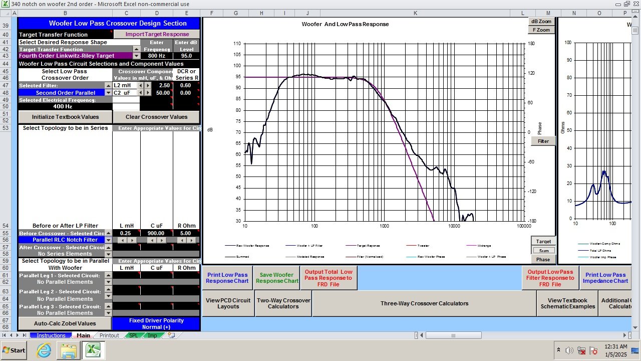

This is what should show on the woofer filter. No additional parts needed. The roll-off might not be what you want, but the spike in response is gone.
Also.... I do not know what power rating might be needed on the resistor. It might get very hot. I think your software can predict that information. I've never used a filter like this, but if I did, I'd be checking the resistor to see if it heats up frequently.
The figures a bit fuzzy for my eyes to read... impedance 10ohm at 330hz?
@temp25 May I suggest 45uF || 5mH || 10R. A notch around 330hz should indeed multiply uF*mH~225 (because frequency~5khz/sqrt(uF*mH) see below math) but the filter values 900*0.25 would run past each other.

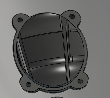

I can try to clean this up a bit. How much more of a flare would I need do you think?In this case you could reprint with a more flared port and by doing so reduce the port length and eventually push the port resonance out of the woofer pass band.
Are the resonances mainly based on port length? I could try shortening the port. I don't really need it to hit to 30 hz but figured "why not" when the driver will happily do it.
I will post picture of the flare I have. Its not so easy to design this since they need to be printable and they need to mate up as two pieces. I also have the design constraint of it needing to fit underneath my overhead monitors.

Try and see what happens to it if you add the rest of the filter though. The components have effects on one another.Here's the results of MY sim. It doesn't get much better than this.
