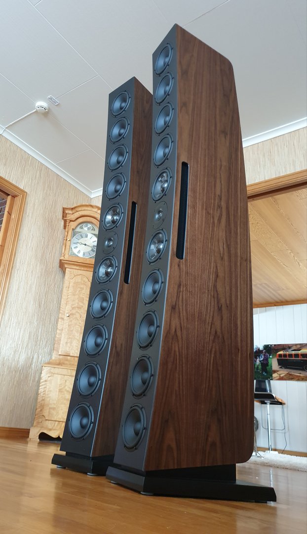

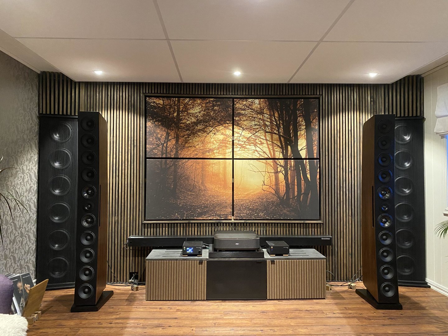

Any chance Mr Overn would share his T34B cone design, and of course, how well did it work?Those are built by mr Øyvind Overn. I designed the xo for them, and also made a calibration at the owners home. They sound really great. The panels on the right side are removed. They live at Gilja, just outside Stavanger.

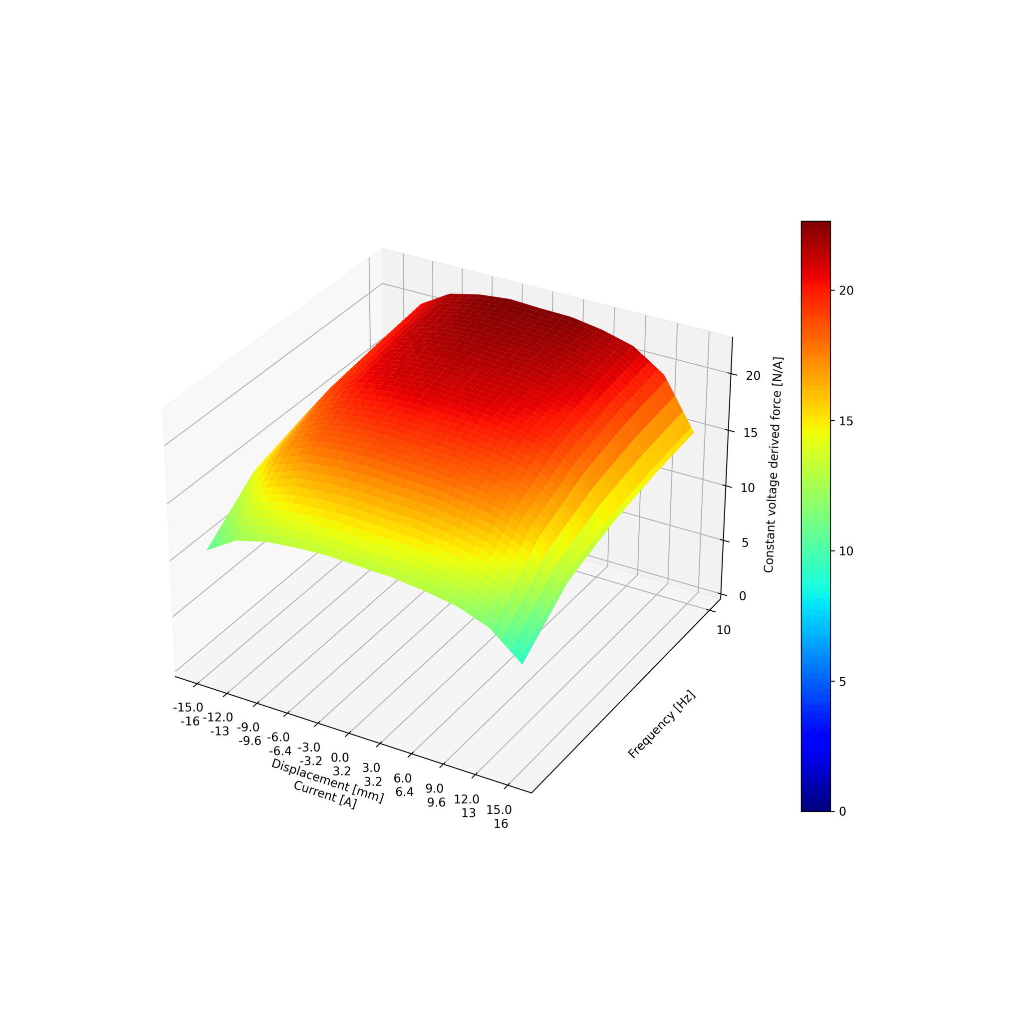

That's a really nice way 👍After all this time, I finally got to make a simulation showing Force factor, current, position and frequency in the same diagram. I am going to develop it further with DC offset, but this is what I have at this point:
PS: THIS IS JUST FOR ILLUSTRATION, IT DOES NOT SHOW ANY OF THE DRIVERS IN THIS THREAD!
Freq axis is a bit strange atm, but I understand it's preliminary.
I have actually been working on some ways to measure these at home on an affordable way!
You mean the waveguide? I think it was designed and 3D printed by someone else. I am not sure who.

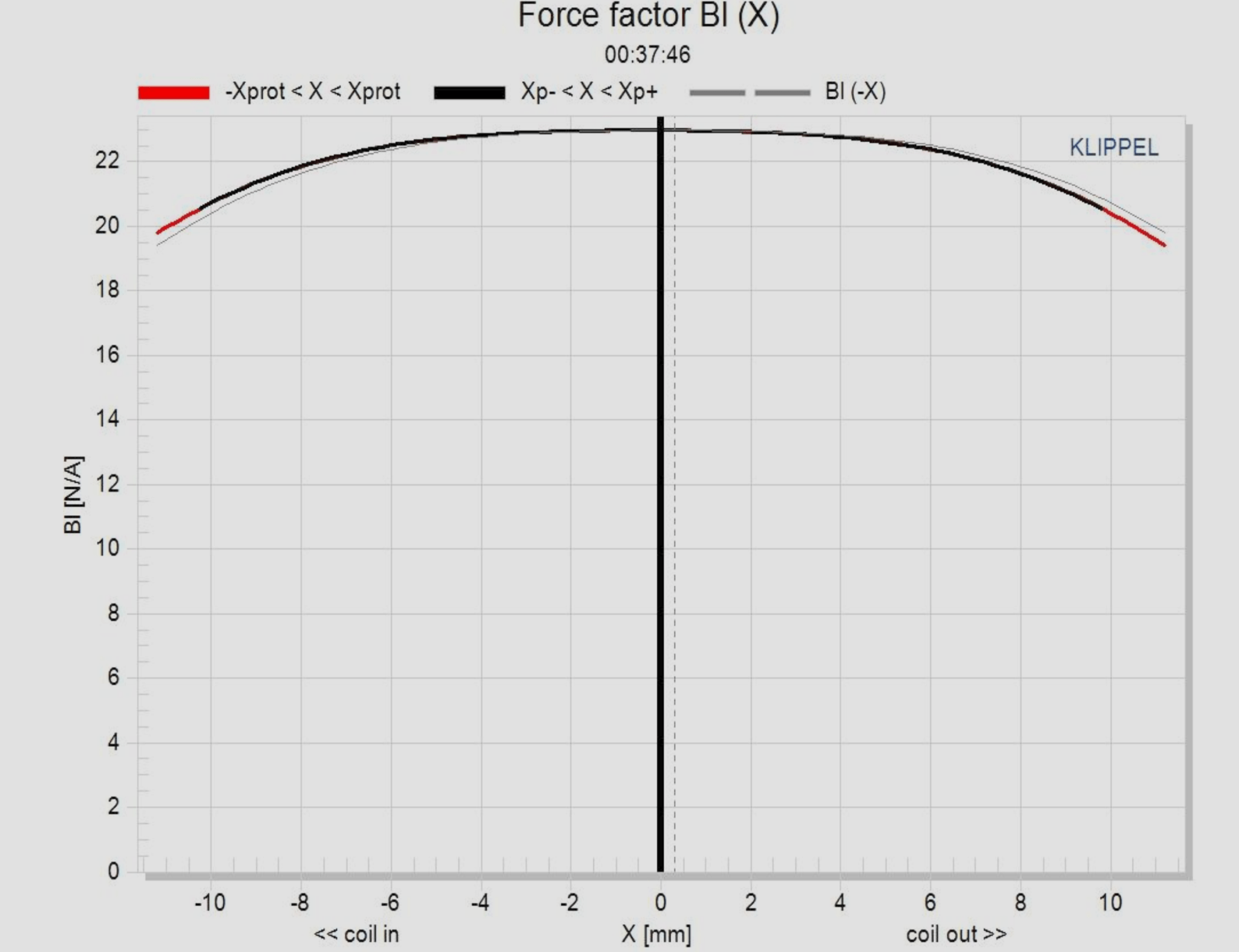

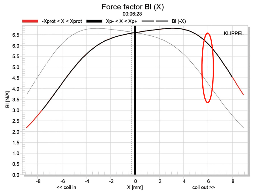

Your question about why MW19 is better than MW16 is kind of easy IMO-- while they share the same "flaws" in BL(x) curve, MW19 has longer linear throw, thus performs better.For @Boden @Snickers-is and @b_force -
From hificompass measurements, he describes MW16TX IMD at -18dB as high, but MW19TX IMD at -25dB as amongst the best in the class.
But the BL plots on audioexpress reviews of both MW16 and MW19 show the asymmetric/tilted BL curve - so is the BL curve the main predictor of IMD, and what are the other factors that might make the MW19 'better' in this regard?

If you check those BL(x) curves, at 6mm excursion, MW19 has about ~17% BL variation, while MW16 has ~36% -- double amount. That easily explained why they have 6db difference in IMD.
Also, both drivers are dominated by IMA2 -- Not a surprise.

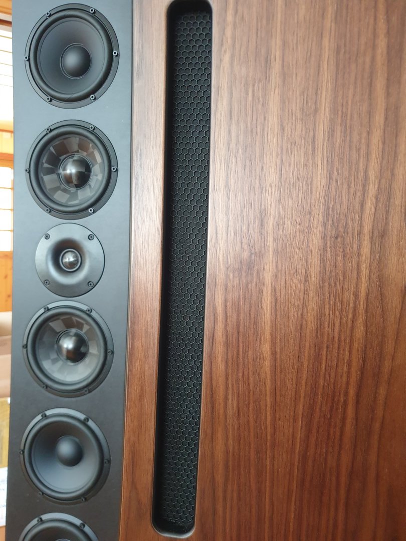

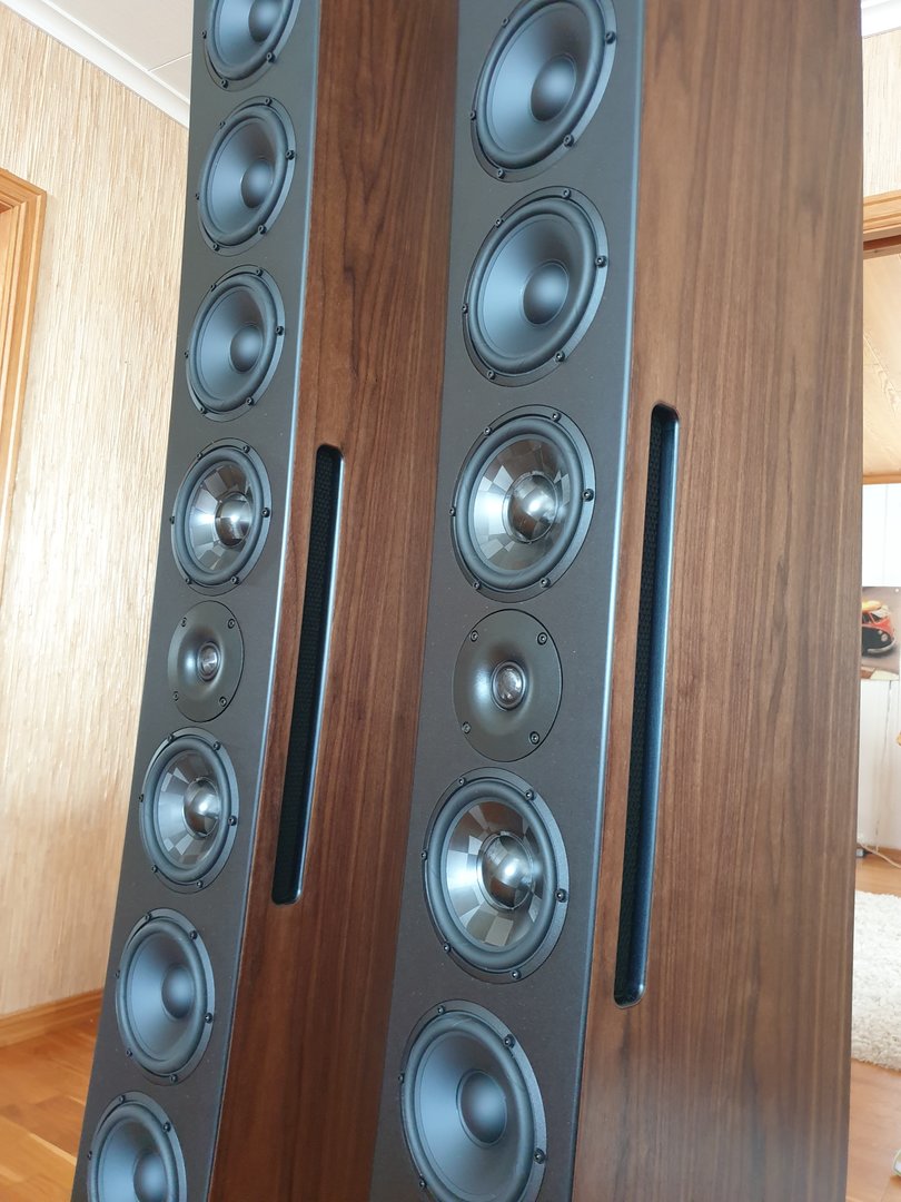

Seas DIY from Mr. Overn:
L16RNX3 + TCPD's and a integrated Hypex FA503 (rear panel). Drivers said to be chosen due the sound and nothing else.

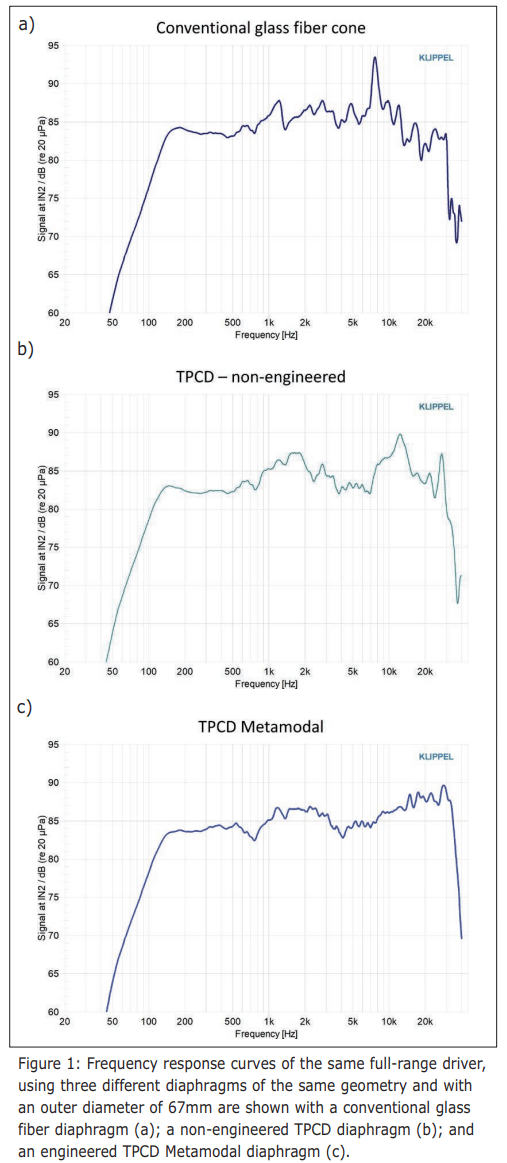

I would be interested in a TPCD full range driver described in Voice coil. Is it a new FU10 with a TPCD cone? But prices are crazy for new drivers these days.
What's funny about this set of comparisons, in the graphs, is that they haven't shown a properly optimised fibreglass cone. Something like a TG9FD which is smoother than any of the drivers compared.
Yes and also true for Scan 10F.
Only one issue: even an optimized 6~7cm fiber glass cone don't extend beyond 16k or so. This hypothetical TPCD extends to 30khz, which could be something special for the size. I found that 10F measure very well but doesn't give me exciting sound subjectively. Probably too "damped".
TPCD theoretically has the potential to use less dampened material to achieve a flat response(but W16NX005 9khz peak was a bit disappointing), not dissimilar to what KEF meta material has achieved. Will be interesting to see how it goes.
Cardioid midrange? is it cardioid bass too?Seas DIY from Mr. Overn:
The new coax sounds just incredible, (would be happy with a sub mate though). google thread: "Seas metamodal joy"

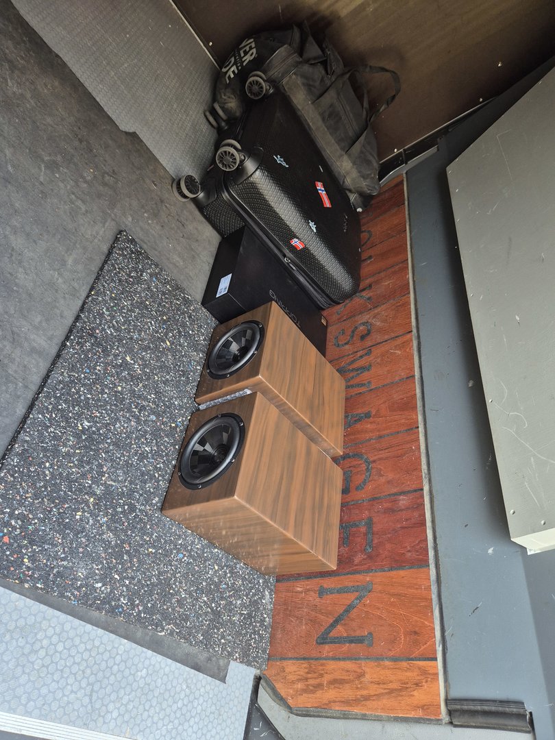

@wilbur-x
Have you considered laying your woofers along the ground?
I found this phenomenon curious…
https://josephcrowe.com/blogs/news/dual-woofers-flanked-horizontally-design-study-on-distortion
Hi tktran.
Yes, I have read this article and found it to be very interesting. Have passed the tip on to a neighbor who has a massive subwoofer project (16 x Seas ROY). Unfortunately, my own subwoofer towers cannot be laid flat on the floor as they are 2.4m high (negative waf).
