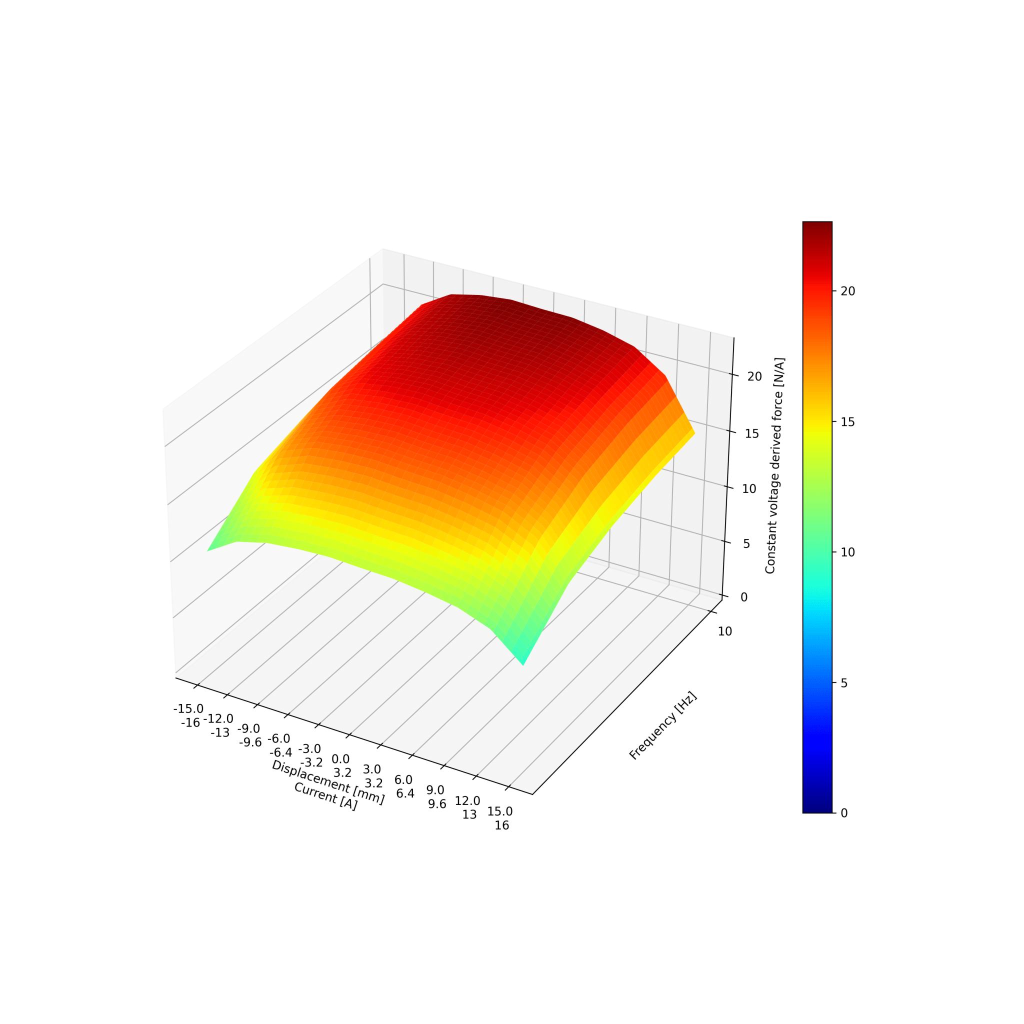

The Klippel graph demonstrates a very non-symmetrical BL curve.
But how to cope with that as a manufacturer without having to tune each voicecoil individually before glueing the vc-spider-cone assembly? Or is the Satori motor above inherently asymmetric beacause of design flaws?
There are two main things to note there. One is the X-centering. This is just a question of tuning the production line assembly tools. They can be adjusted down to maybe 0,1mm quite reliably, depending on the size of the parts. Very wide suspensions and large, heavy parts are not nearly as precise, while a tweeter can easily be tuned to better than 0,1mm if one bothers to make good quality. A driver the size of the Satori 6 should be possible to tune at least near that range.
Secondly, the tilt in the curve towards one side is a design issue. This is something that is most effectively sorted in a relatively simple FEM-simulation before one even starts building prototypes.
There are some old standards, or more like habits in the industry that commonly uses -18% for woofers and -30% for subwoofers as limit for Bl loss.
Using THD is not a great idea as the driver may seem to cancel out distortion in the suspension, while at the same time producing masses of IMD.
Since the opposing force that the motor has to work against is determined by mass, compliance (including cabinet) and frequency we typically see that in such a test one works against the suspension as the dominating force, while in determining the amount of IMD, all secondary tones of interest will stay far above the system fundamental resonant frequency, thus making the moving mass the dominating opposing force and therefore taking suspension out of the equation. This is simply not covered by measuring THD, and we therefore rarely get any valuable information about this.
A motor design can and should be judged both by its ability to keep Bl constant with motion, its ability to keep Le constant, and by its ability to keep Bl constant under different currents and frequencies. Those last bits are typically very much overlooked, meaning we have numerous expensive designs out there that performs excellently right up until things start to go a bit more complex. Since all we see related to Le is measured at 1kHz, the information we get from this regarding the motors stability is very limited as well.

There is a difference between a static offset and a dynamic offset.The Klippel graph demonstrates a very non-symmetrical BL curve.
The first one is a matter of having your production methods right.
The second one is having your design "right".
Which in some cases is not always easy, since there are other parameters besides distortion that are (more) important.
(distortion feels a bit like pixel peeping these days, as if it's the only important parameter).
Since most speakers are mounted in a box with a certain volume, some manufactures actually even compensate for the asymmetry of the compliance that is created by this volume.
Also, an asymmetry results mostly in even order distortion which isn't as harmful.
In fact, most people find this even pleasing.
Especially for lower frequencies, I would much rather prefer some higher 2nd order but an absence of odd order vs lower overal distortion with higher odd order.
So purely looking at this the BL or Cms graph doesn't show the whole picture.
It only shows us some information how a driver behaves around the Fs.
It even assumes that this Fs doesn't drift (which can be measured with a Klippel system, but no one seems to show that)

After all this time, I finally got to make a simulation showing Force factor, current, position and frequency in the same diagram. I am going to develop it further with DC offset, but this is what I have at this point:
PS: THIS IS JUST FOR ILLUSTRATION, IT DOES NOT SHOW ANY OF THE DRIVERS IN THIS THREAD!

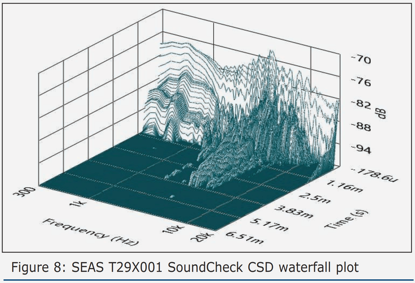

On the topic of Seas TPCD, Vance Dickason at AudioXpress has tested the T29X001 now. I do not think they have published it open to everyone yet, but hopefully I will be forgiven for showing a teaser:
