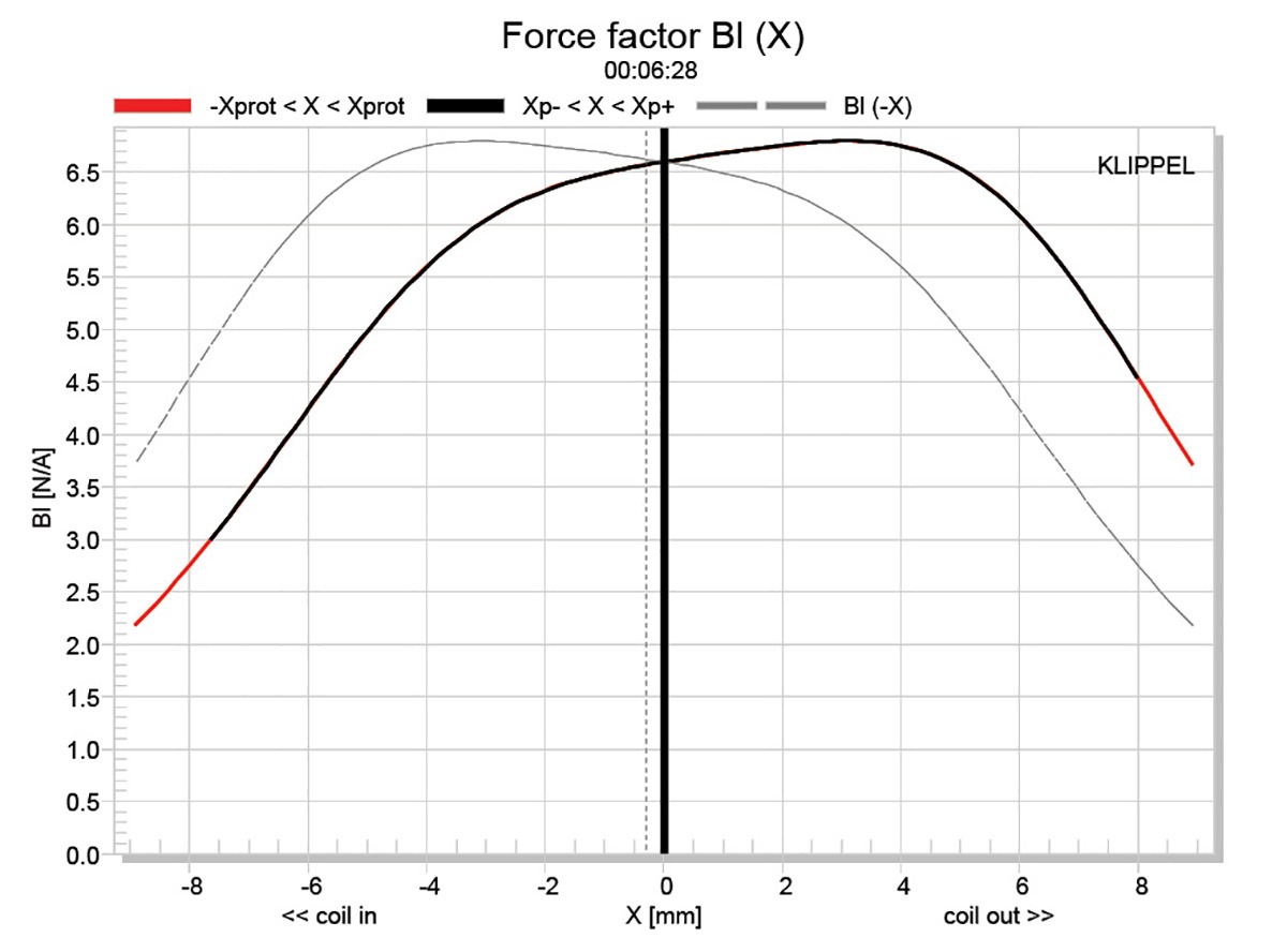

But satori motor has bad design flaw its motor for a high end speaker, like you see from klippel picture. Satori has very high IMD distortion. Even cheaper SB17 -series is much better. I'm 100% sure that seas TPCD beat satori at this point.
