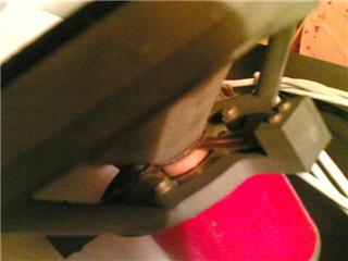

"A totally new and proprietary spider design dramatically improves the performance of this critical suspension part. By combining an extremely open weave with a new resin formulation, all noises normally created by the friction of the threads rubbing together are virtually eliminated. Additionally, the open weave is highly acoustically transparent, minimizing the reflections and resonances associated with conventional spider designs."- states SEAS about their new 8-incher.
Har har.
Surprise, the pic is _not_ from the SEAS exotic F8!
Hey who is the first one to recognice that driver?A little help: It's from 50's, and I bet SEAS got a pair or two of them too at their residential collection...😀
BTW, it also has a curvilinear cone and whizzer, as that new SEAS too, plus some more original features which SEAS has -for obvious reasons- not decided to follow. And they both use Alnico, and both are red painted.
Is that similarity just a coinsidence?
Har har.
Goodmans Axiom 80?
