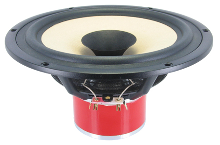

paba said:so I'm getting this right? There are 2 fullrangers from SEAS...
The Exotic F8 as per the web site and the custom order unit for Nelson Pass called the X1 (in reference to the Pass Labs X1 perhaps) that may also be offered to the public in the future?
I am informed that it is an F8, just the pair I got are marked
X1. Possibly they were made before the model designation had
been decided.

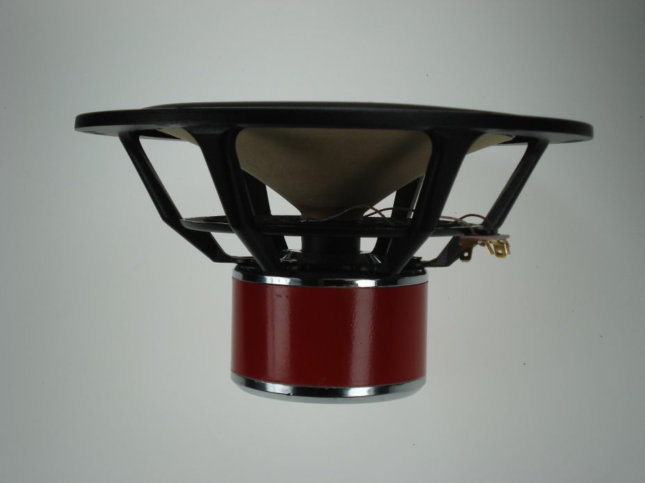

Nelson Pass said:This is not a custom driver for Pass Labs, it is an early sample
of something slated for production if I understand SEAS
correctly.
I hooked up my handy-dandy usb based woofer measurement
dongle and got the following:
Nelson, the spec sheet I have seen for the F8 says:
Rvc=3.0Ohms;
Fc=31Hz;
Vas=146liters;
Qms=4.24;
Qes=0.43;
Qts=0.39.
The X1 stands for '1st driver in Exotic range'. There will be X2, X3 as well, probably midrange and tweeter, respectively. F8 stands for Fullrange, 8 inch.

Hi everyone,
Just to confirm Jan`s information
"The X1 stands for '1st driver in Exotic range'. There will be X2, X3 as well, probably midrange and tweeter, respectively. F8 stands for Fullrange, 8 inch."
If we say probably a woofer and a tweeter will it be even more correct.
Jan, thank you for the visit, the picture is dark despite the light table. I have the attached picture and can mail it to you if you need it.
Jon
