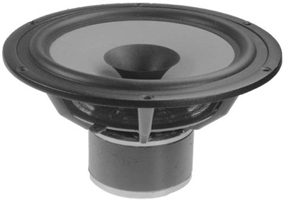

There's a new full range, single driver in town, the SEAS Exotic F8. It will be unveiled at the Venetian hotel for the Las Vegas CES 2008 show. Knowing Seas, the driver will pack some great low end bass. I wonder what magnets they use.

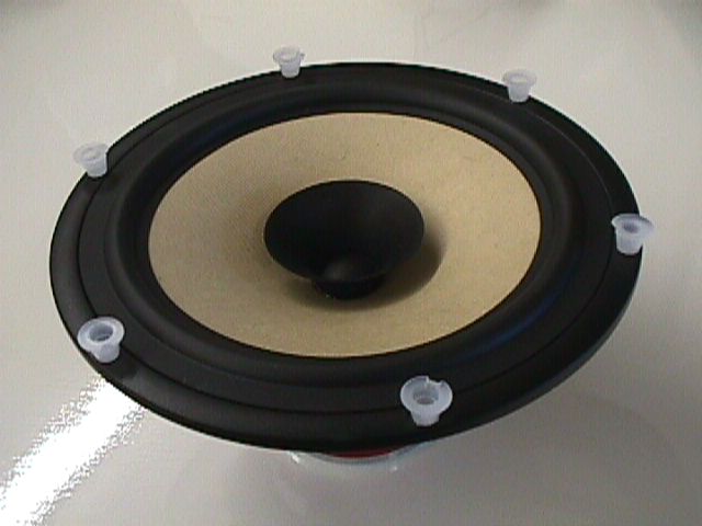

I agree that this is old news, but maybe for a different reason. The whizzer cone is shown very clearly in the thumbnail. While whizzer cones may have been an acceptable solution for the lack of high frequency performance in the 1930s when there were no true tweeters, haven't we moved beyond them?
Whizzer cones reproduce nothing. They are only a source of spurious high frequency resonances.
There are limits to full range. If you must resort to a whizzer cone then you have gone beyond those limits.
Mark
Mark
Whizzers can be tamed. Put some foam or some other lightweight material between the back of the Whizzer and the area of the main cone behind it and it fixes alot of the whizzer issues.

They don't say much about it, but coming soon...check this out!
http://www.seas.no/index.php?option=com_frontpage&Itemid=153
SEAS are relatively cheap compared to the quality, but lately they have not had many drivers with high sensitivity. Hopefully we'll have a good alternative to the made in china Fostex.

whizzers...
I feel that whizzers are kinda fun. quirky.
can be highly refined. i feel that the one in the fe166es-r and 206es-r are state of the art. despite beaminess typical of any full ranger, there is simply no whizzer weirdness in these drivers.
no foam, damping, etc either..

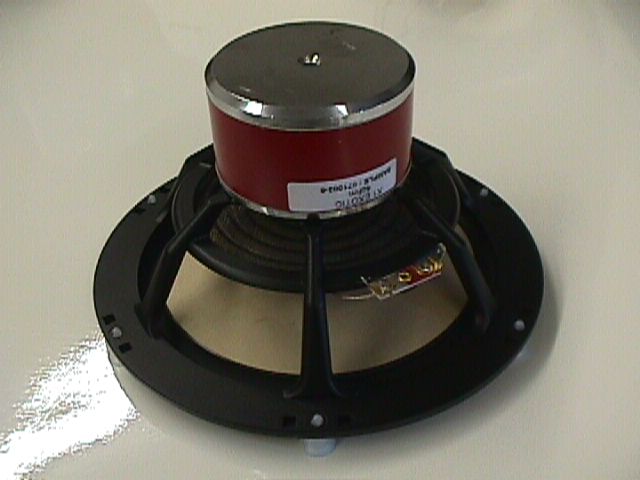

Nelson Pass said:Here's the back side, showing the Alnico magnet.
Impedance is 4 ohms, resonance is about 40 Hz, and sensitivity
around 93 dB or so.
I'll be loading them up this weekend and getting some initial
measurements and impressions...
Nelson: looks very promising, as you can imagine your impressions will be eagerly anticipated
....and with all due respect Mark, as far as whizzers are concerned, there are probably a few Lowther & AER owners who might attest differently?

I love that basket. It makes a great deal of sense to me to minimize reflections with skinny legs, a tiny motor, and open space behind the spider. I can't imagine it not making a very audible difference on a fullranger.

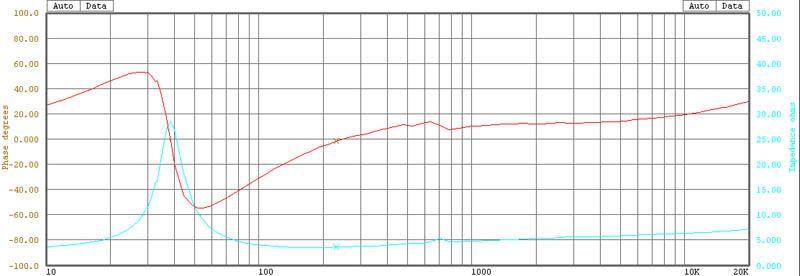

92 dB is a little short for 300B SET but if it has good Xmax and Fs of 40....hence better bass then most, maybe I can live with that. 92dB is Diatone P-610 territory and that is one lovely unit but of course no whizzer so different all together.
Can't wait to see those measurements. It will probably be a QTS of .4 or higher, don't think SEAS is aiming for the Horn market with low QTS like Fostex.

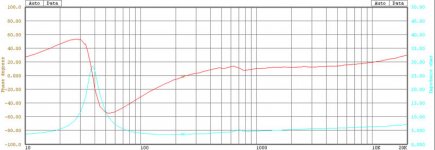

Not bad at all. Re is a bit low, but that's about par for the course with Seas. Q looks good for using in a variety of cabinets, providing Vas isn't through the roof. I reckon these could be viewed like a Pioneer B20 that's been genetically mutated & spent a while down the gym. 😀 Thanks for the info., as ever Nelson!
