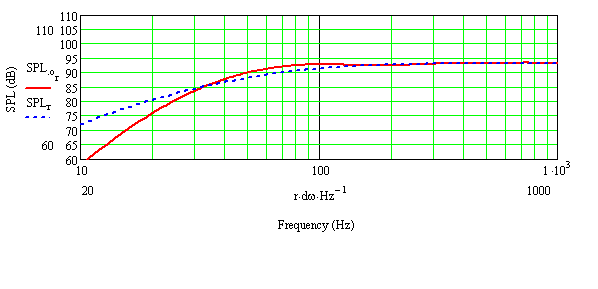

Is this going to work well in quarter wave transmission line? I guess a single folded transmission line floorstander of ~1.3m (line length of ≥2.6) would be nice.
Based on the factory specs., tuning to 85.71Hz will give you a maximally flat TL (viz. flattest performance over the widest BW), below which you'll have a shallow roll-off blending into the room providing it has decent gain.
Ron designed the Dallas II very tightly to the FE206E. It'd need changing for the Seas to work optimally; the driver needs a rather larger volume to work in for a start. You may get away with it from the POV of liking the results, but it won't be accurate to the design criteria.
Too little information to go on. The Seas needs a relatively large volume, so for e.g. I make an optimal Alpha TL as being 36.722in long with a pipe CSA of 324in^2 & damped 1.9lbs ft^3 (dacron).
No, it's a myth that low Q drivers are required for back horns. Since like any back load they are only useful over a limited BW, in practice a driver with a < 250Hz mass corner is preferable. The Seas is at 167.6Hz, so better than a lot from this POV.

Not well enough for me. The ~85Hz tuning frequency of this box is about right for a maximally flat BW TL with the Seas unit, but the cabinet doesn't have sufficient volume, so you'd likely end up with a big peak at Fb until damped to ~aperiodic levels, by which point you will have lost most of the horn's gain.
No. Troel's horn doesn't have sufficient volume for the Seas unit, and when you combine that with a pipe tuning of about 85Hz, you'd just get considerable peaking at Fb unless you stuffed it to ~aperiodic levels.
