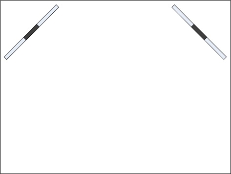

What will happen if i mount them on a open baffle, lets say 1220x1220mm center the driver and put each baffle 45 degrees in a corner?
Will there be any bass out of that?`

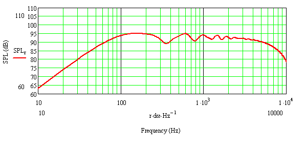

Depends what you regard as decent bass output.
Combined response of the Seas centrally positioned on the 4ft x 4ft baffle you mention across a room corner (small gap to either side). 1m on-axis. Excuse the HF roll-off; I forgot to remove a low-pass filter when I ran it through MathCAD. OK for giving you an idea of what it's doing at the bottom end though. Personally, I'd rather use it on a smaller baffle crossed to a couple of 15in woofers below ~500Hz, but YMMV.

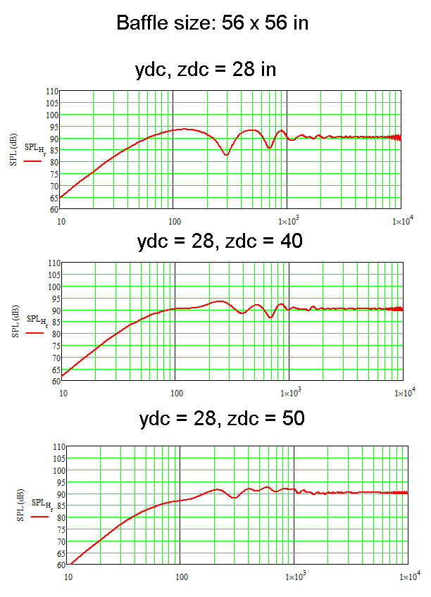

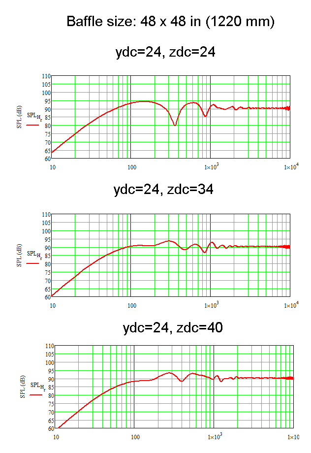

I have to double-check my numbers the next time :rolleyes:
1220mm = 48 in, not 56
Here is a new sim with a 48x48 baffle. I will make a proper cab for this driver, but there are some people coming over next Saturday - and no baffle was no fun...

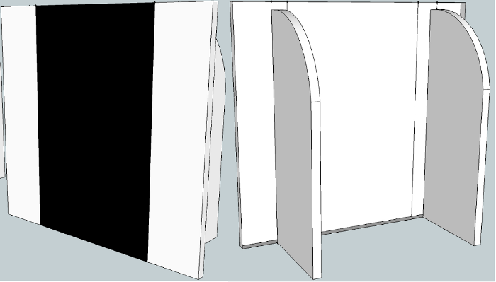

I was planning to try these speakers in OB baffle like Wharfedale SFB, but with custom dimensions(WxH) 700mm x 650mm with (WxH) 250mm x 630mm wings. Attached picture is model from plan.
I almost ordered sheets for prototype but then I starting to think that should I increase height of baffle? I can't do any wider baffle but higher baffle is possible up to 1800 - 2000mm. Is there any sense to increase height?
So maybe I change my plans and try first Papa's like baffle which are also mentioned in this theard.
I already ordered pair of FA22RCZ but they was sold-out from Finnish distributor, so I need to wait few weeks. All comments are wellcome.
-JoniR
