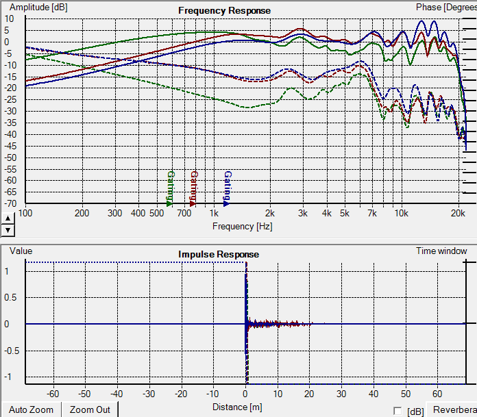

Hallo Nisbeth I got FA22 in 230mm x 1000mm , 150mm center from top 😎I have a pair of FA22's lying around and I am considering putting them in the enclosure that Seas recommends in the app. note for the F8 as I like the proportions of that better than the one in the app. note for the FA22. Are there any problems with this? Volume is roughly the same and since I'd expect to be playing with the notch filter values anyway I expect that would compensate for the changed baffle width as well?
/U.
And the response is on the picture :
Blue on axis
Red 15* off axis
thanks for sharing.And the response is on the picture :
Did you use any filter network ?
thanks for sharing.
Hi Joern , right now only equalizer . Green response from picture above only to check phase response .
BTW i find this : http://www.audiostereo.pl/klub-milo...s_60367.html/page__view__findpost__p__2256936
