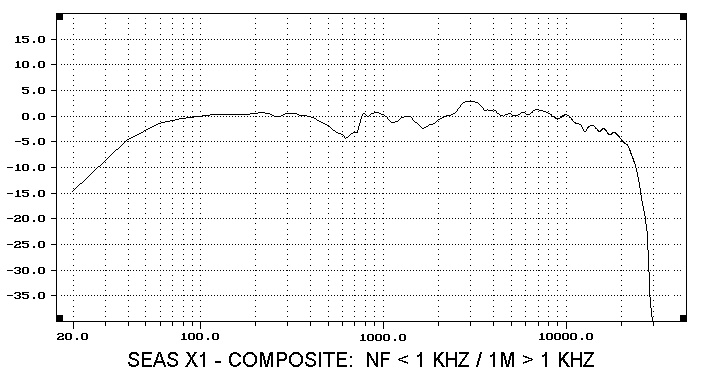

That frequency response doesn't look too great to me - more than 10dB ripple in some places.
Of course this is only one of many factors, but:
I have a pretty decent collection of response curves of full range
drivers, all taken at 1 meter on axis with .33 octave smoothing.
Comparing them, I see that the SEAS full range is comparable to
other drivers in this category, and better than many.
Here's a composite, taken both near field and 1 meter, of the
4 ohm version in an open baffle.

Well that's a good open baffle for you. Seas specs were done
with a sealed box, but I don't find the need for baffle step
correction or other Eq with a properly sized flat open baffle.
This has been true of Lowthers, Moths, and other full range
drivers as well.
