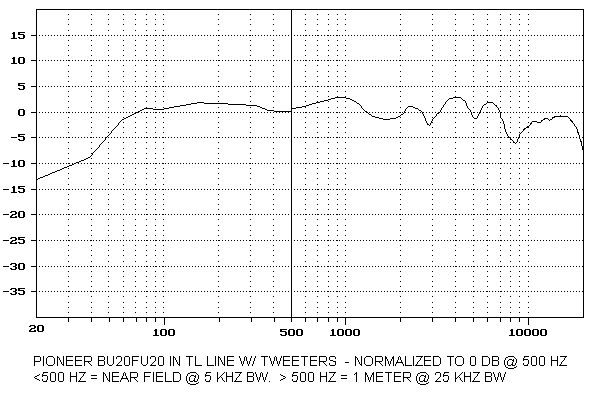

John L said:Not sure if you have been following things, but I have taken a little bit of liberty with my B20s, by drilling through the pole piece and setting out a PE tweeter, on top of a 1 1/2" stand-off. Once I finally get the diffraction lenses complete, I can finally wire it through the magnet assembly and give the driver a test drive.
Just what the doctor ordered. I've been mating them with Vifa
3/8" cheapo tweeters, crossing them in at 10 KHz with a 1 uF
cap. They look like this:
That added tweet really makes a difference. Which Vifa are you using? The one I am using is the Dayton ND16FA-6. Folks around here had pretty much decided that it matched up quite well.
It certainly does fit well on the end of a pole piece. The dowel I am using is a 1 1/3" diameter and has just enough left out so as not to get in the way of the voice coil. Wrapped with black electrical tape makes it look just like it actually belonged there.
Unfortunately I don't have all the necessary equipment to run a testing with it, but the B20 is so accomodating, that it just seems to Want to work well.
