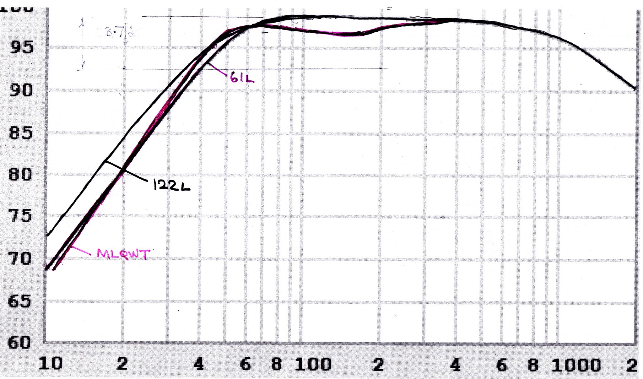

An attempt to improve on this is obviously fairly costly exercise but it is like trying to get closer to a perfection. I have simulated a 2m mass loaded QWT and the 61L a box plus a 122L sealed box. For my own information I traced them so all sims are on the same graph. It’s a bit messy but is attached.
The 61L and 122L are the smoother curves, the bigger box rolls off slightly sooner by a fraction of dB but maintains output lower. The MLQWT has a less even FR, maintains bass for a fraction longer and drops away a little faster.
Now here is another consideration; SEAS say “We urge caution against exceeding the maximum excursion limits of the driver in enclosure designs that do not provide a high degree of rear loading at bass frequencies.”

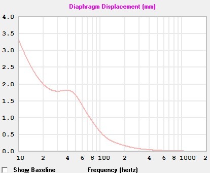

The cone displacement increases quite a bit in the designs that have open ends and most amplifiers can deliver bass at least to 10Hz. The sealed boxes do not suffer from this. Below is cone displacement for 2m MLQWT increasing rapidly on low notes for a low power input.

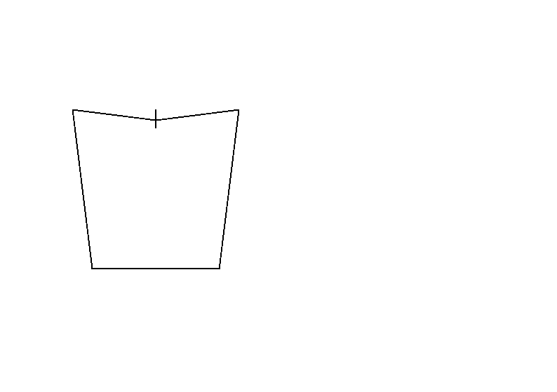

Another thought experiment is about the internal reflections of a rectangular box. Trying to get the best possible sound from the driver how significant are the internal waves?
A closed box of similar volume with a sectional shape such as this would alter the internal reflections.
I think a mass of standing waves between 1KHz and 3KHz would be inhibited. Could this make the speaker better?

Ah! I sort of remember that speaker. So the question is, would a really solid well damped box, possibly treated with these pointy bits improve the sound. If the coloration from the box and the waves reflected back through the cone were reduced a lot, in theory it should sound better.

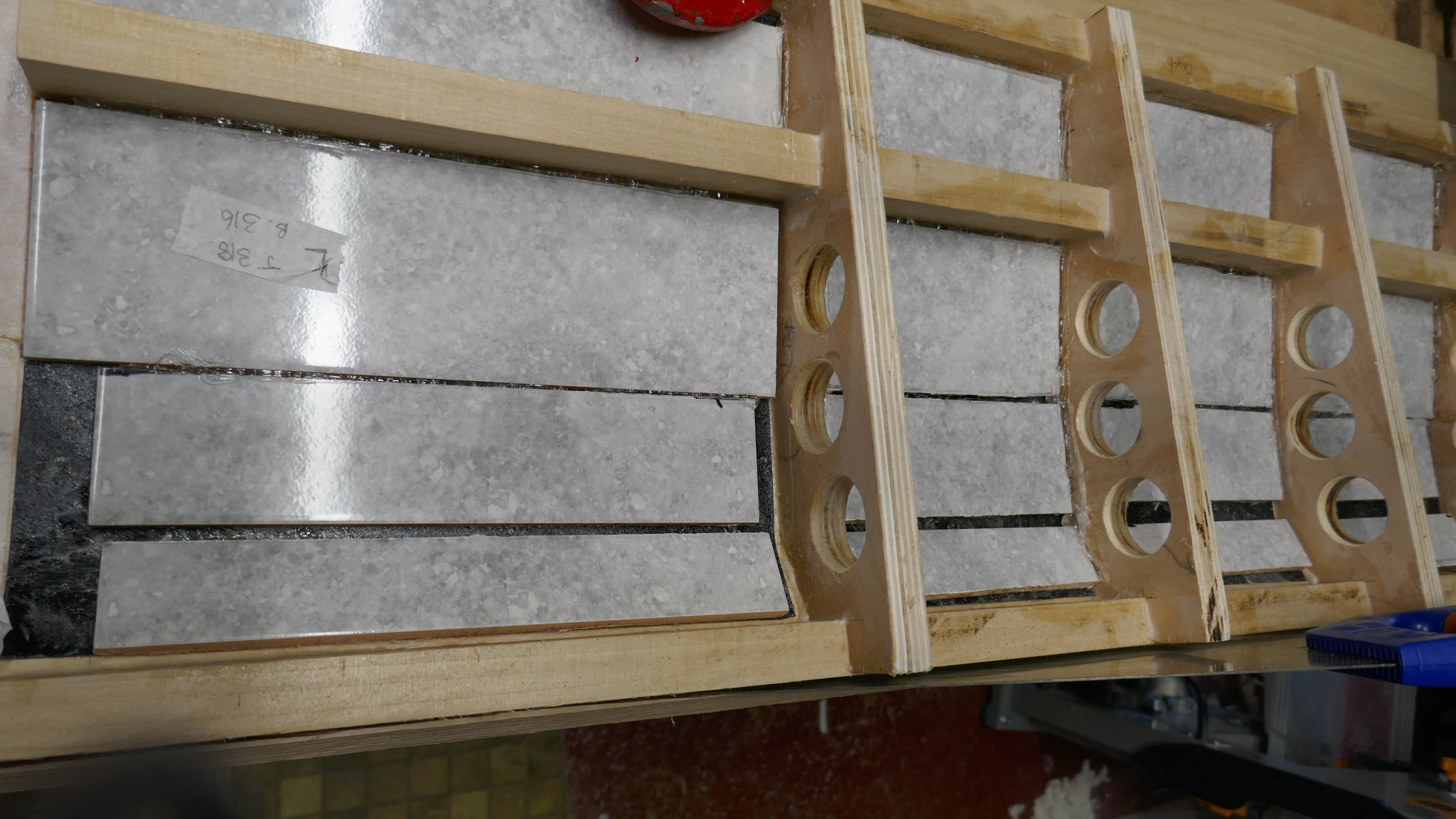

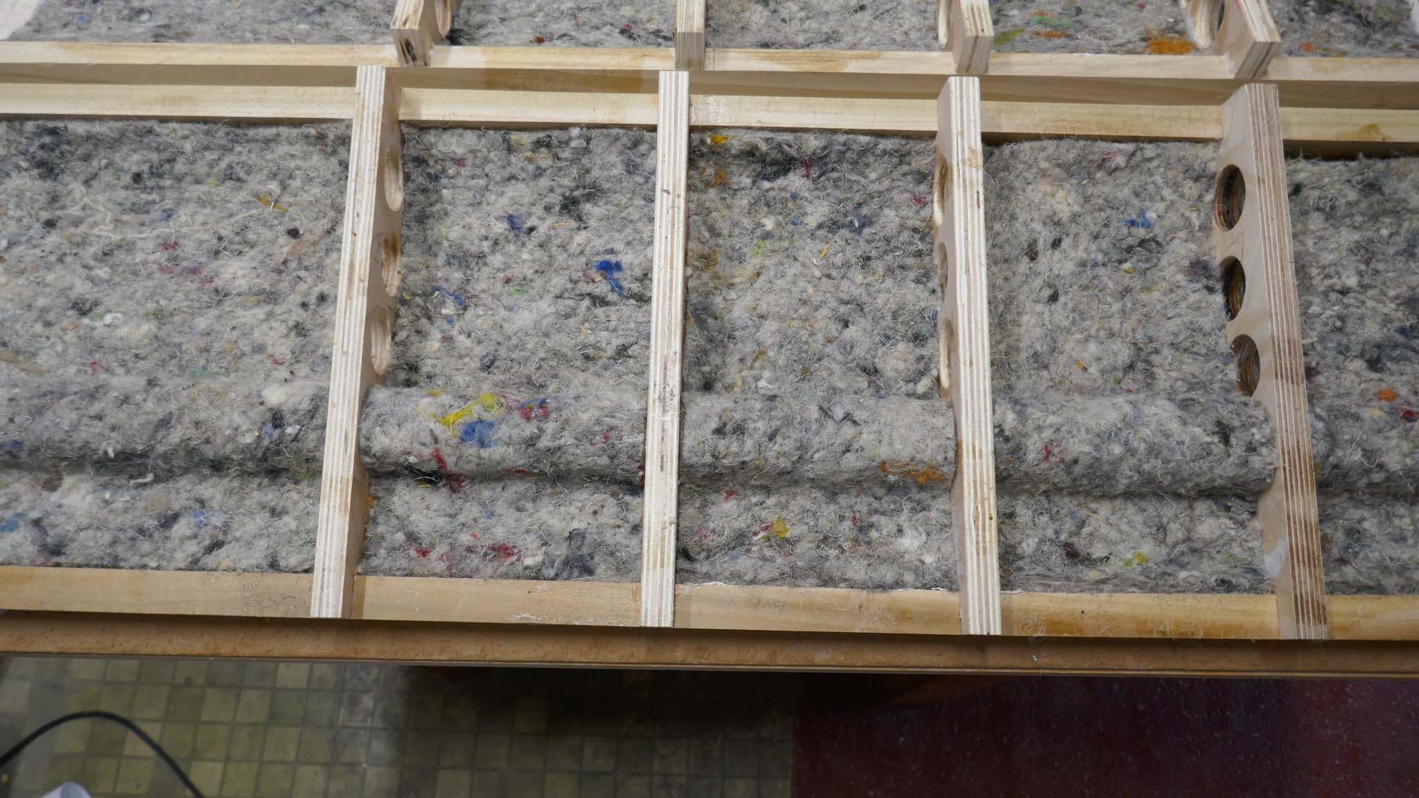

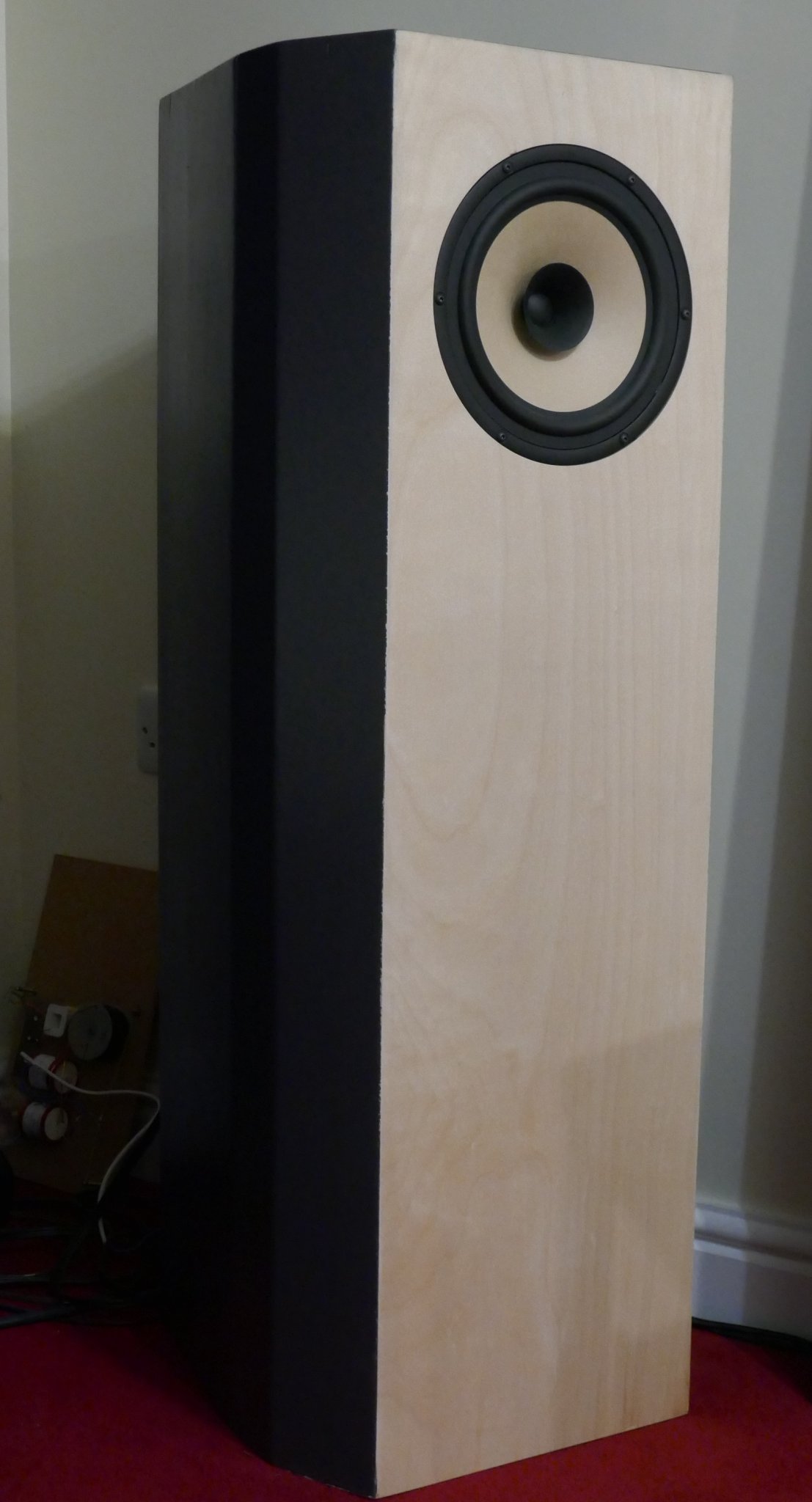

To continue the story… I liked the SEAS very much and considered making an enclosure to hear them nearer to their best. This project was an experiment which I hoped would yield interesting results on the sound and would show the effect a different enclosure would make. It has taken about a month to build after weeks of consideration, researching and design bearing in mind the helpful comments received. I decided to stay with a sealed cabinet of 60-65L. The design has:-
  • A lozenge shaped cross section made with flat panels of 18mm birch and hardwood ply with bracing so that the sides were divided up into many more small panels of differing sizes.
  • The sides employ several layers of materials to reduce resonances, including rubber, ceramics and 15mm wool felt bonded with spray contact adhesive.
  • Front and back panels are double thickness 18mm ply.

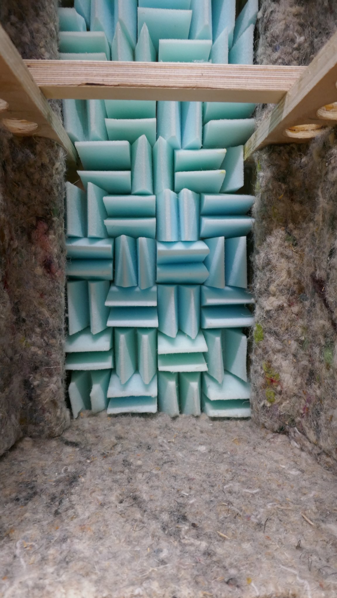

  • Back panel is lined with anechoic foam wedges.
This construction is dubbed multi-material technology (MMT) as manufacturers like buzz words to impress buyers.
The development has worked and I am very happy with the result. Each speaker weighs about 10Kg more than the original birch ply SEAS design.
The immediate impression was of a quieter speaker with a smooth and detailed sound quality. The cabinet does seem to be emitting less noise, and the reproduction is more clear and detailed. Bass is solid and treble very clear. The speaker is sweeter and I think apart from less noise being emitted through the cabinet sides, less is being reflected from the back and affecting the cone. Piano music is strikingly good.
The change makes quite a difference and I found it possible to reduce the intermediate treble cut by several dB. For much music it is possible to switch it to zero.
I have now been listening to these for two months. The freedom from unease with the sound is noticeable, the speaker seems to have less character of its own and music speaks clearly. The previous version, while hugely entertaining and arresting does seem a bit more tiring and it imposes its character on things more. I find I want to listen more often and to more kinds of music.
