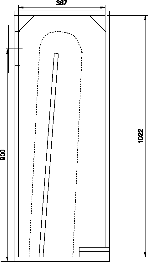

Using mh-audio.nl calculator with SEAS data; Fs 32Hz, cone area 222 cm², Qts 0.44, suggests a folded design 132H x 25.3W x 37D (cm) with a line length of 259 cm. port tuned to 32Hz.
This would be a bit taller than I had in mind and I sketched a possible starting point which has an estimated L of 206 cm. The pipe starts same area as the cone 222 cm²and expands to 666 cm².
I’d be grateful if anyone knowledgeable on these comment on the soundness or otherwise of this.

That simulator will not do the ML-Voigt you ar elooking to do.
To know what the box does you need a proper modeler. MJK (NLA), HornResp, or this https://www.diyaudio.com/community/threads/transmission-line-modelling-software.220421/

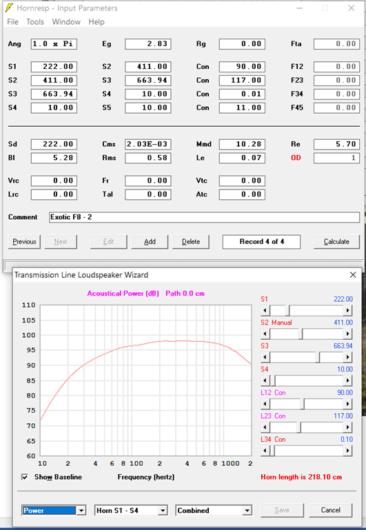

Thank you for pointing me in the right direction. Using hornresp I have simulated a horn with mass loading tube, It looks promising (am I doing something wrong!)

There was a mistake in that simulation – I’d forgotten to put in the area of the port. I have since spent hours becoming familiar with hornresp (fun!) simulating various tapers and pipe lengths. Have concluded that a 2m line with suitable damping will give a useful extension of bass while hopefully keeping control of the cone movement.

The existing speaker is basically a tall sealed ?
Sort of a resonant pipe because the driver rear is firing into the middle of a tapered 6' sealed pipe ?
A half-wave resonant line. tuning frequency of about 95 Hz if straight, tapered it will be somewhat lower.

Needs more care with inernal fill to blunt or kill the half-wave resonance.
