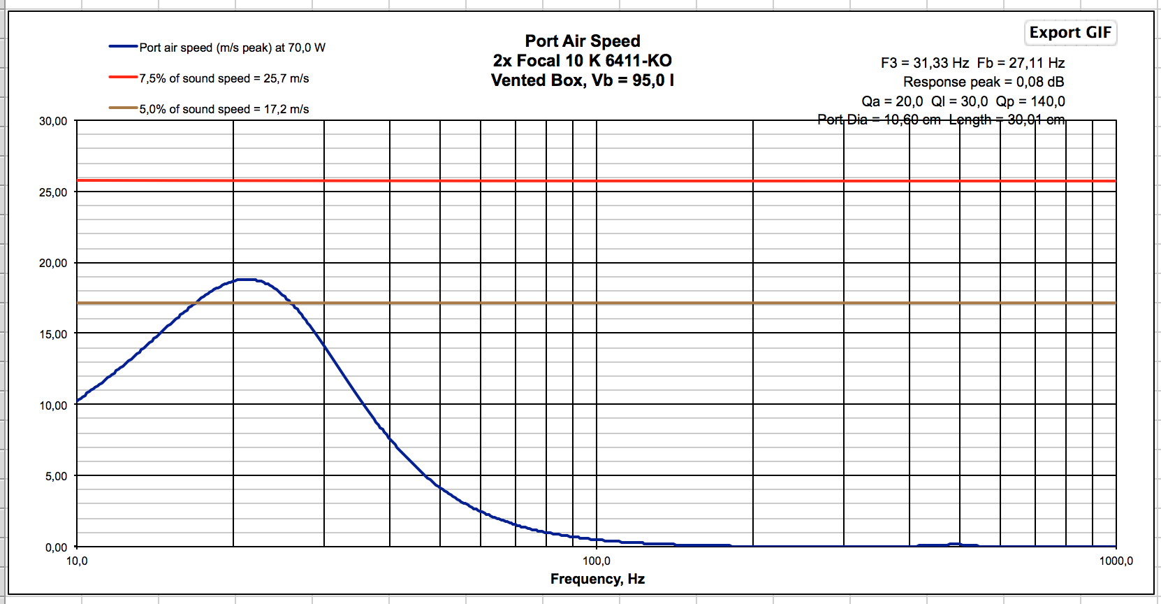

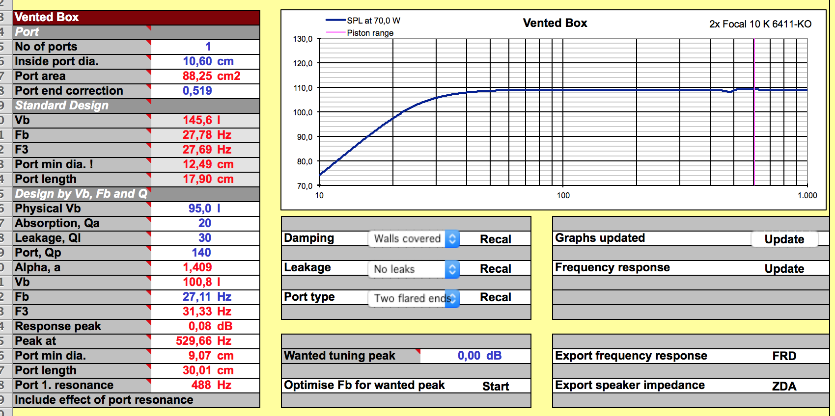

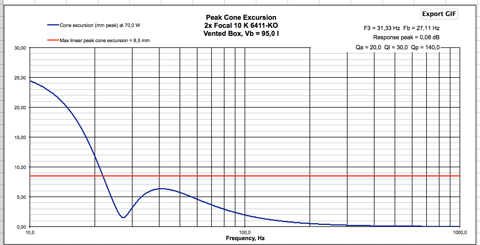

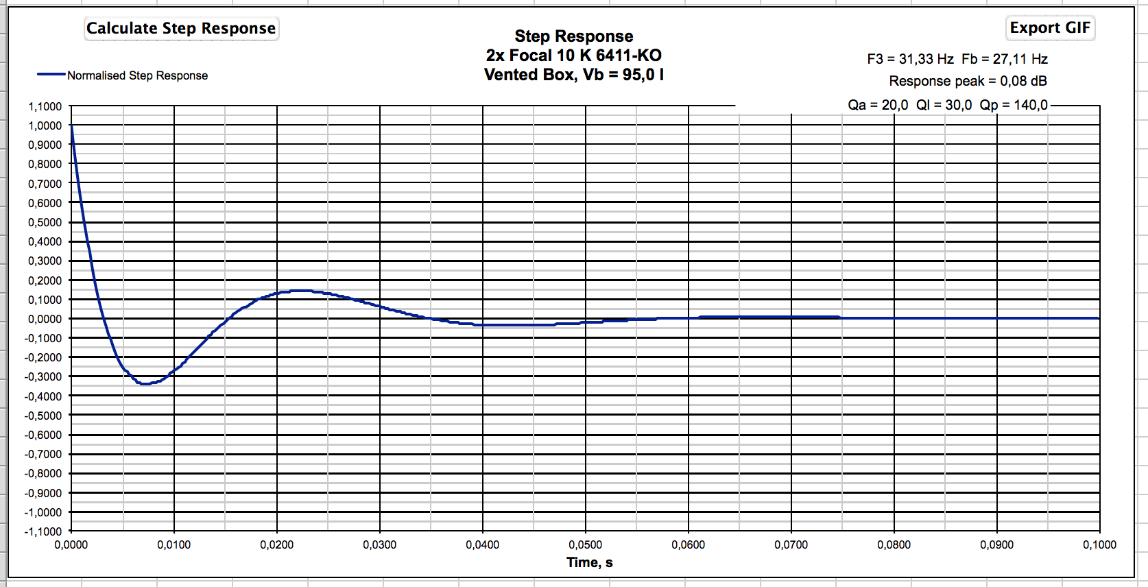

For bass alignment you probably don't want the configuration that achieves the lowest F3 in simulation. In most smaller to medium sized rooms this will give you a booming one-note bass due to room modes. Only in very large rooms with the speakers positions significantly out from the walls (1m+ from rear wall, several metres from side walls) does the alignment with the lowest F3 sound balanced.
My experience is the same as many others - a practical alignment is about midway between a sealed box, and a ported box that achieves the lowest F3. This means slightly smaller box and tuned a bit lower than you would when trying to achieve the lowest F3. Of course, if you don't know what is going to be suitable build the box larger and add fill later to make it smaller if the bass is too much.
Are you sure you ment "smaller box tuned lower" and not tuned higher? Taking a smaller box and then tuning lower doesn't seem that logical to me but if you say so.
What would you recommend then? I can only guess what would a good box. I do want to go low though. The Seas woofers already don't go as low as previously considered drivers.
Well believe it or not, I might be tending to change drivers again. When tuning a smaller enclosure for the Seas woofers I figured MW19P-4's go about as low as the Seas would go but will quite obviously do it with better quality because of their moving mass which is two and a half times lower and because they are Satori's. Thoughts?

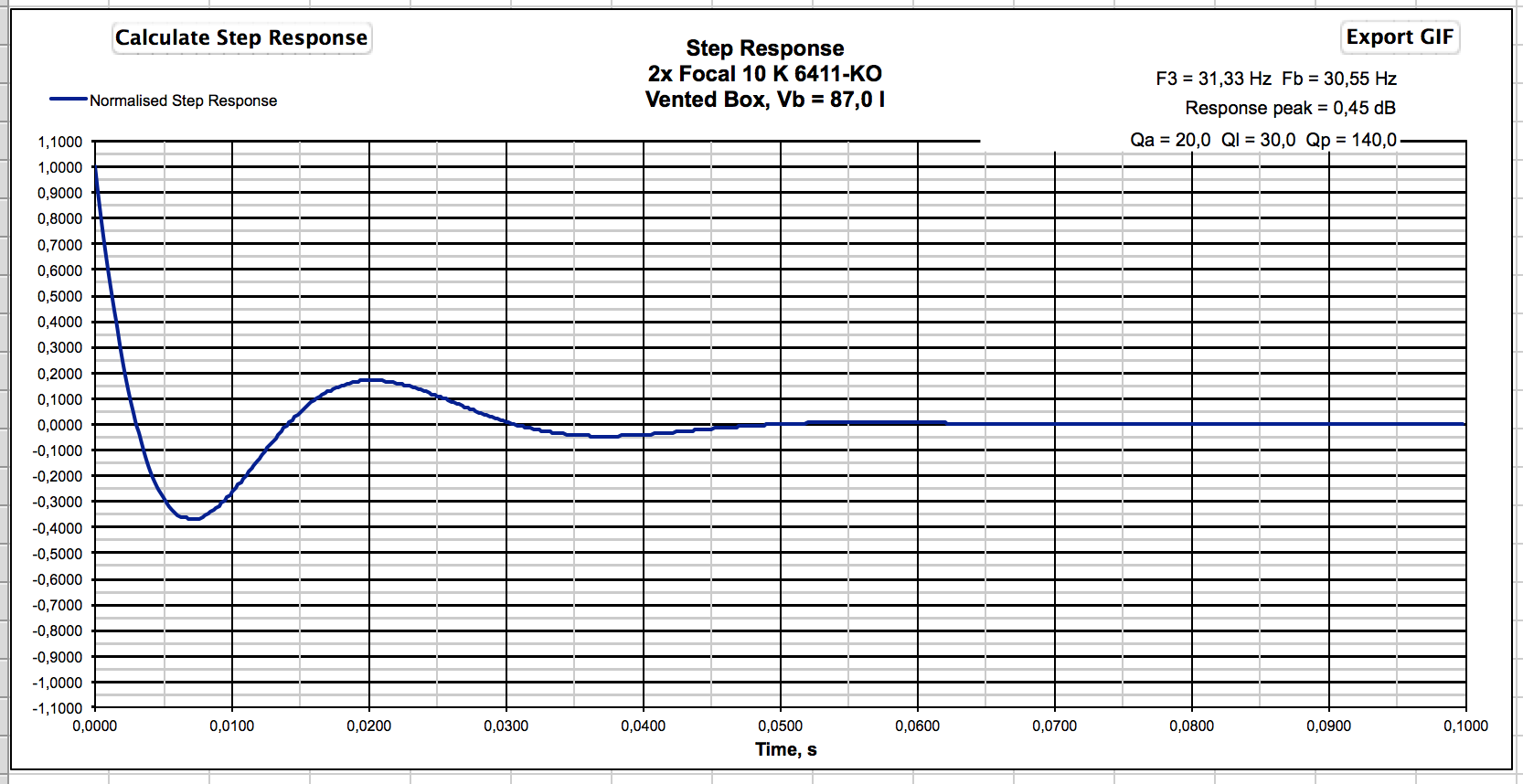

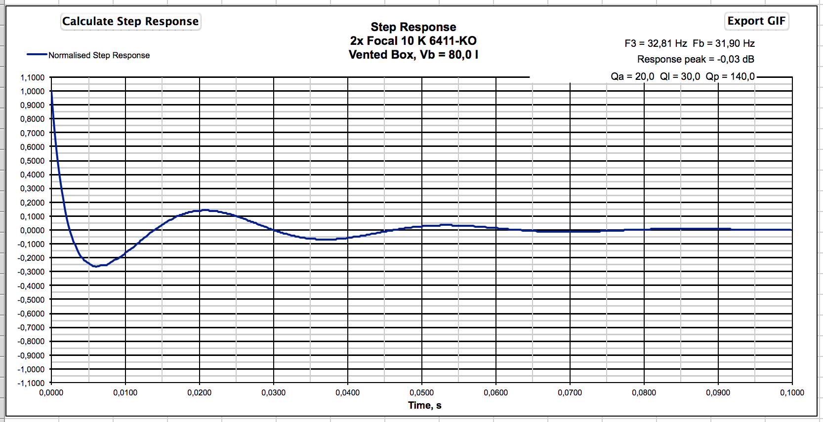

Yeah, I've just changed drivers again but now it's definitive! I've already tuned an enclosure. In 80 L, which is over 7 L smaller than the intentional box, they go acceptably low enough and of course it's not just numbers which tell how bassy the bass sounds. In the real world bass coming out of the Focal Aria 948's also sounds more powerful than that coming out of a Buchardt S400's while the Buchardt's have an F3 of 33 Hz and the Focal's of only 37 Hz. Since the MW19P-4's don't move as much air as the Seas CD22RN4X's they don't need as big of a port and the the tuning frequency is also higher so the 9,6 cm port has to be just 18 cm long. This also saves space and because it is so short it can be rear ported instead of bottom ported. This also saves 2,5 cm height since there doesn't have to be a slot between the main cabinet and ground/foot. It is also way simpler to build and I can reach the port would I ever have to adjust something. In total the speakers could be 10 cm shorter which is nice because of the slanted walls of my tiny attic room. Then the drivers will be lower but the Scan-Speak tweeter is 4 cm smaller than the Fountek and because it's a dome it obviously has way better vertical dispersion and the MW19P-4's are also like 5 cm smaller than the SB23's or CD22's and the tweeter doesn't necessarily have to be at ear height (1,1 m for me). If you look up some of the best brands which have the mid woofer above the tweeter (Mission, Kroma, Magico etc.) (almost) none of them have speakers with the tweeter even above 1 m. Most Mission speakers are barely 1,1 m in total. I've also been to a couple of hifi stores for advice. At Chattelin they had the Kroma Audio Carmen's. The tweeters on those thing are at chest height, but Kroma know what they are doing quite well! At another store where they do a little but of diy (not much and mainly turntables) I asked what they thought and they found 1,1 m to be way to high.
Long story short. It's nice to save some room.

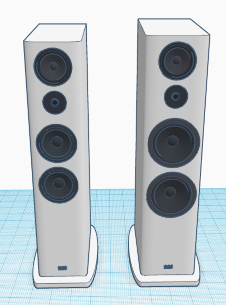

I can't believe myself but I actually just discovered the WO24P-4's might seem better than the MW19P-4's. To my surprise they have an F3 of about a Hertz and a half lower than the MW19P-4 disregarding the lower Sd/Vb ratio, they in simulation have a better impuls respons than the MW19P-4's disregarding the more than double moving mass, probably because of the smaller Sd/Vb ratio, I saw they are actually less expensive than the MW19P-4's, I thought they are more expensive which was the main thing pushing me away from them and (and this is the least important consideration but anyway) even bigger 9,5" woofers obviously look even cooler than 7'5".
What would you say? A couple of people in this thread quite encouraged me to take the WO24P-4 earlier in this thread. Are they really as good as they seem and would they be a even better choice than the MW19P-4's?

Both Jeroen and I have both the WO24's and MW19's.
If you are making a threeway, definately choose WO24.
I used the WO24 as upper-bass unit, while it is much more suitable for subwoofer use. That's why I will exchange them for 4x MW19 per side.
In a 3-way, WO24 is the better choice, as you will cross lower to the MW16.
Distortion is lower on WO24 till about 85Hz than MW19 or MW16.
Between 85 and 180, MW19 will have lower distortion than WO24 or MW16.
Above 180, MW16 will have lowest distortion.
In practice, differences between all of these drivers at low volume will be difficult to tell, so don't stress too much about it.

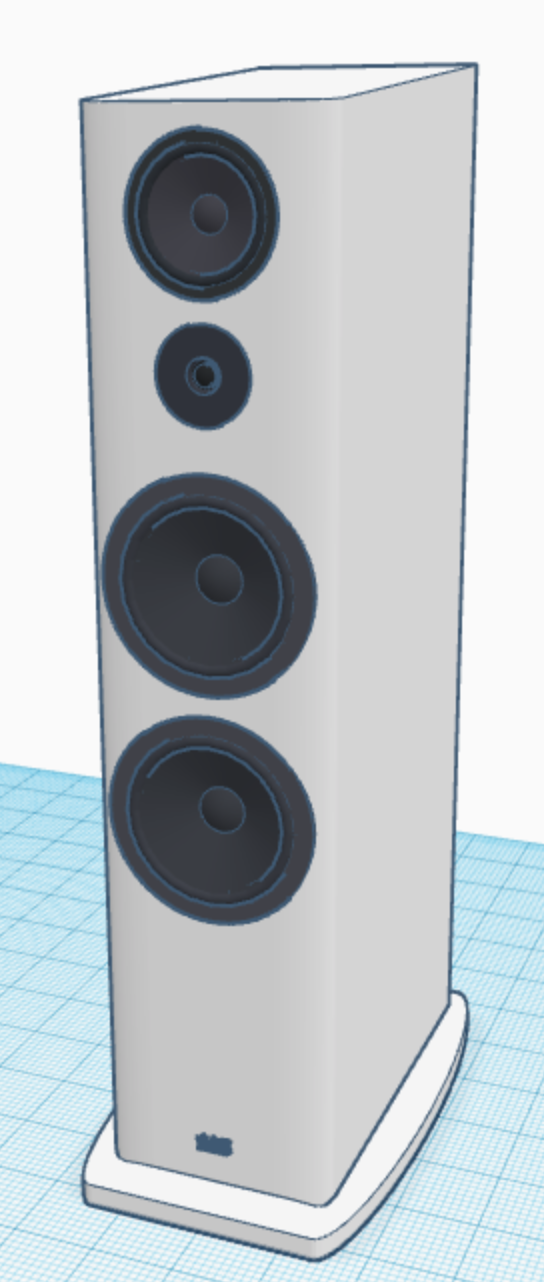

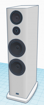

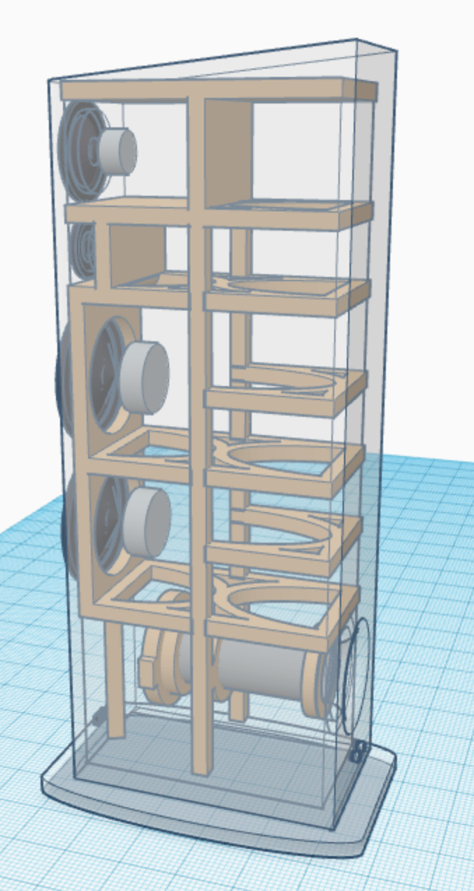

I've redesigned the port a bit. I thought they would have 9,6 cm ID tubes at the hardware store but they actually don't so I had to go with the 10,6 cm anyway. Doesn't matter, it only makes for a lower port velocity. I tuned the port a little lower than the optimum as you said. The lowest F3 would be at a tuning frequency of around 32 Hz. I tuned it at 28 Hz for an F3 of 32,8 Hz. The box is 87 L again. The 9,5" can use/handle a little bigger of a box and they needed it to fit on the baffle anyway.
The woofers will no more be coupled with the additional stut around the magnet and the mid woofer will no more be decoupled because of the complicated basket going over the magnets.

I think you remind me of my young great nephews.
