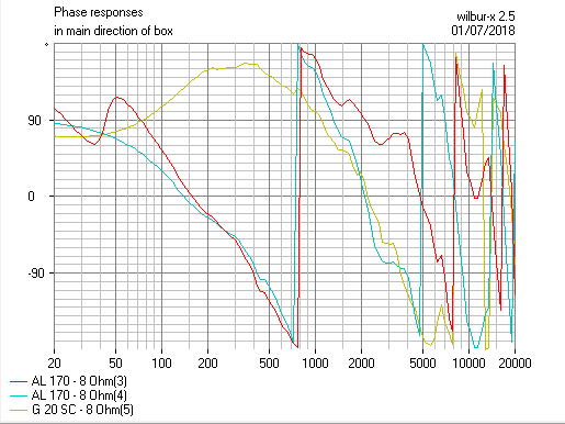

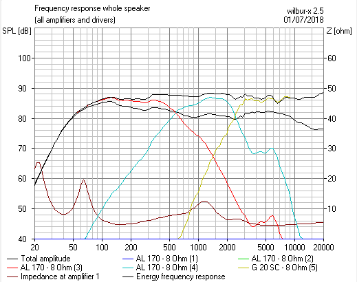

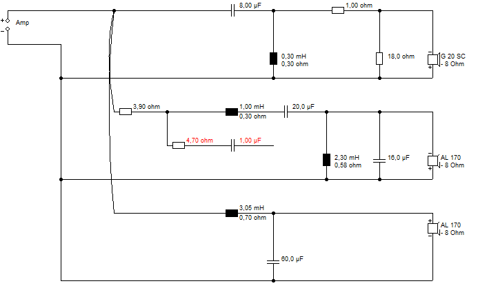

Wilbur-x, your trial crossover is an 8 ohm jobbie with no rolloff on the mid, wrong phase and no breakup attention. And TBH, I can't imagine why anyone would want 4X 6" drivers and a tweeter working at 2kHz.

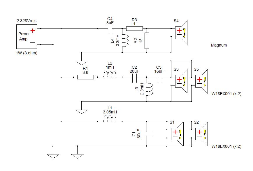

I must go briefly off topic to help Wilbur-x with his project. The schematic has a basic error which I have corrected. It also only works with single 8 ohm drivers, hopefully in separate 20cm wide enclosures. Then it is rather good of its sort. 5kHz Notch is optional. I don't like them personally. Mucks up the load to the amplifier as often as not.

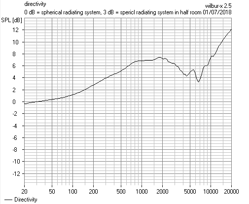

Directivity and power response is interesting. We can see how the tweeter comes over as overly bright due to the abrupt dispersion change from 2-10kHz. This is always an issue with the small domes crossed from big mids, and makes tweeter level difficult to get right. The 6dB directivity rise to 700Hz is just bafflestep.
