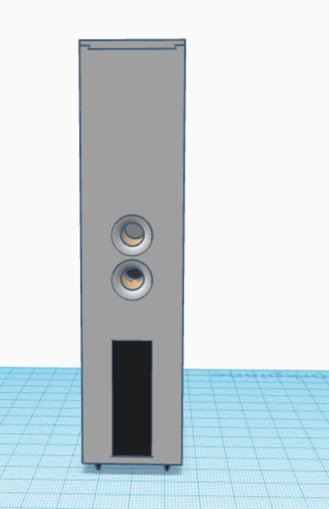

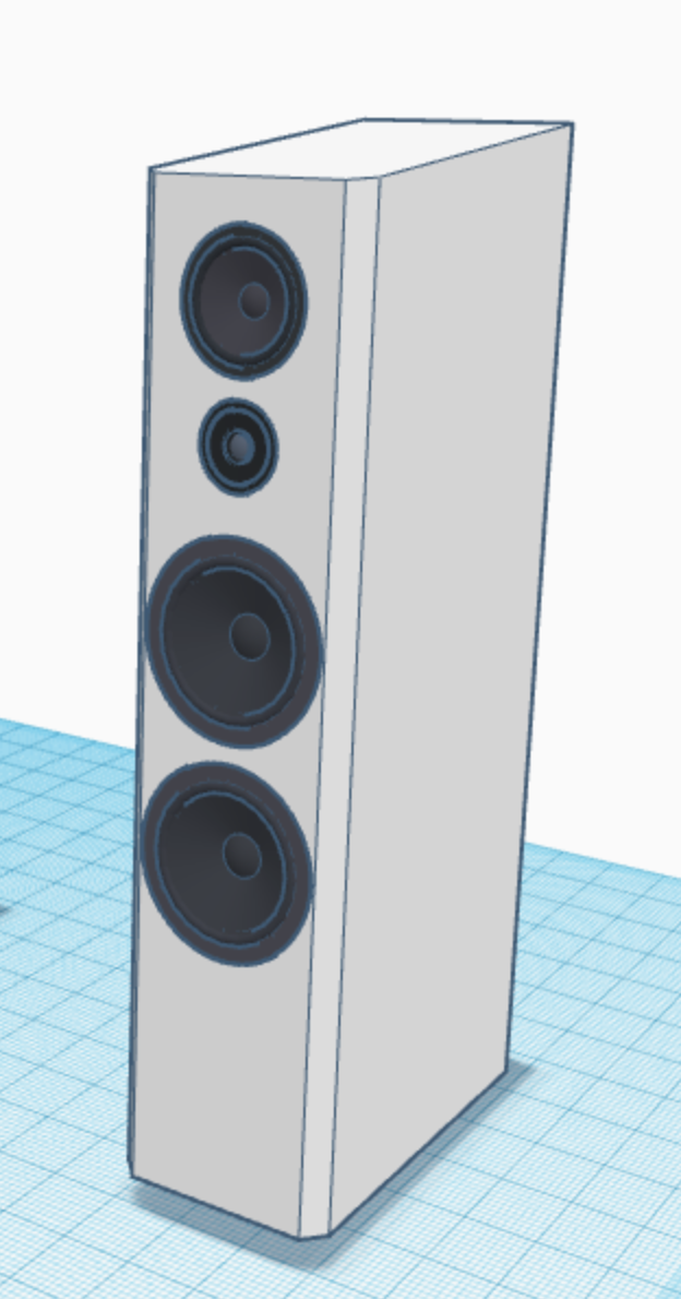

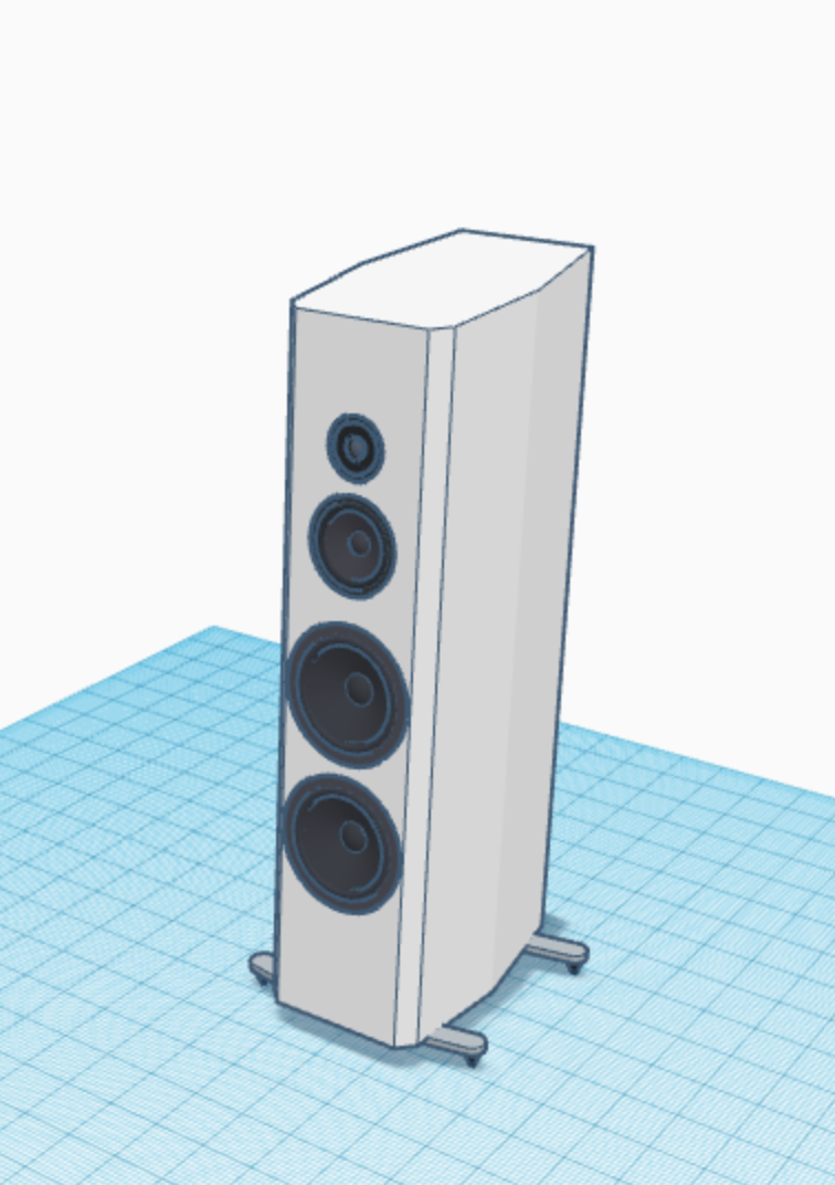

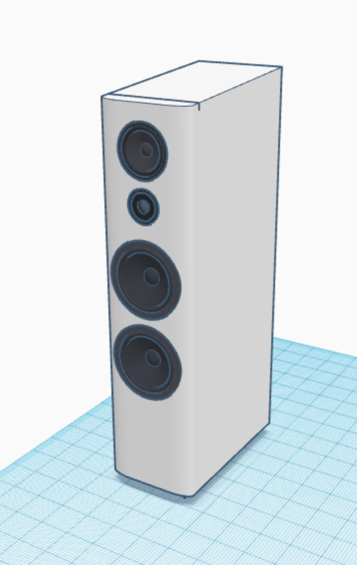

Hi guys, back at it again but now for real. I had a nearly worked out design inspired by the Vimberg Mino and it looked good but I've been to X-Fi today, the high-end audioshow in the Netherlands, and I've actually heard the Vimbergs but I didn't really like them, here I'm mainly talking about the highs. I know there is tons of other factors that determine how it will sound but the highs weren't focused enough, too far lay back for my liking. And again, I know there's tons of other factors but in general I found speakers with a midrange or mid woofer on top to sound better. Chattelin was there with both the Kroma Audio Carmen, Mimi and even Elektra, man those are amazing speakers and what a great job of integrating do the guys from Chattelin do. The only thing I found to sound better than those was the Avantgarde Acoustics Trio with Basshorn (yes they were there, yes they are insane) but that isn't a fair comparison. And another speaker which I found to sound very nice was the Audio Solutions Vantage, which also has the midrange on top. Those had the best imaging I've heard on the entire show. Even better than the Kroma's.
So now I'm determined to have the midrange on top and a normal vertical design with the drivers on the right height.
This is what I came up with. It's almost no different than the first design in this thread but I can easily make the rounded baffle because I've got contact with someone who has a milling machine. It's really, really big. I haven't enlarged the dimensions but I've designed it very space efficiently yet stiff with lots of bracing.

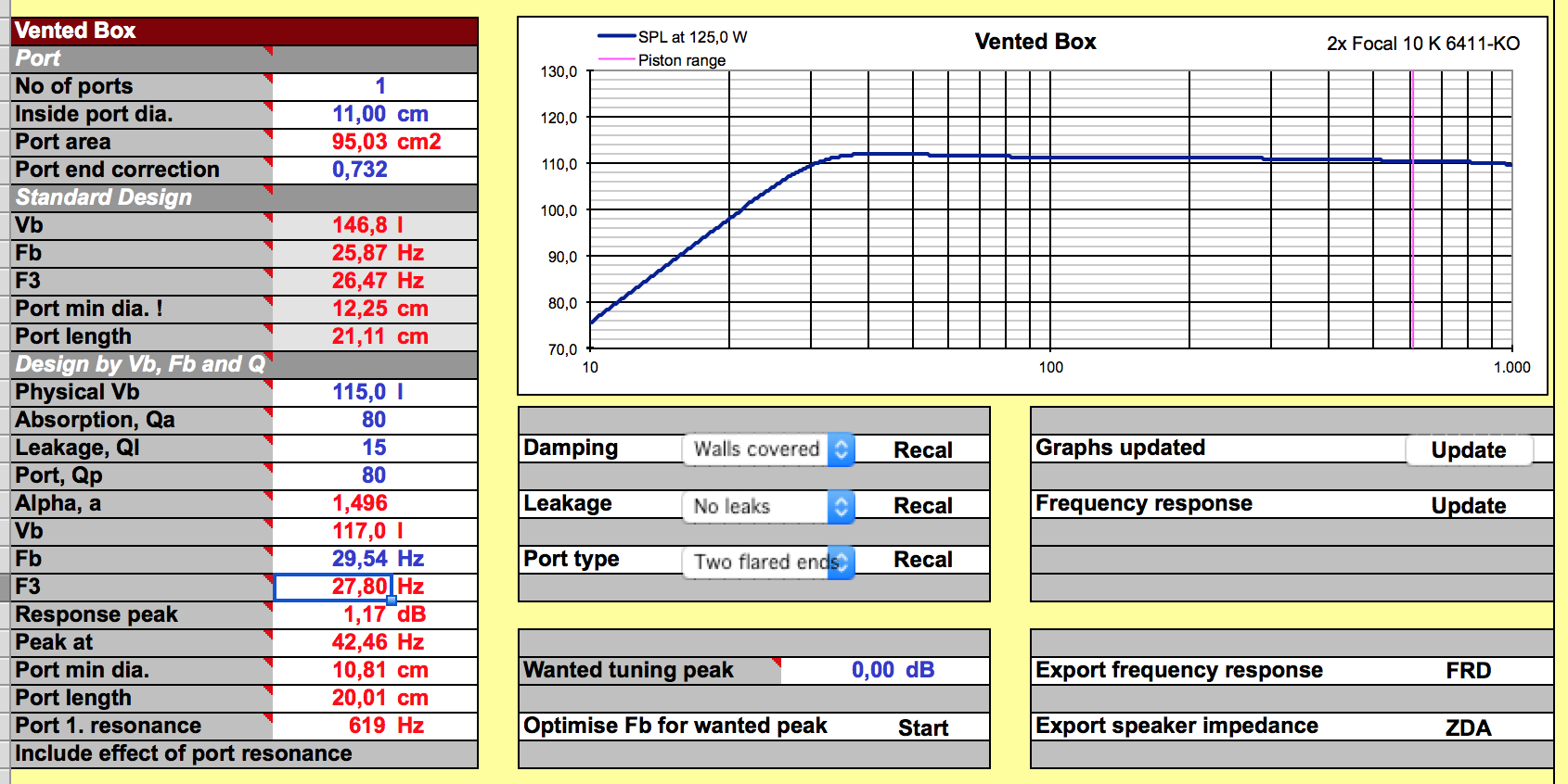

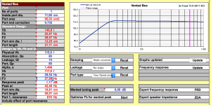

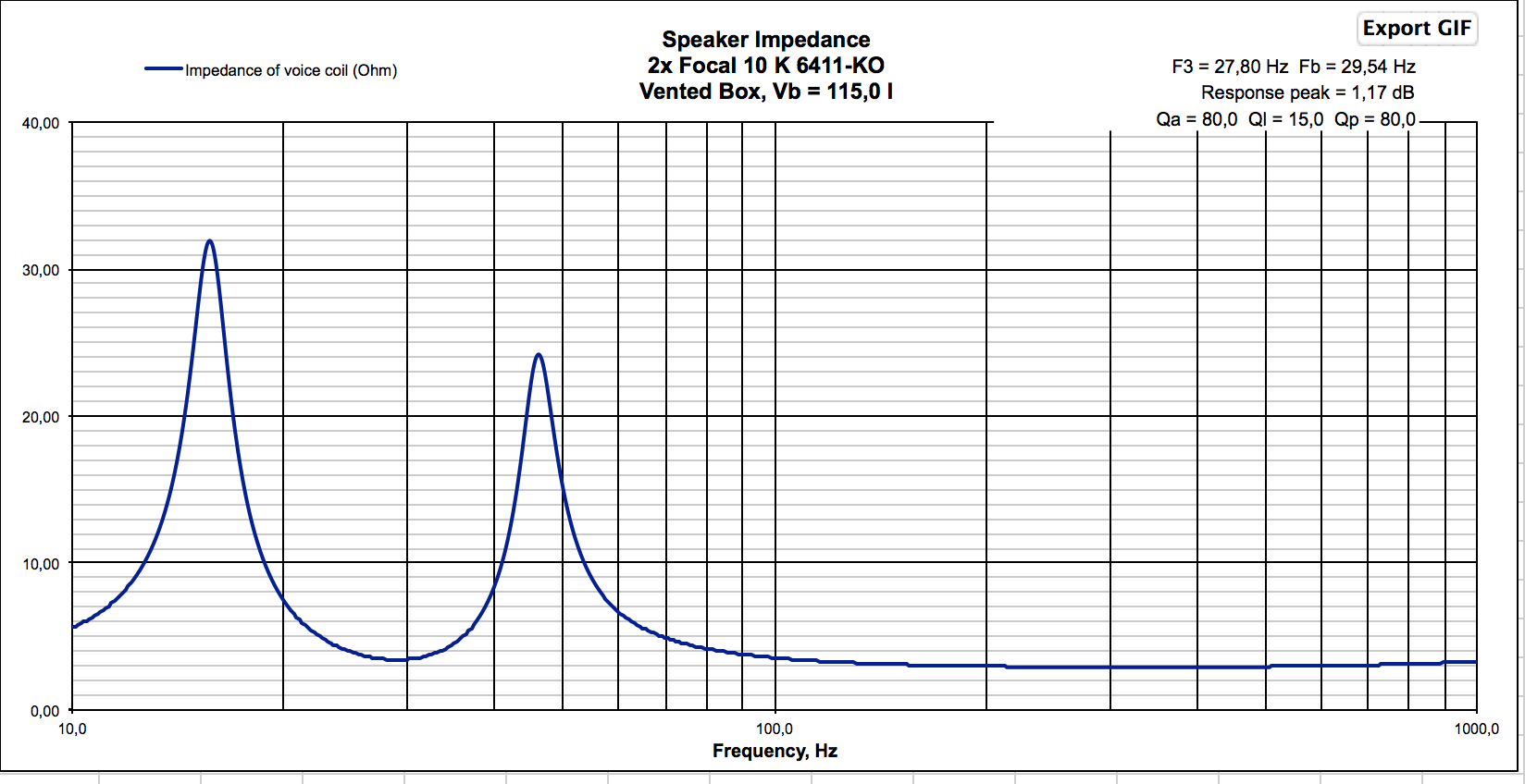

I have a little over 115 L of internal volume to my disposal which is a lot. What do you think would be the right tuning of the enclosure? Earlier in this thread someone said that I have to tune lower than the optimal F3 point to avoid boomyness but can't it be a little higher than the optimal as well? Below the optimal at the 62,5 watts per driver which the amps will offer the woofers will go over the Xmax and I know I'll almost never reach the full power but I don't want to immediately blow the woofers when I do.
What do you think?

I finally got the sound I like and I would expect from WO24P-4/MR16/SS6600 combo. It is 63l BR tuned to ~30Hz. It goes really deep and bass seems on the dry and tight side, of course it is influenced by the room. It was not easy to make this combo sounding right, I ended up with all LR4 filters and bass/mid crossover at 300Hz.
You will have to measure impedance and adjust port length/ tuning anyway.
That graph is to provide initial values. Reality will be slightly different and fine tuning based on real measurements is needed. Impedance measurement is one of easier parts in speaker development process.

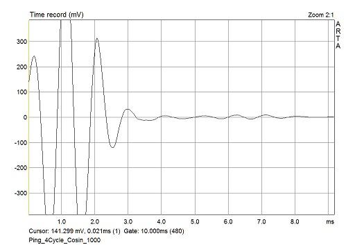

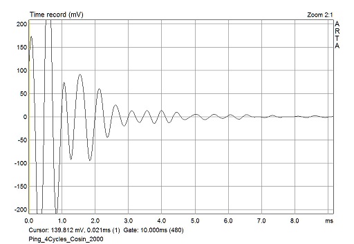

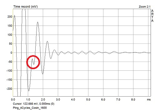

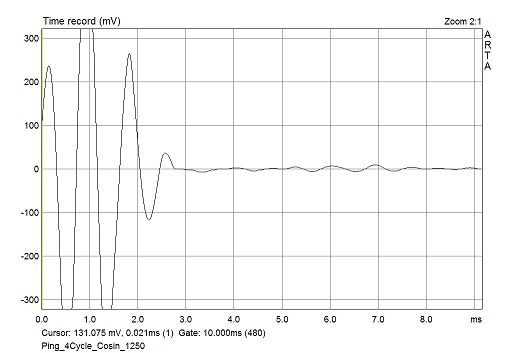

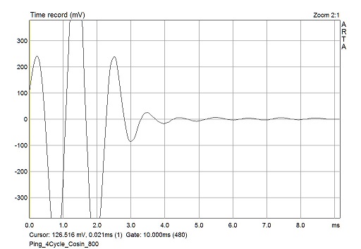

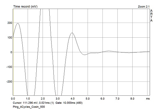

Ping measurements (4-cycle-sinewave with cosine envelope) of a Seas Excel W22EX001 (the next bigger sibling of the W18EX001) which I made some time ago showed beginning transient response deterioration already at 1600Hz. Therefore it seems advisable to be conservative in choosing the upper x-over frequency for this line of drivers. Or even better - to make some measurements of a dinstinct driver before deciding upon it's x-over.
Thanks for your advice but my interest in the Seas Excel drivers is long-gone. I'm going all SB-Acoustics Satori now and I'll be using DSP controlled three way plate amps with active crossovers.

To tune the ports. I'm not going to focus just on the simulations. A 17,5 cm piece of port will be rigidly built in the cabinet anyway because it's the absolute shortest port I could want but will still certainly not be the length I'll end up using. I will be the base. The beginning length. I will wait a week or two of playing before tuning to let the drivers and amps burn in. Then I will take the speakers to Chattelin. Their listening room is acoustically optimized. There I will tune the ports. The ports will be constructed from 25 mm MDF rings. I'll make enough rings for a maximum port length of 30 cm which is also longer than I'll ever end up using. I'll switch around the port lengths ring by ring and measure and especially listen to the performance of each length of the port. When I have found the optimal port length. I'll permanently glue the rings together on the port. So I will be able to perfectly tune the cabinets to perform best in a real world environment.

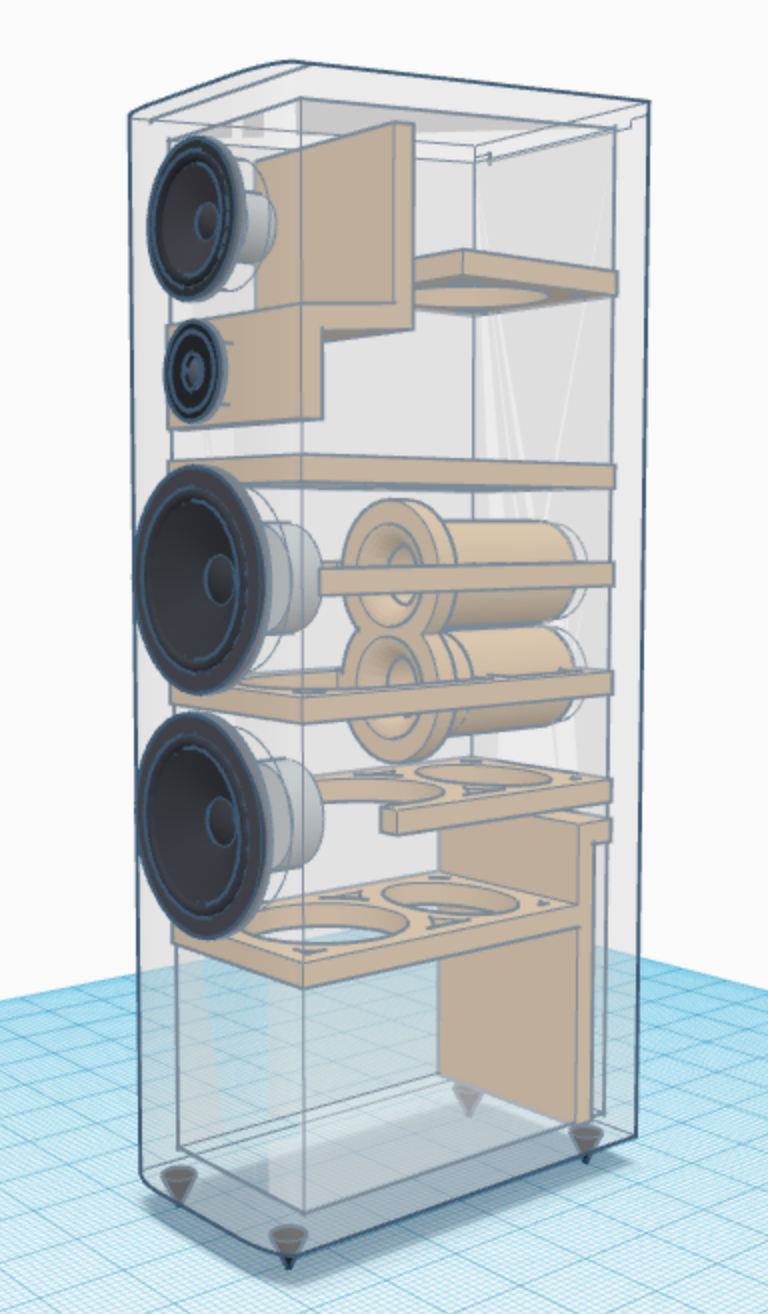

I have a robotic mil to my disposal so effort isn't a factor. I have more than enough money to buy a plastic port but I don't because they don't meet the kind of build quality I want my speakers to be and a piece of plastic seems kind of cheap and ugly to me. I'm going to use MDF ports because they will be very stiff and won't vibrate nearly as much as a plastic port will. Also they are easier to adjust during tuning.
The volume of the midrange is right. I've calculated the optimal volume and because it's a midrange it will only need a very small chamber. I might look into the shap though.

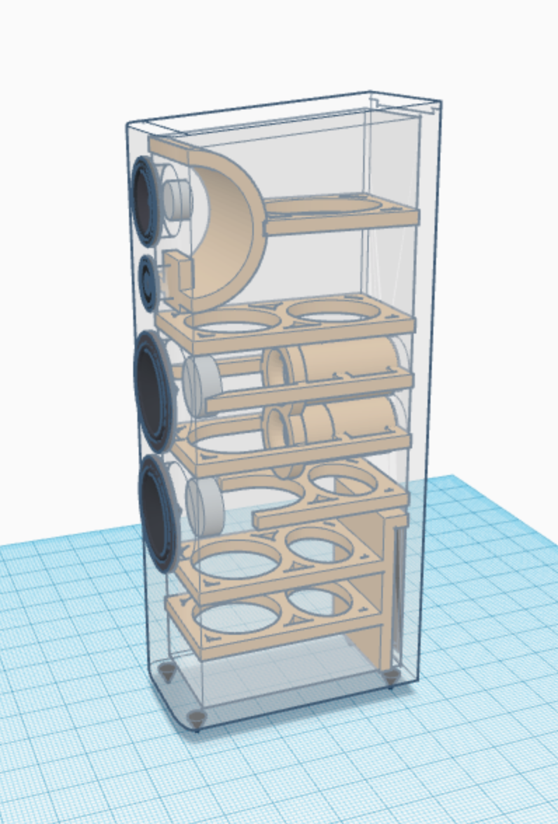

I've made the midrange chamber round and improved the bracing at the same time by connecting it to the wall of the midrange chamber making it even stiffer all together. I've also asked Frank Nielsen and Ulrik Schmidt themselves what they think is the optimal size for the midrange chamber, even though I think 6 L is about right. The drivers are on their way as well.
^Perhaps just an oblique divider - it makes the chamber triangular which helps to kill internal reflections better, and is much easier to make!

I'll add some bracing to the top wall.
How do you mean it won't make any positive changes? Do you think it will be worse? Why would a stiff and rigid port not be a good thing? And if it doesn't have any negative effects I think I'll stick with it because I like the quality it suggests and I kind of like my idea of tuning it by adding rings to increase or decrease the length of the port.
What will be a better shape for the midrange chamber then? I know something of the shape like the Bowers & Wilkins "head" is best and I was already drawing something like it just to see what it would look like but something like that is impossible to make. Making it by stacking rings of different diameters won't be a good way to make it because the flat surface of the differences in diameter of the rings will act like a flat wall.
