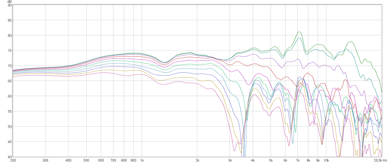

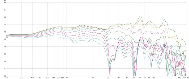

Regarding front baffle, mid on top is the right choice. The baffle fills in the dip around 1300Hz, see comparison of MR16 response (horizontal 0-90deg) for MT and TM configurations. But, in my case, tweeter response for MT configuration was much worse, and with LR2/LR2 the modelled FR was worse. That is why I went with TM configuration. In your case, large (~R50) baffle roundovers around tweeter should help.

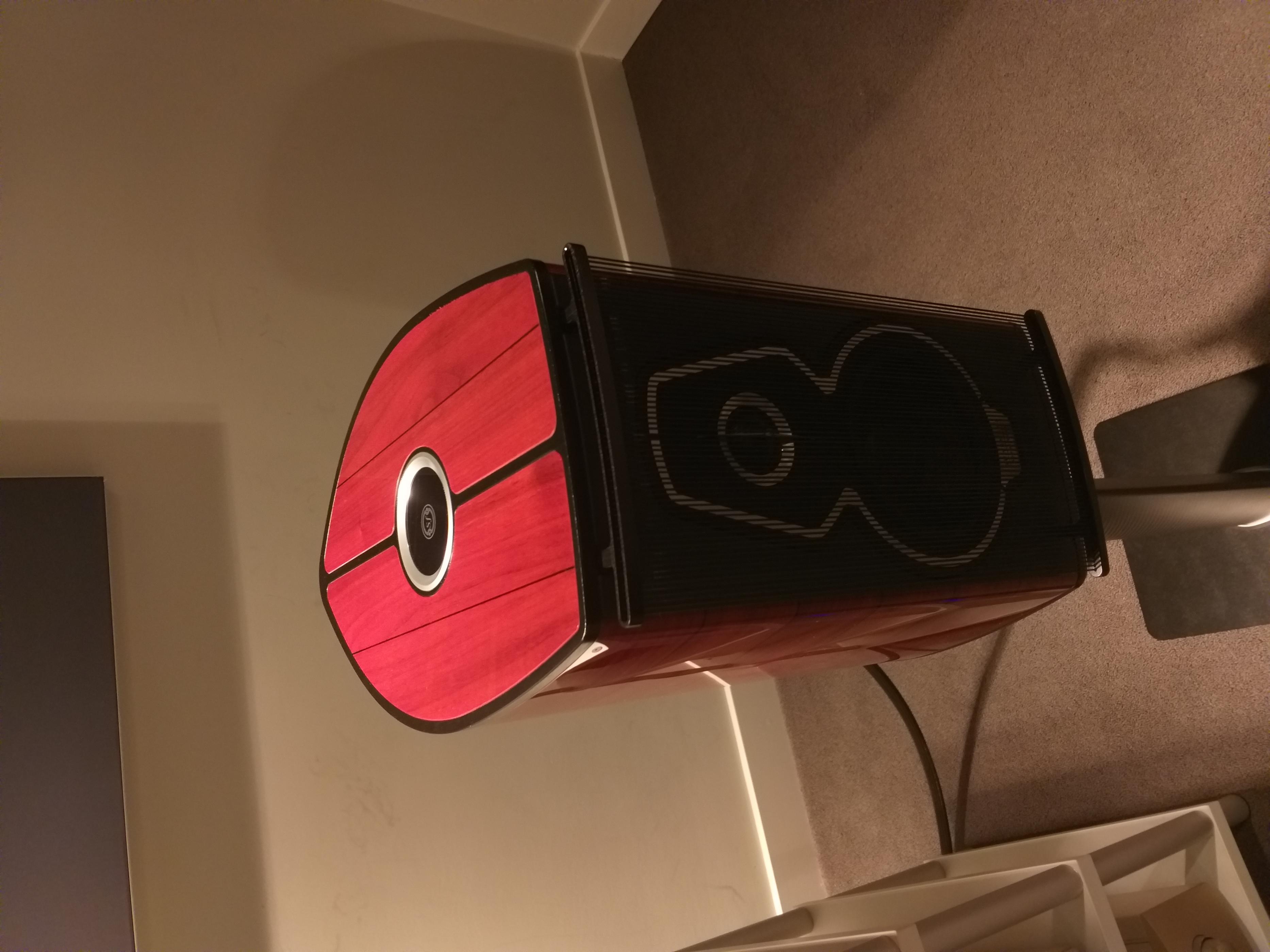

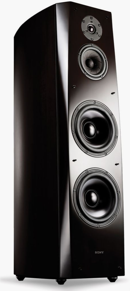

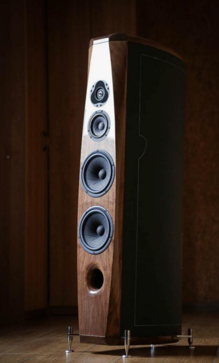

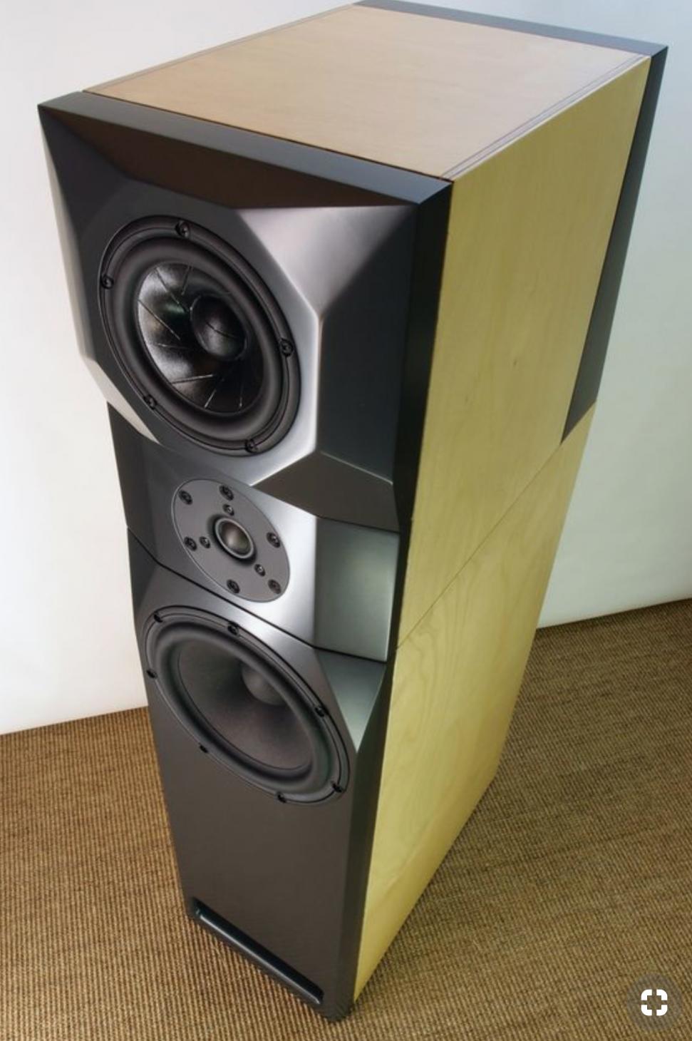

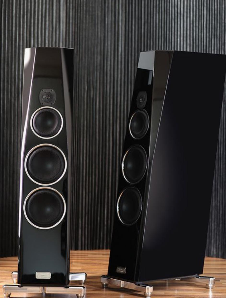

I have been thinking a lot about how to make the cabs look beautiful recently because even though I at first really liked my design when I was basing it very strictly on the Kroma Audio Carmen but now with the flat top I'm finding it hard to make it look beautiful. I already started to more take inspiration from the Magico M Project but as I was scrolling around on Pinterest a lot the last few days I kind of fell in love with the look af those angled baffles/edges like on the pictures below. At first I wasn't really attracted to it but now that I have seen pictures of some speakers that have it well implemented I find it very beautiful. I'm gonna try to angle the cab and use such shapes on the baffle but that does mean the tweeter will have to be on top which only has acoustical advantages because ultimately you want the motors of the drivers to be on the same line for time alignment which is why many of Troels Gravesen's design have the piece of baffle for the mid stick out further. If I mount the tweeter on top, then the midrange and then the woofers and angle the I will have the same result. And those slanted edges are the best for frequency response according to the article about the affect of the shape of baffles someone posted earlier.
Drawing this in Tinkercad will be to difficult so I won't have 3D models but I'll do some drawing.
Thoughts?
Thoughts?

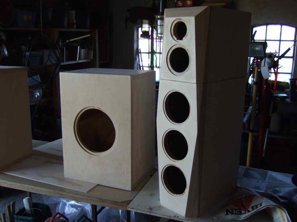

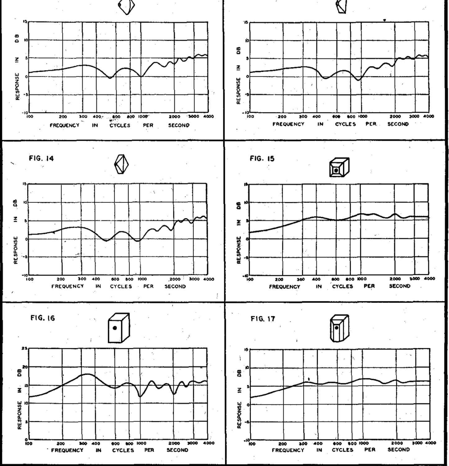

I have also found that making baffle where diffraction issues are handled properly is VERY important.
Read this for a nice explanation - And it still holds true:
http://www.dwdrums.com/images/moonmic/olson_direct-radiator-loudspeaker-enclosures.pdf
This article. The bottom right one represents the kind of design I with the slanted edges and it seems to show one of the best responses.
That's also why I shaped my cabinets like this 🙂This article. The bottom right one represents the kind of design I with the slanted edges and it seems to show one of the best responses.
I use an Seas Magnum tweeter and a Accuton C82T8 - works great in an avalon shaped cabinet.
Thank you 🙂 . This is the pictures from when I build them years ago - they are made from 30mm birch tree.
First I had morel Supreme ST1108 as tweeter, but later found that the seas fitted better, as one of the only ones that has the same slightly bigger diameter. Also I believe that a hard dome tweeter sounds better with a ceramic midrange - because I can control the breakup nicely with my DSP. The old Accuton had a big breakup at 4800hz, but I cross at 2200hz and EQ within the pass-band before adding the filter - great clarity/clean sound and "snap" in these old drivers.
The three woofers are 18W8545K - operating from 90 to 400hz. The subwoofer are XXLS 830952 - and later I have added 2 ekstra subs - so that the sum of the four subs gives me around +/-4dB from 20 - 90hz in and around the listening area.
