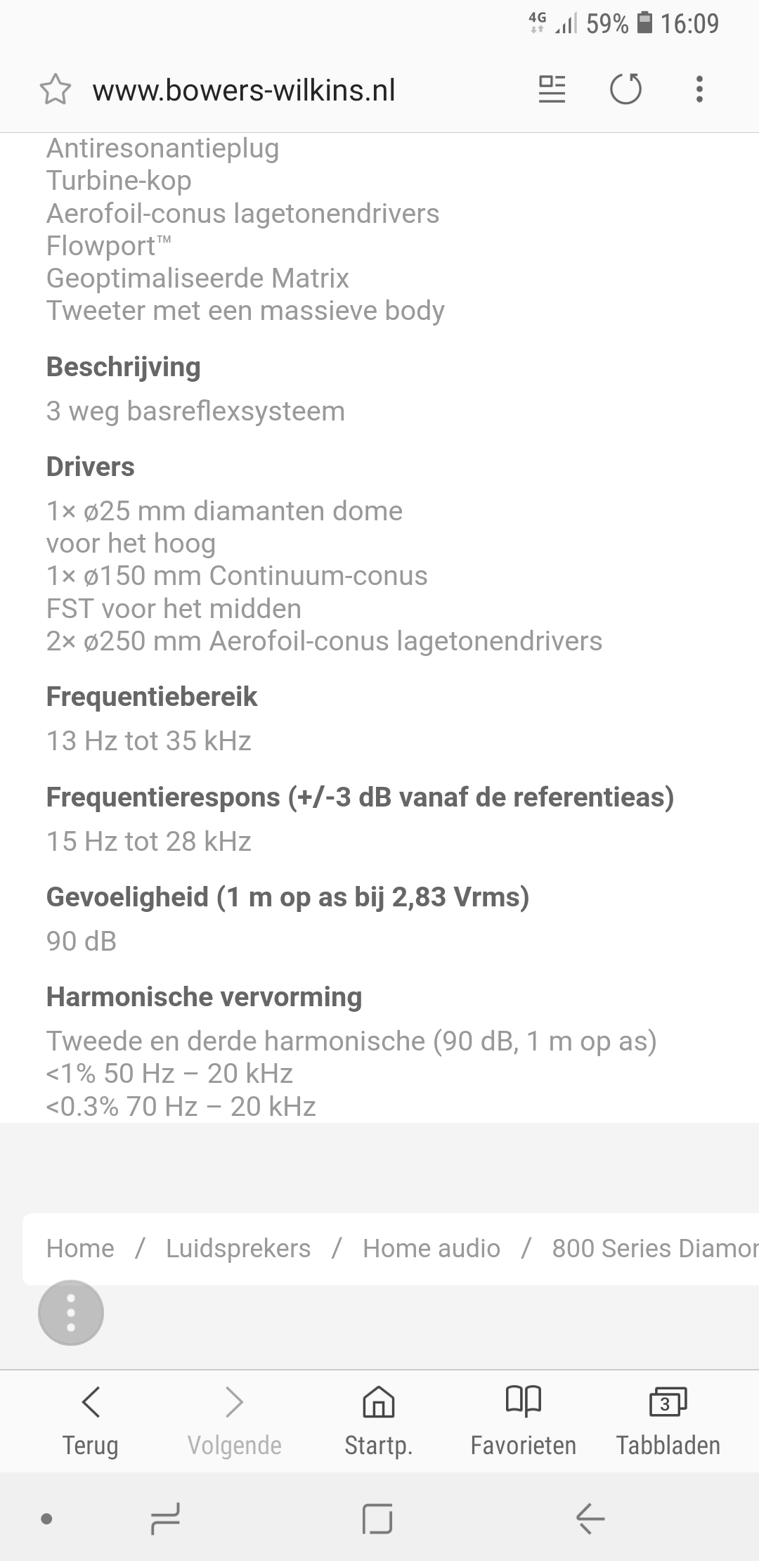

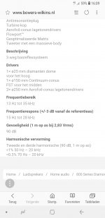

I'm not disappointed about the likely performance of my WO24P-8's but than I just wonder. How do good branded speakers like 800 D3 go as low as they go to like 20 Hz. That makes it even more impressive.
They don't. Or go to 20Hz for F10. F3 20Hz with any reasonable sensitivity, even with 2 woofers........not real.
I do not trust them at all. Unless they use any kind of boost on passive level. D2 specs:
Frequency response: 32Hz–28kHz, ±3dB on reference axis
Double 10" woofer. This looks more realistic.
B&W 800 Diamond loudspeaker Specifications | Stereophile.com
I do not trust them at all. D2 specs:
Ahahhh. That makes me more satisfied.
I think Bowers & Wilkins is a bit optimistic about the bass response of their products. They also claim their DB1D dual 12" sealed sub to have an F3 of 10 Hz. That one I doubt the worst.

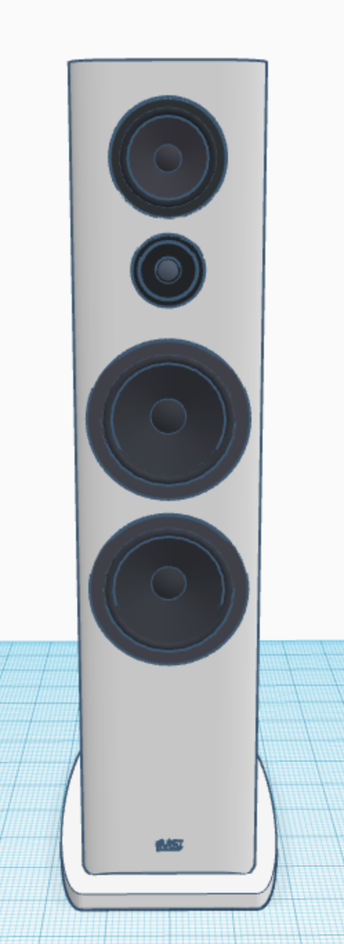

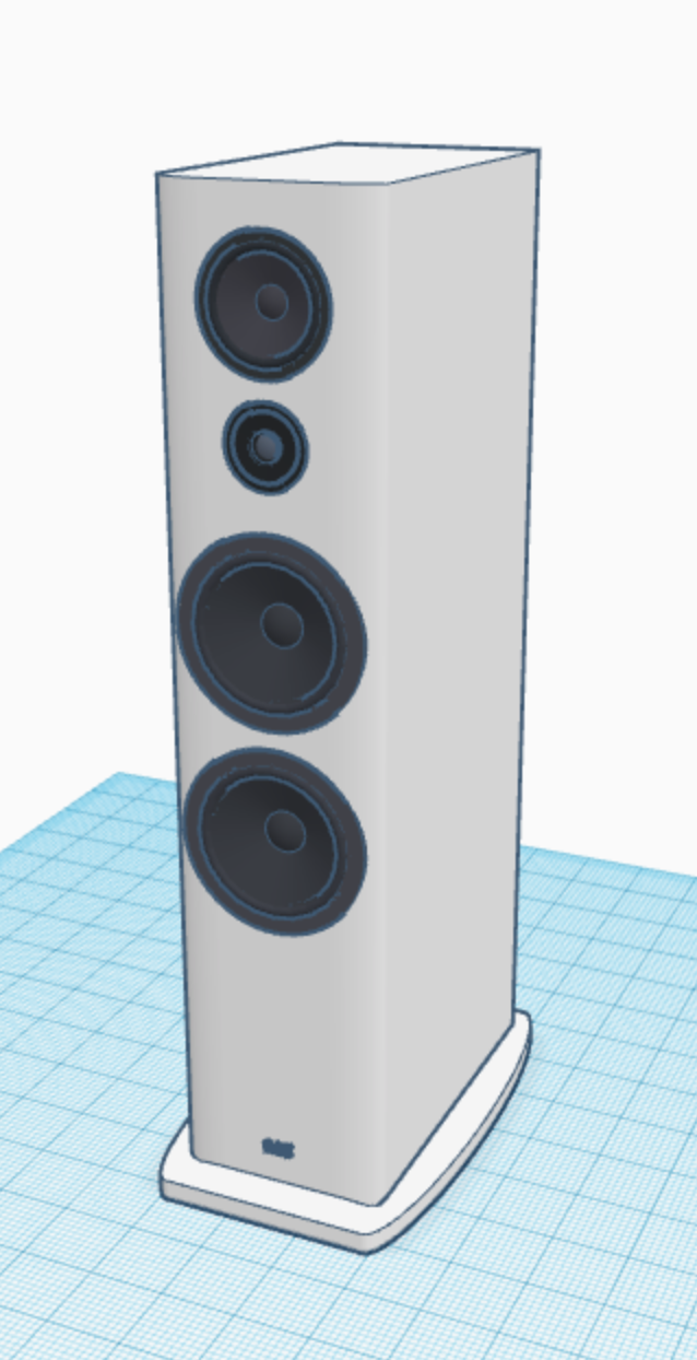

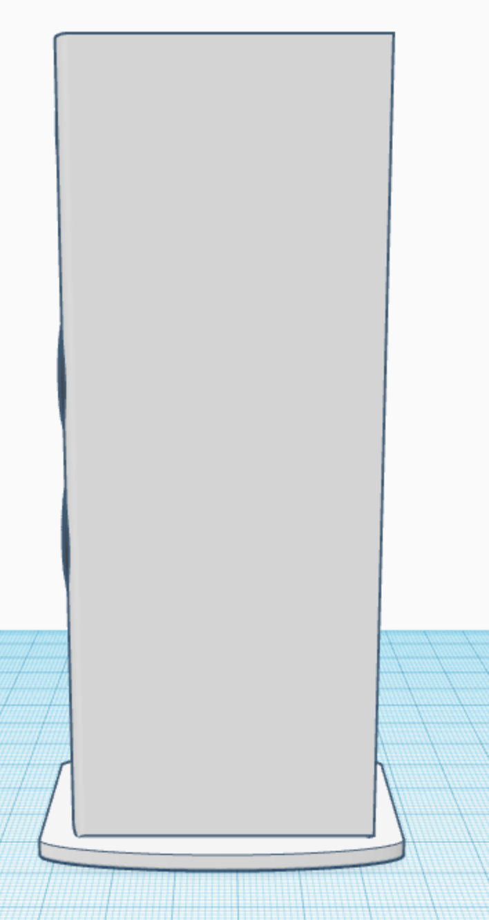

About the cabinet. I adjusted it again. Instead of the slanted top it now has a normal flat top. This because the slanted top wouldn't really have any acoustical effect but making the top flat saves a few litres of volume which again gives me about half a Hertz lower bass and is wayyy easier to build. Way easier. And it actually has an acoustical advantage. With the flat top I can round the top edges for reduced diffraction (not on picture). I didn't even consider that with the slanted top because it would be outrageously ugly. With the flat top I think rounded edges actually look a little better. Like the Magico M Project. I put the tweeter in the midrange chamber which also saves one and a half litre of volume for the woofers. Also the internal structure and bracing is way simpler with the flat top. The angle of the top would take 5 cm from bottom to top. So now that the baffle is 5 cm longer I can place the top of the array of drivers, the midrange, 5 cm from the top edge instead of 2,5 cm but in total the array is still placed 2,5 cm higher than with the slanted top for again better controlled diffraction and a higher acoustical centre which is nice for someone who's 1,94 m and growing.

I must say I dont understand what you actually want. On page 23 you write that you dont have time to build multiple speakers. If you dont want to actually learn how to DIY, why even bother?
If you dont want to, then DIY from scratch is NOT where you get most for your money AND/OR best sound. Plenty of good speakers on the second hand market. You just saved 500 hours....
Letting other to simulate a crossover and hoping it will work is like winning the lottery. With your cabinet you can forget all about LR12 filters btw.
