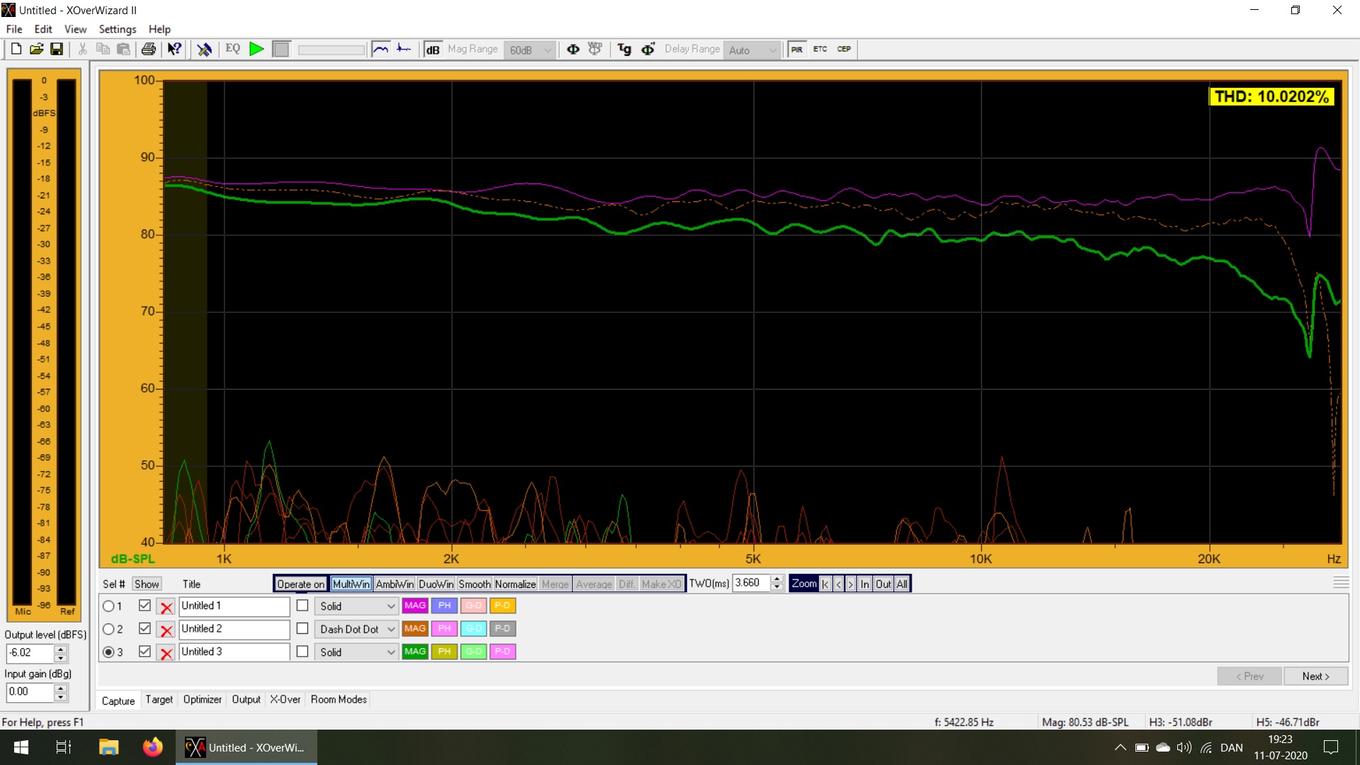

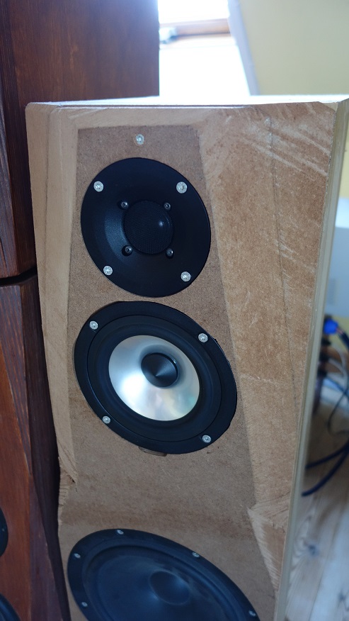

I will measure it in a baffle with cuts like these:
DXT-MON | 5 ″ 1 ″ | Near field monitor | Compact speaker
Then I will find out how each driver works, where it can be crossed and where I get the best result.
That looks like a very nice and simple design - but still with great results and possibility for finetuning 🙂🙂I found this, and it suggests pretty good TA with a small woofer with phase plug (like my M13).. www.audioexcite.com >> Prestigious Two – Monitor DXT
Well, I have done some quick tests with the XT + WG.
First with a 90deg diy WG in a piece of 16mm MDF. I filled the gap with some 'goo' to get it sealed to the faceplate and the correct shape closest to the dome. It looked ok except a pretty sharp peak around 2,5k. I tried a bigger roundover from the 'horn' to the baffle surface, but that did not do much.
Then I tried to mount it on the Visaton WG. Removed the faceplate, and used even more goo to seal and shape the gap. This was not a hit either. Top end was flat (no boost) from WG, and below abt 4,5k there was a big bump from the WG. not easy to EQ in XO. Maybe because it was monted too deep, I don't know.

Top end will never get any boost, the peaks lower like 2.5kHz is more likely why you have a bad result. it takes a lot of equalising to get rid of harshness...
Yes I know, the disappointment in this test was that the boost from the wave guide was abrupt, and not a smooth rise easy to compensate in the XO. I did not use the WG combination, I only did a quick test to see if it would be feasible.

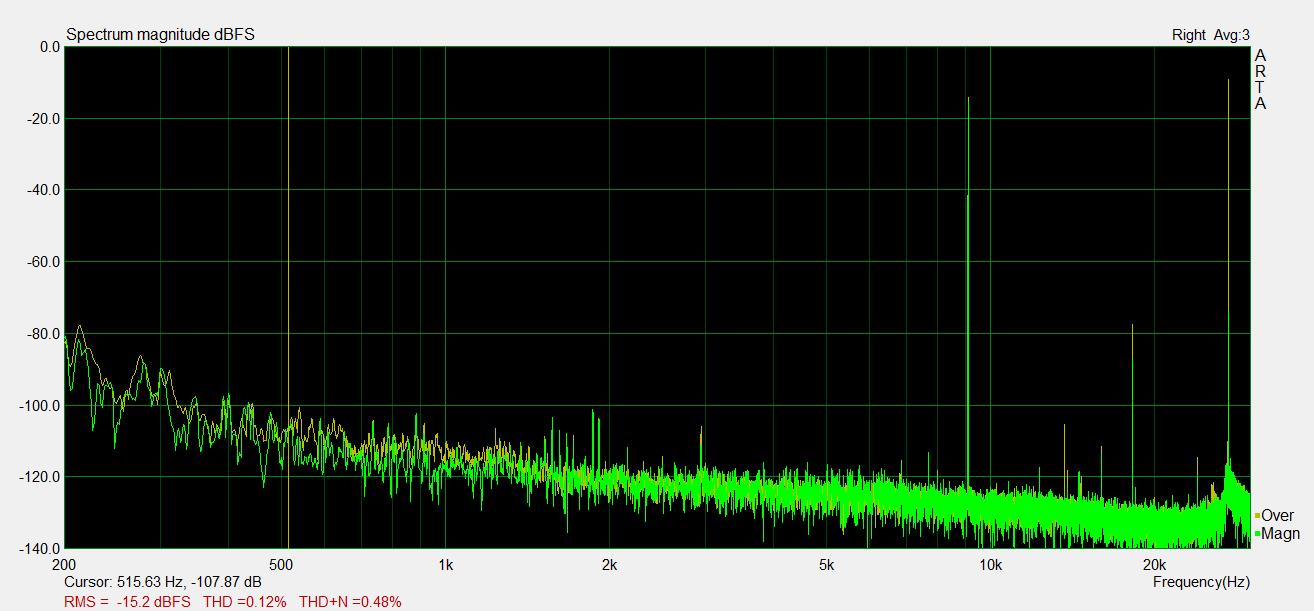

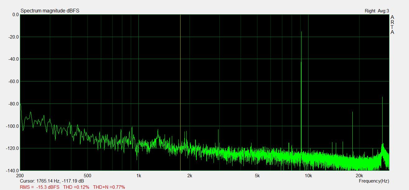

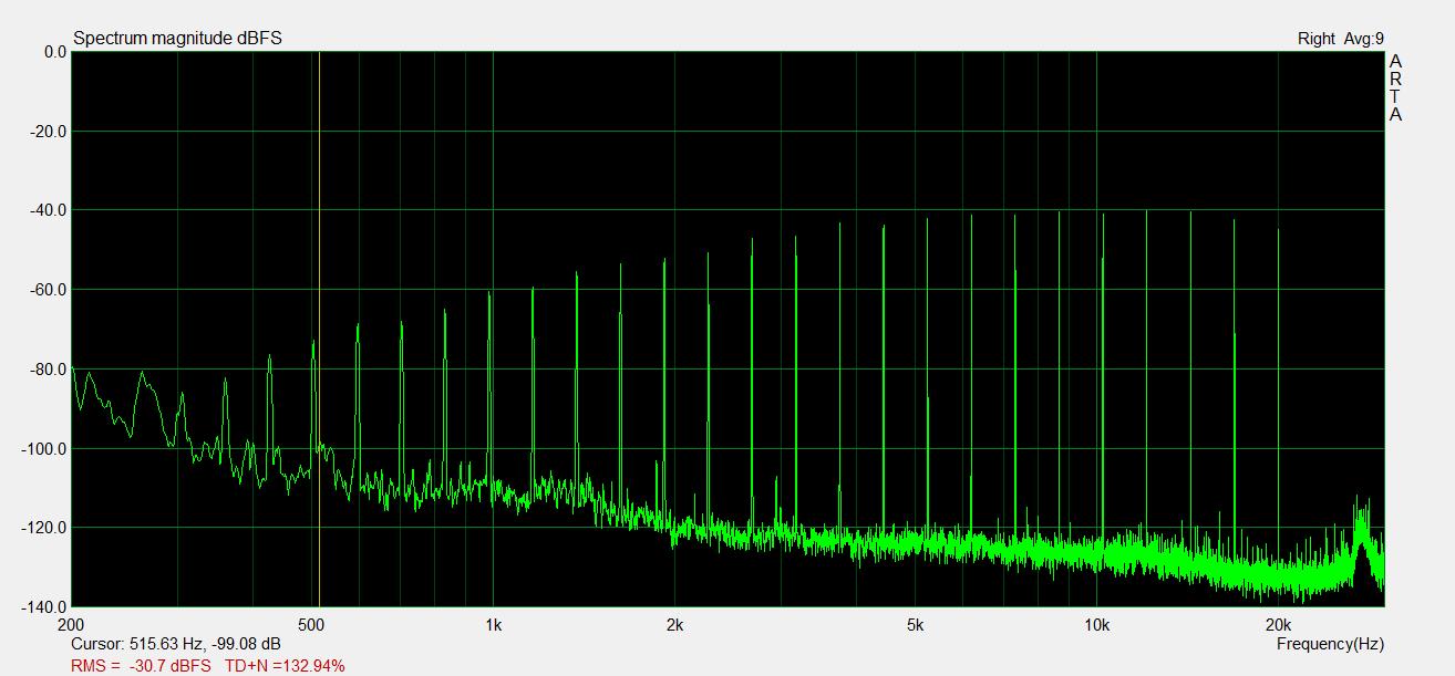

I did some measurements on the DXT with dual tones watching the FFT, and there was significant IMD in the audible range if there was a 27kHz tone (dome resonance) combined with an audible tone. So, I definitely don't want to feed extra noise in the 20k+ range to the tweeter.

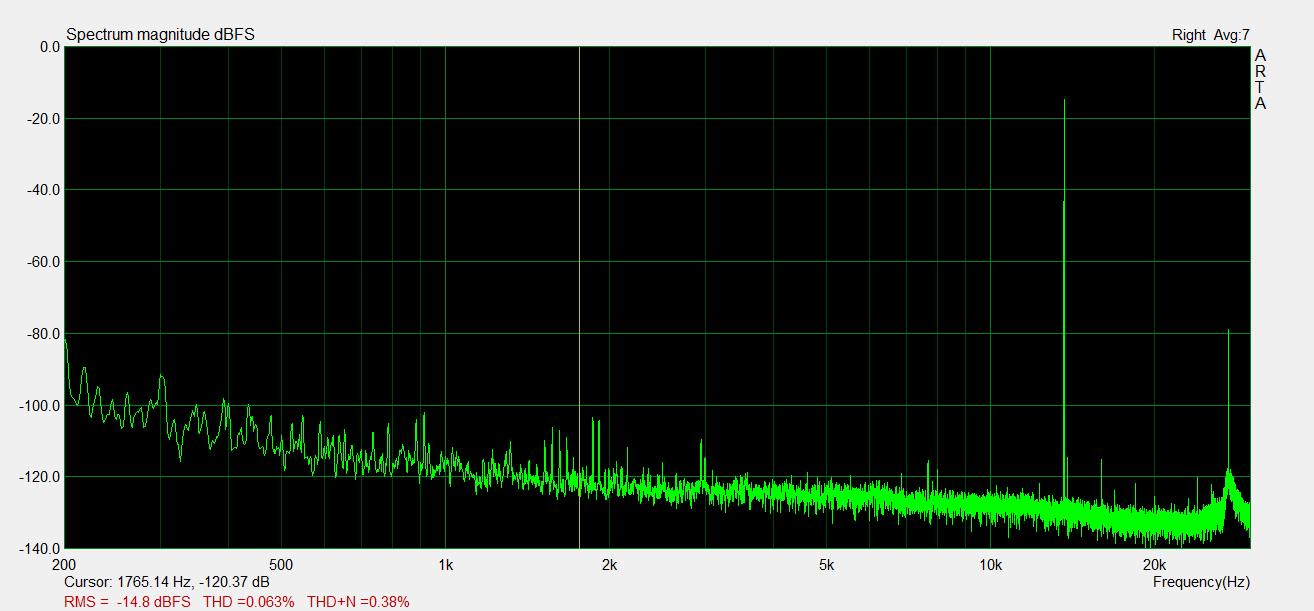

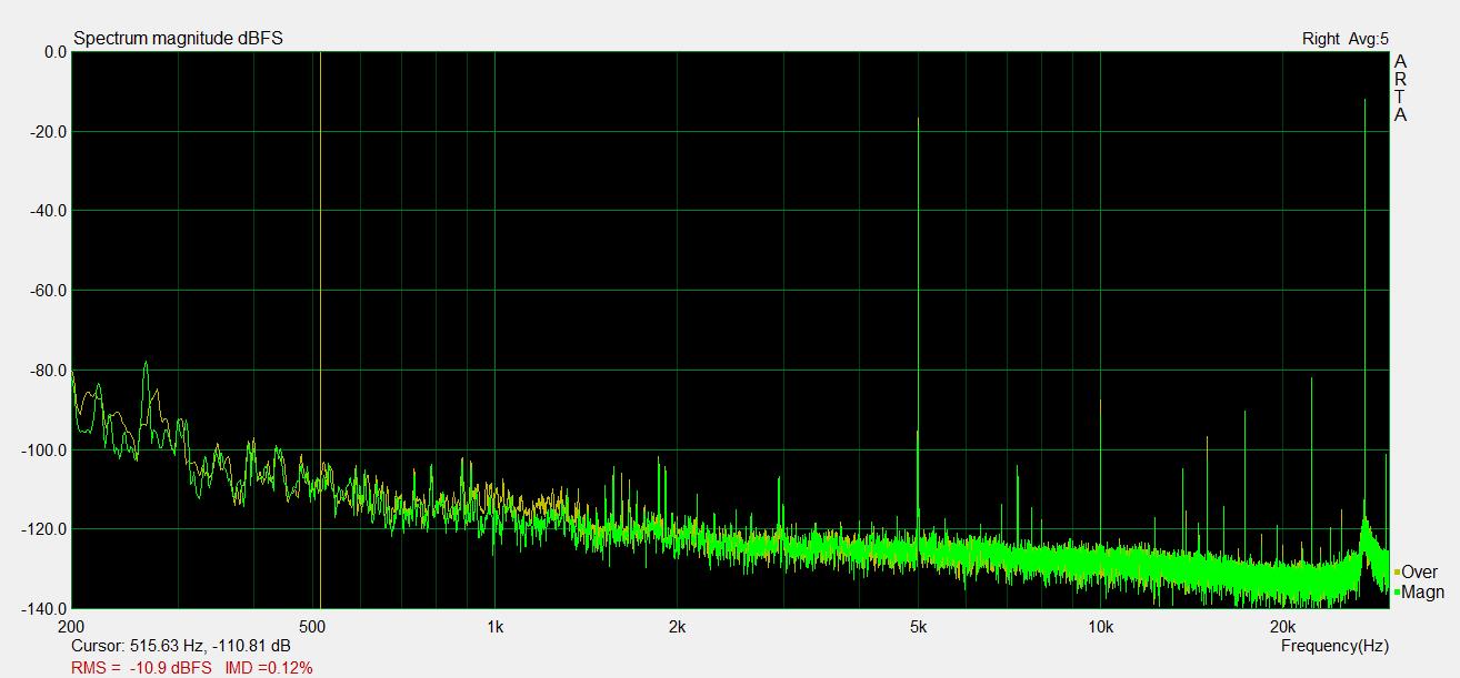

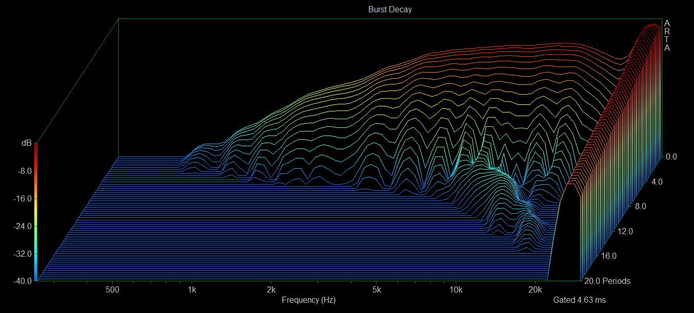

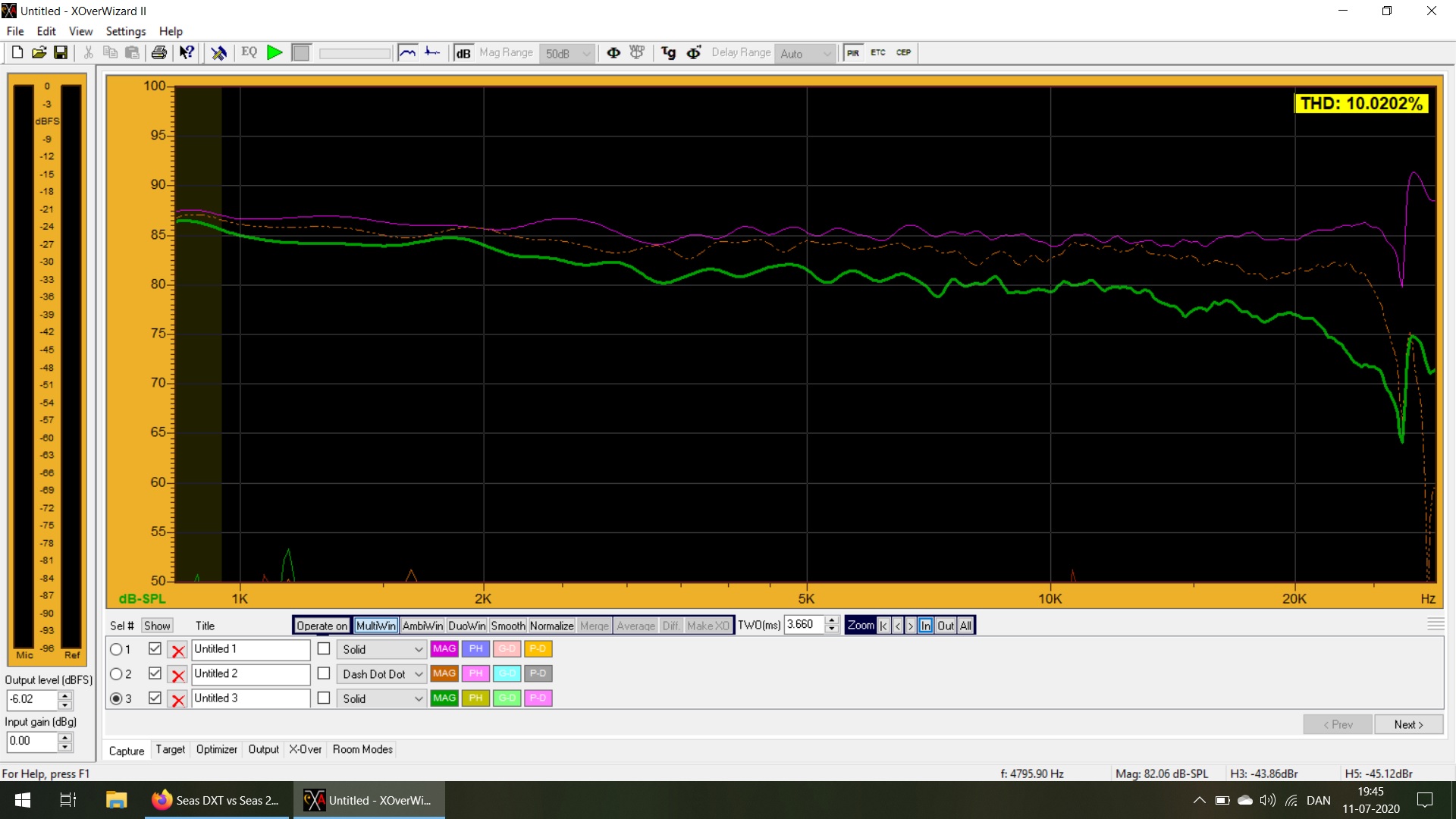

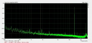

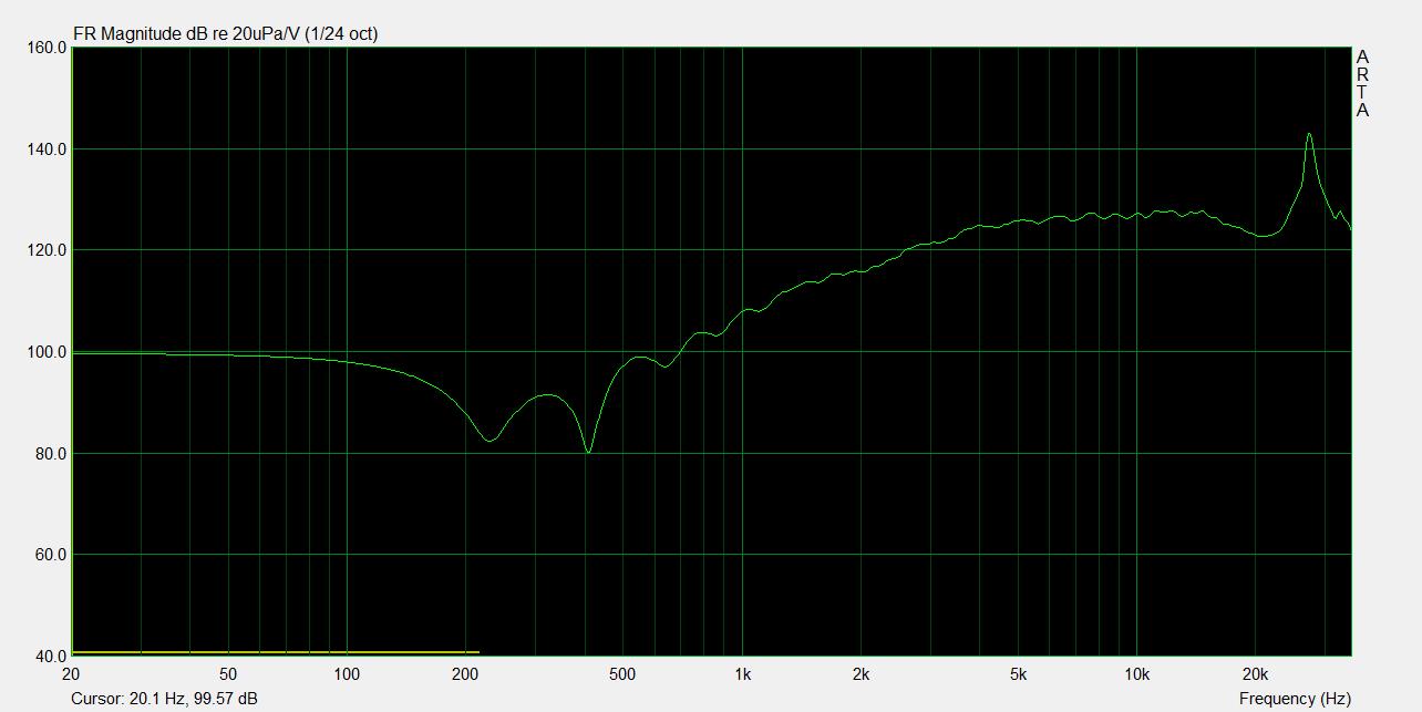

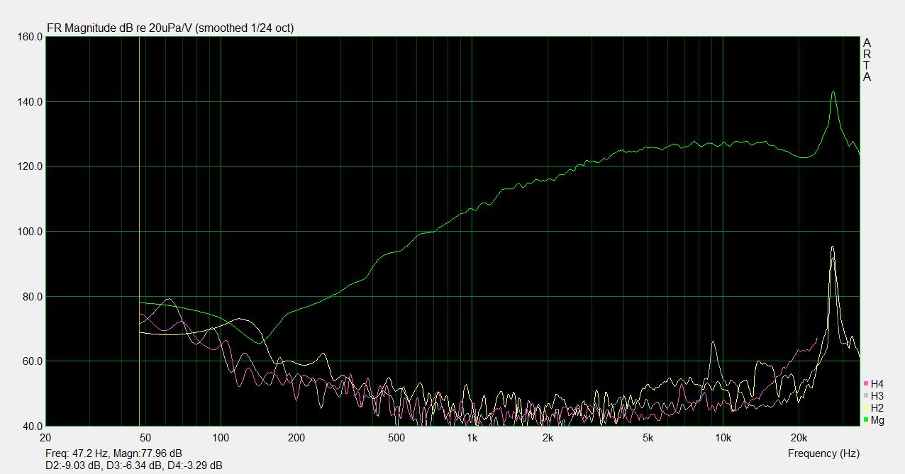

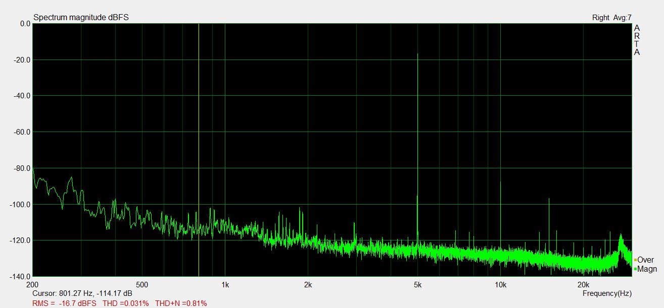

Seas DXT measurements

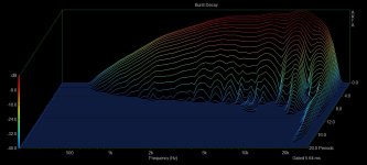

I did some measurements on the DXT tweeter. I measured it at abt 15cm distance in the speaker with my XO connected. Same source as when I listen to music. SPL is not calibrated, all I can say is that it's abt normal listening level (not so loud). A few averages per FFT. I did the frequencies that have 2nd and 3rd harmonics at the 27,3kHz dome resonance to see how it behaved too.
I really don't see much wrong with it from a measurement point of view. Some delays in the decay (ok, and one huge 🙂 ) Suggestions on other measurements?
Oh, and on the subjective side, it seems to please my ears more if I notch it around 10k (in the PC). Maybe the resonances seen in the decay?
Can you elaborate on that a little?
It looks to me that a notch would not matter as long as the input signal is free of 27kHz content? In the measurements I was running at 192k sample rate, and exciting the resonance, but with music I run 44kHz and there is nothing to excite the 27k peak. I actually don't worry too much about anything over 12k, since I won't hear it anyway..
Even with the resonance excited by 2nd & 3rd harmonics in the tweeter, it does not seem to reflect much back into the audible range. But in this case a notch should not make any difference.
I've somehow missed the part where you wrote sr of your music, i agree - if you are using 44kHz music, the notch is not needed since the resonance will never be excited. Similar to D&D.
