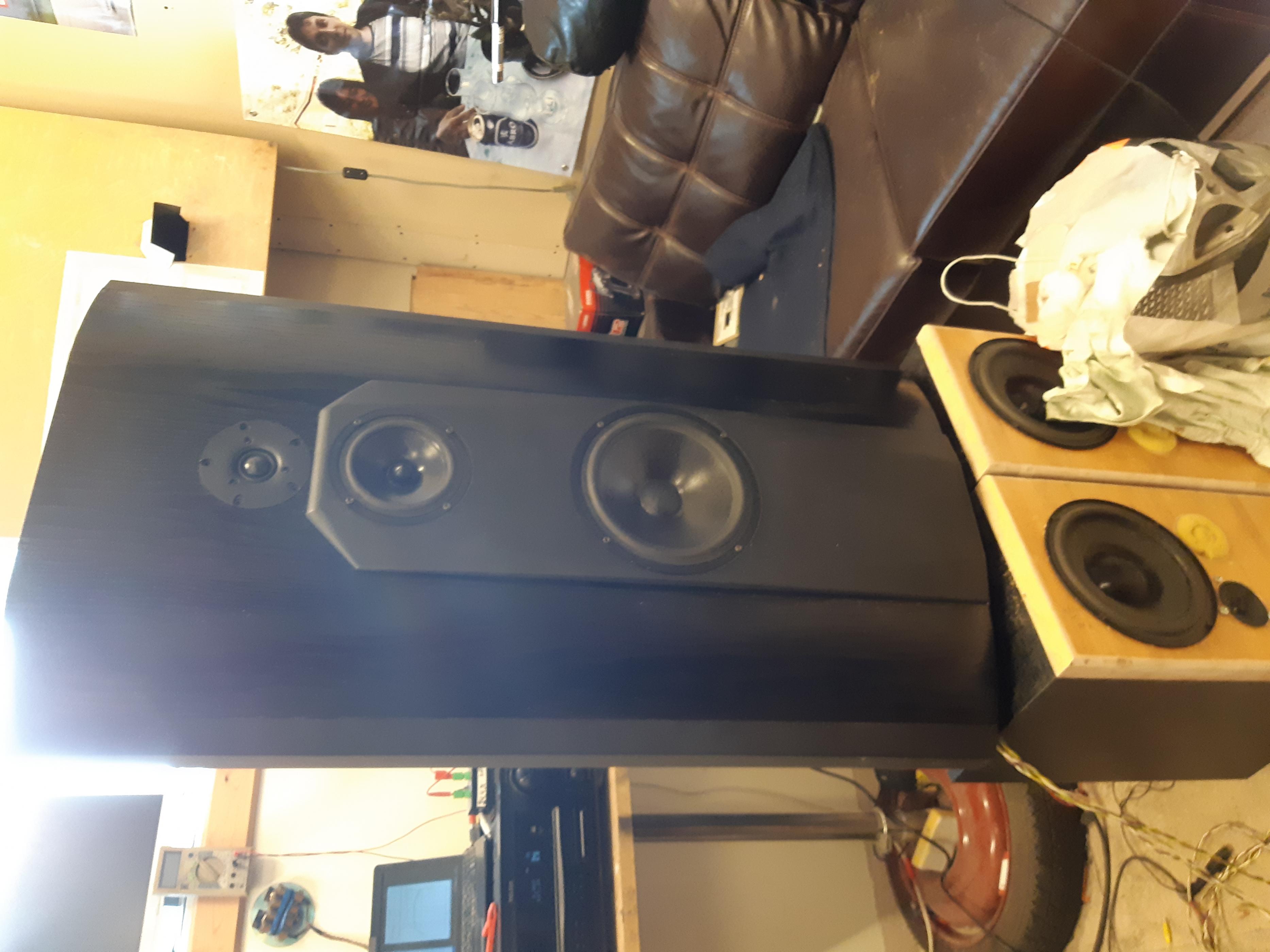

I have a similar 'problem' choosing tweeter for a build. It's a build inspired by Troels PMS, so a wide rounded baffle. (garage pic attached)
They are under construction, and I'm running them with a stepped baffle to get time alignment to a Peerless DX25 dome tweeter, but the extra baffle for M13 mid and M21 woofer screws up the FR response of the mid and tweeter, and most likely the whole idea of the wide baffle (for mid), so I'm thinking I have to go back to mounting the mid flush with the baffle, and I would like to WG the tweeter instead to get more treble directivity and keep the time alignment with the mid. Aiming to XO LR2 at 2-3kHz.
I have two main candidates:
Seas 27TBCD/GB-DXT
+fits the hole in the baffle
+seems popular and measures pretty good
-a little bit expensive(almost double)
-seems to need some extra work in XO to straighten the FR
Seas Noferro-900 + Visaton Waveguide WG-148R
+Tweeter is not expensive and I have the waveguides as leftovers from before
+Measures really good in the baffle used for testing
-could not find more info about this combination
-seems nobody built any well documented project with this combo
-Needs new hole in the baffle, so there is no going back if I mount them
-Maybe a negative point for looks compared to the DXT 😉
Ref to both tested by Heissmann Acoustics: Heissmann-Acoustics | Tweeter with Waveguide | reviews
However, it's a bit unclear how these will behave on the wide curved baffle. It's been mentioned that the baffle has a significant influence, and I found measurements of them on infinite baffle and narrow baffle. Very hard to estimate if the tweeter will 'see' a 22cm (flat center part) wide baffle, or the full with, or something in between..
Heissmann seems to have used the DXT in many projects, but not the 900+WG, even if the later seems to measure better IMHO.
Any input, experiences, or suggestions of other suitable tweeters would be appreciated!

Just to answer my own question, after some reading and guesswork I took a chance and ordered the 27TDFC, and I will try it with the WG148-R. I was looking at the no FF version 27TDC, but I guess I can clean out the FF in case I'm not happy with this one.
I like the bigger chamber and lower resonance frequency of these (compared to the 900 mentioned before), even if I'm not planning to XO very low. Could give me the possibility to try 1:st order XO too.
I don't believe that 27TDFC in an improvement over DX25, quite the opposite. But that's just my subjective opinion. Heissman measured DX25 in Monacor WG300 and it behaves very good. If this is to big waveguide for you, i'd hire some company to make me a smaller diameter wg following the Monacor WG300 curve. Or WG300 can be just trimmed to a certain diameter and you can use Hessman's adapter plate.

I did the same (27TDFC and WG148-R). To mount the 27TDFC all you need to do is enlarge the 27TDFC mounting holes by 2-3 mm and the holes will align with the WG148-R holes. I also put some thin gasket material around the WG148-R cutout to seal any possible leaks. I initially tried LR4 @ 2KHz, but after a lot of testing and listening ended up at LR4 @ 2.5 KHz.
I have used the DX25 in the WG300 before(based on Heissmann measurements) in another speaker, but there is something about the treble of the DX25 I don't like. I still don't like it much without the waveguide either, so it was time to try another tweeter. I also suspect the WG300 is too deep to align well with the M13 mid.
After I replaced the DX25 with a XT25 in the WG300, everything was fine.

Well, the 27TFFC + wg148r was a fail. I don't have space for a bigger diameter in the box. Tweeters have now been returned to the kind seller.
There is only room for the diameter of the magnet assembly in the box (collision with mid box). There is room for a bigger face plate though.
This means the DXT would be a good fit mechanically, but I'm hesitating.. Looking at the DXT and some designs I have found, they don't seem so deep that they would time align with the mid. XO's often seem to be higher order on the DXT to align phase with mid/woofer.

@Rallyfinnen
Look at the WG300 instead... it seems to have way more options than the WG148R - which I also bought and tried with 3 different tweeters, but did not find any good use for.
I ordered the DXT and is waiting for it to come - hopefully tomorrow, so that I can play with it this weekend.
Time allign....? I just delay the thing in my DSP - done 😀
I do have a pair of WG300's in their boxes, but not for this..
These tweeters will be paired with M13 mids, so the WG300 is a bit over sized I think. Too large diameter for looks, and most likely too deep for time alignment. I don't want to go active with these. I thought the WG148 would fit the bill, but failed due to space issues. What will you use the DXT with? Would be interesting to know the delay you get to align it, assuming you use symmetrical XO. (Just put a symmetrical filter on mid & DXT, run them out of phase, and adjust the delay until you get the deepest null with mic between tweet & mid centers)
I found this, and it suggests pretty good TA with a small woofer with phase plug (like my M13).. www.audioexcite.com >> Prestigious Two – Monitor DXT
