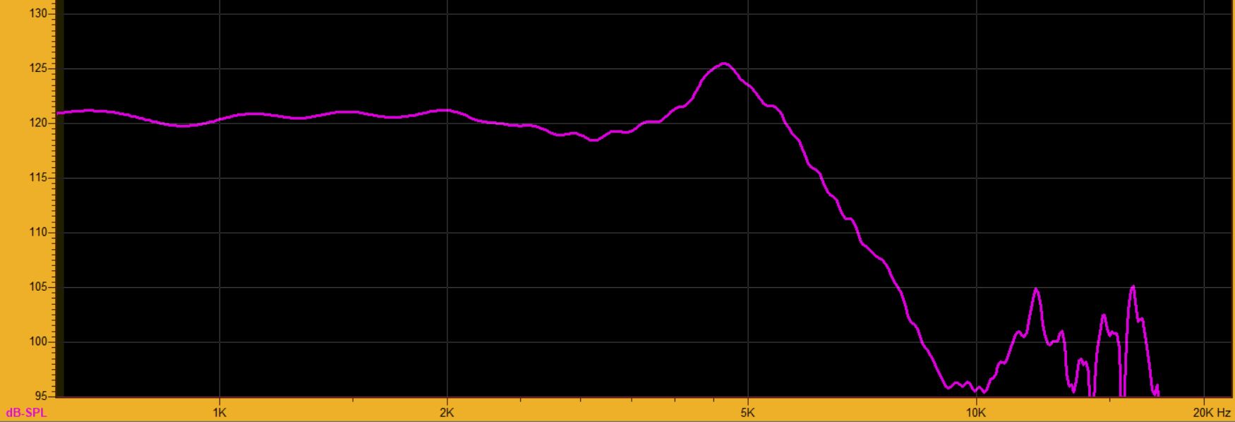

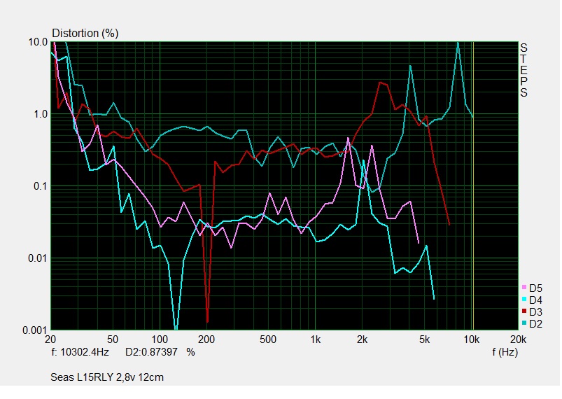

Seas DXT measurements
I did some measurements on the DXT tweeter. I measured it at abt 15cm distance in the speaker with my XO connected. Same source as when I listen to music. SPL is not calibrated, all I can say is that it's abt normal listening level (not so loud). A few averages per FFT. I did the frequencies that have 2nd and 3rd harmonics at the 27,3kHz dome resonance to see how it behaved too.
I really don't see much wrong with it from a measurement point of view. Some delays in the decay (ok, and one huge ) Suggestions on other measurements?
Oh, and on the subjective side, it seems to please my ears more if I notch it around 10k (in the PC). Maybe the resonances seen in the decay?

Can you elaborate on that a little?
It looks to me that a notch would not matter as long as the input signal is free of 27kHz content? In the measurements I was running at 192k sample rate, and exciting the resonance, but with music I run 44kHz and there is nothing to excite the 27k peak. I actually don't worry too much about anything over 12k, since I won't hear it anyway..
Even with the resonance excited by 2nd & 3rd harmonics in the tweeter, it does not seem to reflect much back into the audible range. But in this case a notch should not make any difference.
