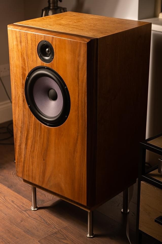

two port 58x150mm (60mm PVC tube), the box is 720x460x310mm the base box made 20mm MDF but added a "extra" front was made in 19mm Baltic birch, Between the front MDF and birch put 2mm rubber sheet, glued as a sandwitch.
Very nice clone! Thanks for sharing, everyoneMay it help:
I bulid a O96? clone AR26(magnet add+ DIY phase plug) + Morel378
The XOver is relative simple, the sound is comparable my AN E Silver Hemp

Is the rubber sheet to dampen potential resonance?Thanks,

Yes the middle frequency, I try to copied as close as possible,Is the rubber sheet to dampen potential resonance?
Thank you so much i do see that now. My 3/4" birch arrived today and I plan on building this over the next few weeks. wondering if you had any photos of previous builds, either using the cat 378, or not. the arrangement of the braces is a bit confusing to me. also is there a way to donate so I can contribute for your open source plans?The document i created has alternate tweeter XOs i found, i think one of them is the Morel. Don’t have time right now to chase that thot.

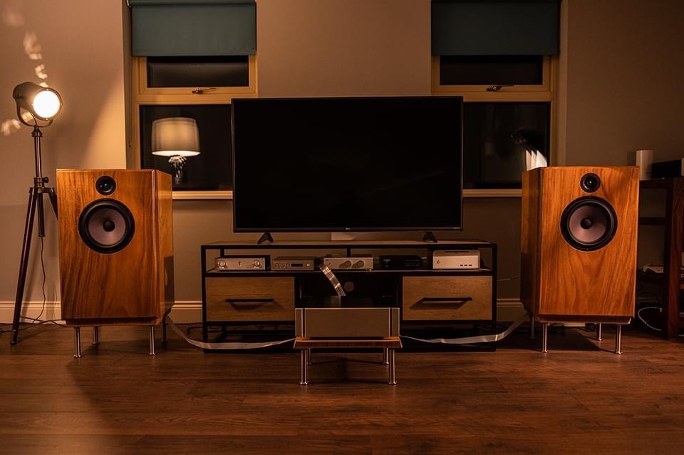

I'm listening to the T35C now and... it's a killer tweeter that digs very low. The problem is they are over $200 each and one could also argue that the cat378 might have slightly better time alignment. Tradeoffs...
I'm having some stands made now for my A26 that will tilt back a few degrees for better time alignment and maybe I'll eventually go active with linear phase and time aligned crossovers.
