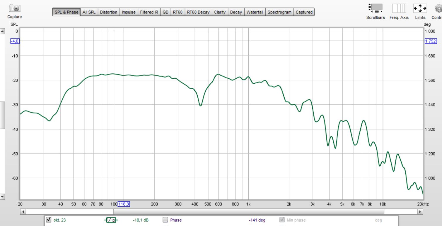

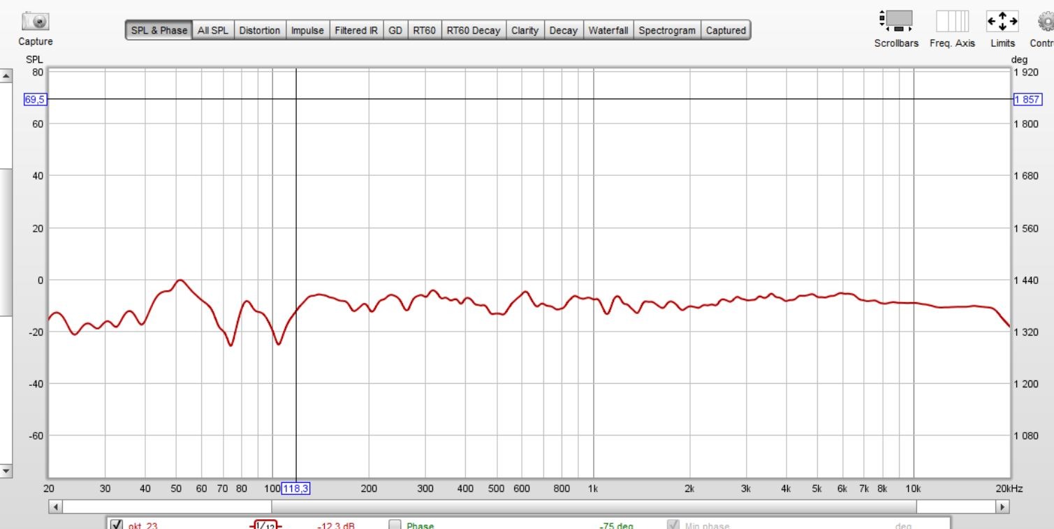

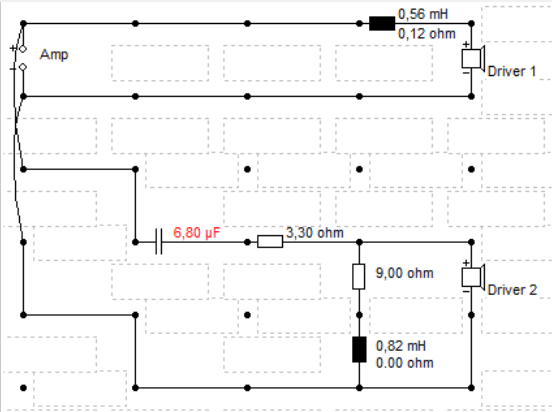

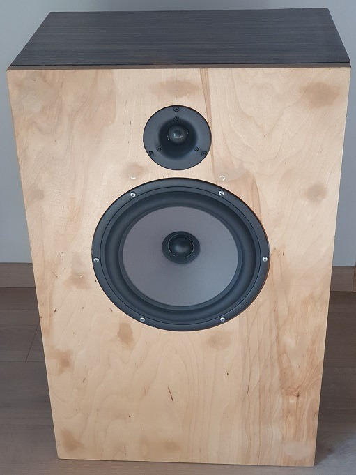

I bulid a O96? clone AR26(magnet add+ DIY phase plug) + Morel378
The XOver is relative simple, the sound is comparable my AN E Silver Hemp
1m distance in room (REW)

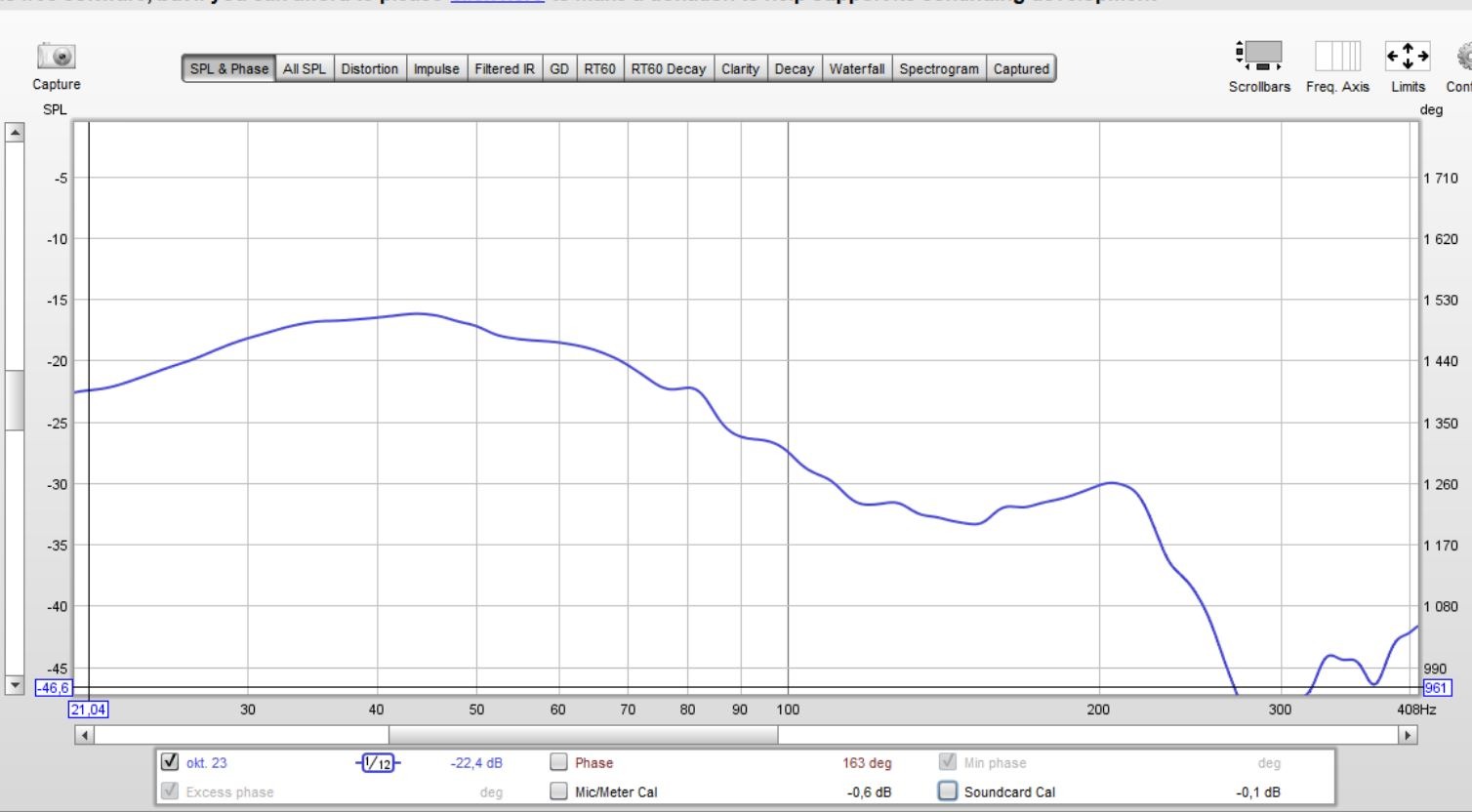

1cm in the reflex port
1cm from the bass port

May it help:
View attachment 1007523View attachment 1007524
1cm in the reflex portView attachment 1007528
This is extremely bad ***. Can you share more about your speaker modifications and port design?

If it bad why share it? One correction the the bottom graph is 1cm from the bass driver not the bass port,Love your posts on this. How do you like that B102-Cat378 after a while? Would you still go with the B102 over A26RE4?
