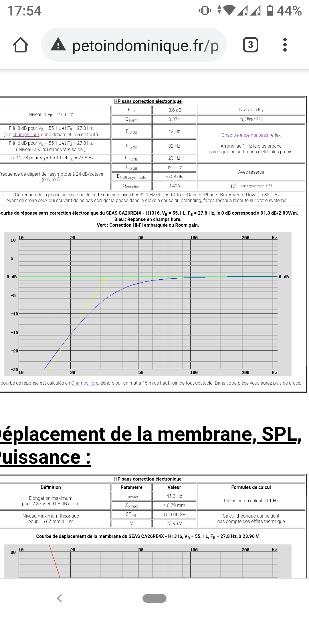

I was thinking of finding a more efficient woofer/tweeter combination but leave it with the current configuration, if possible.
You have +/- 92dB, why more!? Then it's a different project, not with the classic vintage woofer reborn.
That makes sense. I very had good luck with the variovent, but it quickly becomes non-linear at higher output levels with a larger woofers in larger enclosures. Multiples appear to work ok, but they still make noise at lower frequencies before the woofer runs out of excursion.

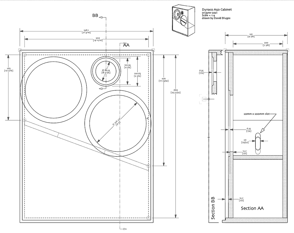

Hey quick question, I'm building the standard SEAS A26 kit with the 28L cabinet and I'm trying to figure out where internally to mount the crossover capacitor and resistor. since the side interior walls of the cabinets are now foam coated, the choices are the back inside wall near the binding post, or the front inside cabinet adjacent to the tweeter. Any opinions as to which is preferred, acoustically?
I'd mount them close to the binding posts and tie the cap/resistor in line with the tweeter wiring. You'll probably want to mess with the tweeter pad resistor to get the top end where you want it, so its easier to put it in line. Woofer is obviously direct wired, so just the two components in line with the tweeter.
Yeah, close to binding posts is what I'm converging on. Thanks.
