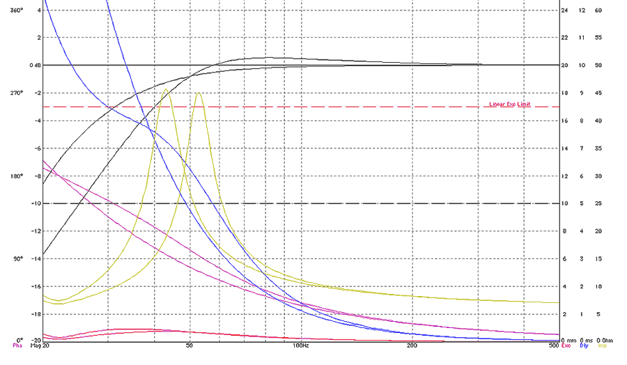

… you could build something around 60ltr and put a port in it tuned to about 22hz...
Not bad. (In theory) i could take the 70 litre box and add a miniOnken style vent that would push the bump down such that the response would tend towards the flatter 1 (140 litre tuned to 22Hz) i have shown.
attachment.php
dave
The “XO” in the A26 takes no consideration of box shape.
dave
The Seas A26 driver works well on the baffle that Seas recommend, and doesn't need a crossover or response shaping circuit on the woofer side, but when you change the driver positions on the baffle or change the baffle size, you change the frequency response.
Download The Edge or Baffle Edge Diffraction Simulator and model the A26 baffle, then move the drivers around (model the woofer and the tweeter) and see what happens to the frequency response. Obviously you're going to see a very wonky frequency response unless you model a huge baffle. What you need to look for is relative differences in the frequency response.

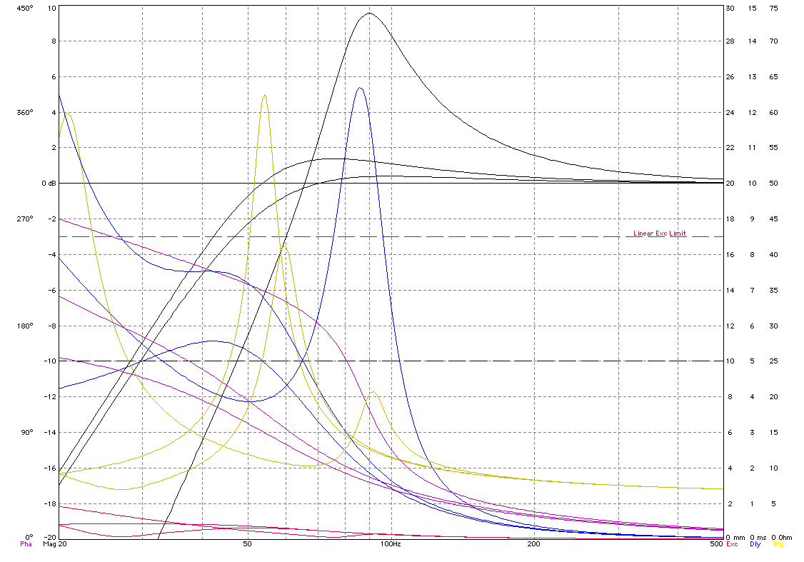

Regarding the large advents - About the flattest and most extended response I can model is with a 6" diameter port about 4" long - and the cabinet stuffed as much as possible to reduce the slight hump you get with a higher tuning frequency. There obviously needs to be a clear path from the driver to the port for the port to work properly. This is all assuming the enclosure is around 50ltrs.
2" diameter x 6”
6" diameter port about 4” long
attachment.php
The first makes sense, the second doesn’t. The third sim is sealed.
Like all but the 70 litre sealed the A26 in the Large Advent is a bit peaked. FatMarley’s venting gives a bit more extention, but with a bump before roll-off.
This places it on the spectrum between the 28 litre A26 box up to the 66 litre CGR.
So it could also benefit from a bit of aperiodic loading, a highR vent might be enuff.
dave

Yes, losing the bump is the whole point of the aperiodic vent. What we have is a range of boxes from 28 (A26) litre to 66 litre (SEA-Ken) with decreasing bump, making the job of tamng it easier.
This is one of the most advanced aperiodic boxes with a bit different kind of vent implementation, but it shows the path idea.
