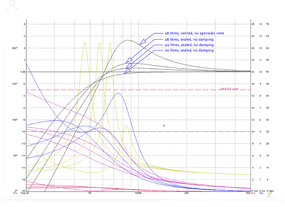

What's the main benefit to the big 70l+ sealed enclosure vs the 40-50l aperiodic? Lower frequency response?

attachment.php
Look at F6/F10.
dave
