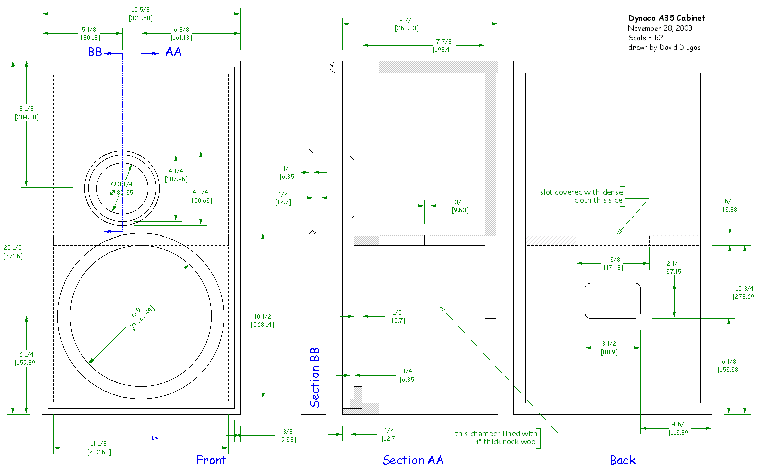

Obviously not a speaker guy. I find that far away spaced tweeters to be aesthetically poor.
It will, i think, be worthwhile taking the effort to move the tweeter.
Do note that the sparating partition is the wrong orientation to be a decent brace.
dave
We were cloning the A35 which has the speaker split into 2 chambers with aperiodic loading. Seeing other plans present on this site, I'd love to build one of the bigger cabs as specified. I'm sold on the drivers. At least I'm there. The future is always full of plans! Thank you.

In the A35 they got the tweeter as close as practical to the woofer.
