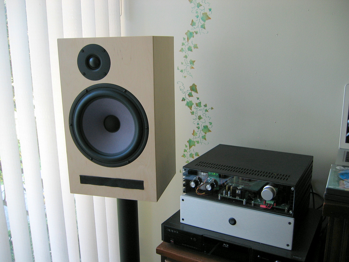

Working and sounding mighty fine!
Decided to defer the finish until a later time. Probably some nice veneer. The Baltic birch doesn't look half bad, but this was turning into the never ending project as is and Zia was harassing me. 😛

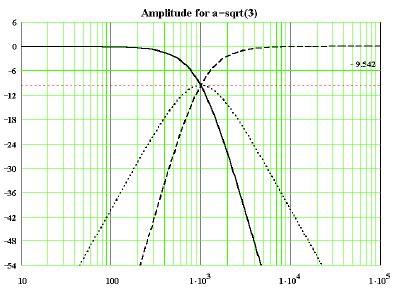

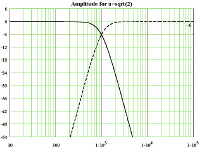

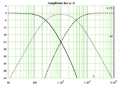

Let me give you an example in Audio Genius Steen Duelund, well one of my heroes anyway. This guy worked out that a three-way is just a variation on a two way. A spectrum of mathematical solutions.

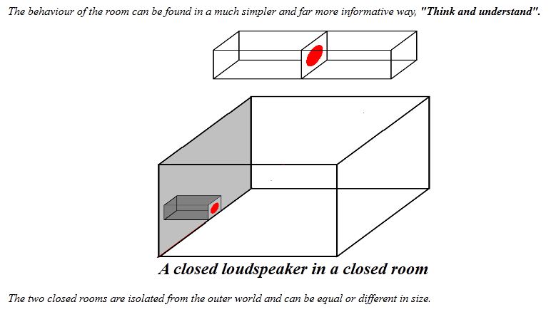

He also had an incredibly interesting view of the speaker box versus the room. You can just play with the relative sizes. You can equally apply cabinet damping to the inside of the box as the outside. Amazingly creative.

Thanks for the comments, guys! It's really gratifying to finish a project like this and have it exceed your (listening) expectations.
On bracing. I can't say if the A26 benefits or not, or if my implementation was optimal. This project was a tune-up for something more complicated, so I used it as an opportunity to learn my tools and develop my techniques. Perhaps someday I can audition my version with other versions. I can say that I'm super happy with the outcome. When I look back at the hours spent and the tools purchased, the Madisound cabinets are a real bargain!
On finish. Need to stare at these for some time before I make a decision to veneer or not. Need to learn their personality - like a newborn. There is something simple and elegant about the raw BB look (a la Troels masterpieces). I'd seal them now, but my preferred veneer attachment is heatlock glue, which works best on a porous surface. I brought the wood home in early October 2016, so I don't think it'll mind waiting a while longer. Besides, my workspace is now reconfigured for amp building!

Too early for meaningful impressions - still adapting and haven't cycled in other amps yet. There was definitely a change in the first 2 days and right now I would not call it warm at all. Think I will need to try the 12ohm resistor and stuffing quantity. Will say that I turned it up to 11 last night to show it off for some youngsters and it certainly does impress at high volumes! 😱

I think they're beyond good and maybe even great. But I want to spend more time getting to know them with various configurations. Changed the amp tonight and I'm getting some new character. For sure, the mid/tweet is a star.

Been using them daily since I hooked them up and the initial build euphoria has not worn off at all. Still need to connect up some key amps and torture test. The larger A26 is blocking vertical growth of my tower of diy electronics, so need to shuffle things around. One thing I find particularly impressive is the quality when the volume knob is twisted to the right - and this from a humble Wiener Pro. Super smooth and non-fatiguing.
More when I can, driven by Pass designed M2 clone and VFET, and hopefully also even an F6.
