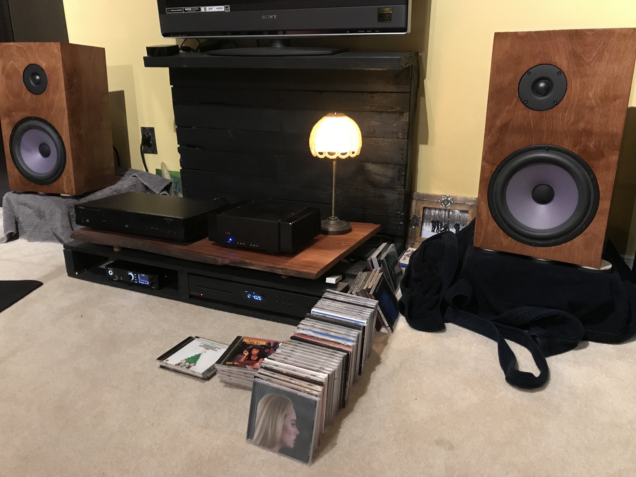

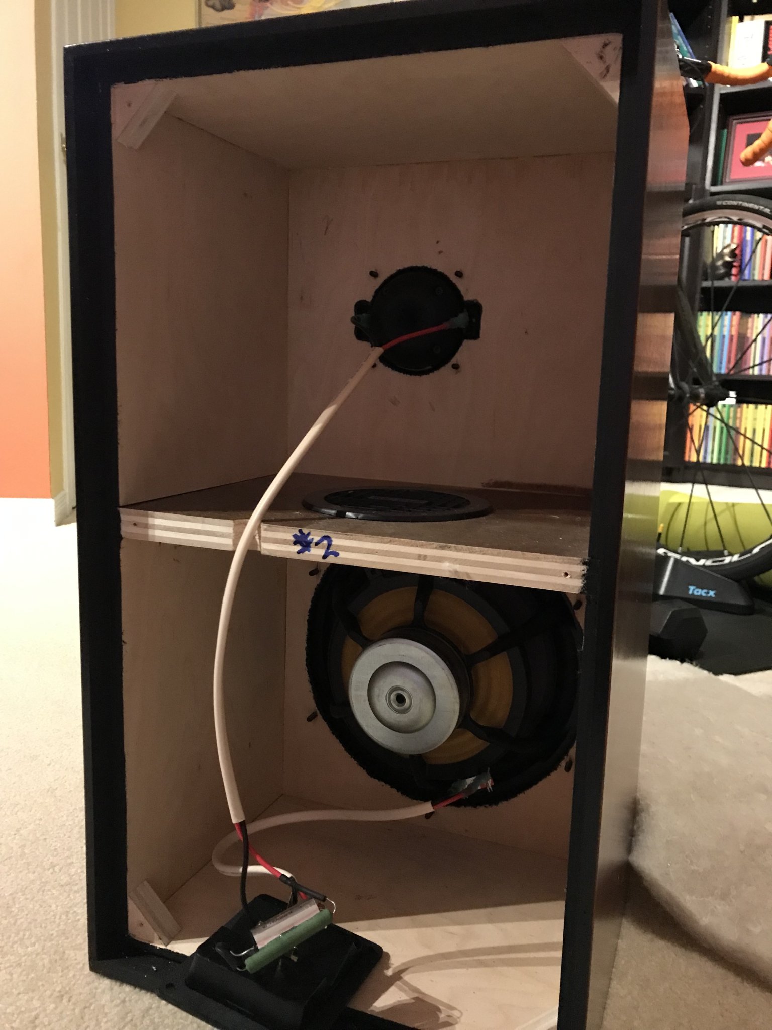

My version of the A35. I've listened to the original A35 and loved it! But there have been modifications I am willing to share. 🙂
Can you get the tweeter closer to the woofer? They should be as close as possible.
dave
Dave,
I know! That was the plan! My builder wanted an aesthetic build.
Since I'm sitting 11 feet from the speakers I'm not noticing anything untoward the sound; I've been reading on this particular faux pas today.
This speaker build does more things right than wrong which has me so please with the result. Taking baby steps to further improve the sound.

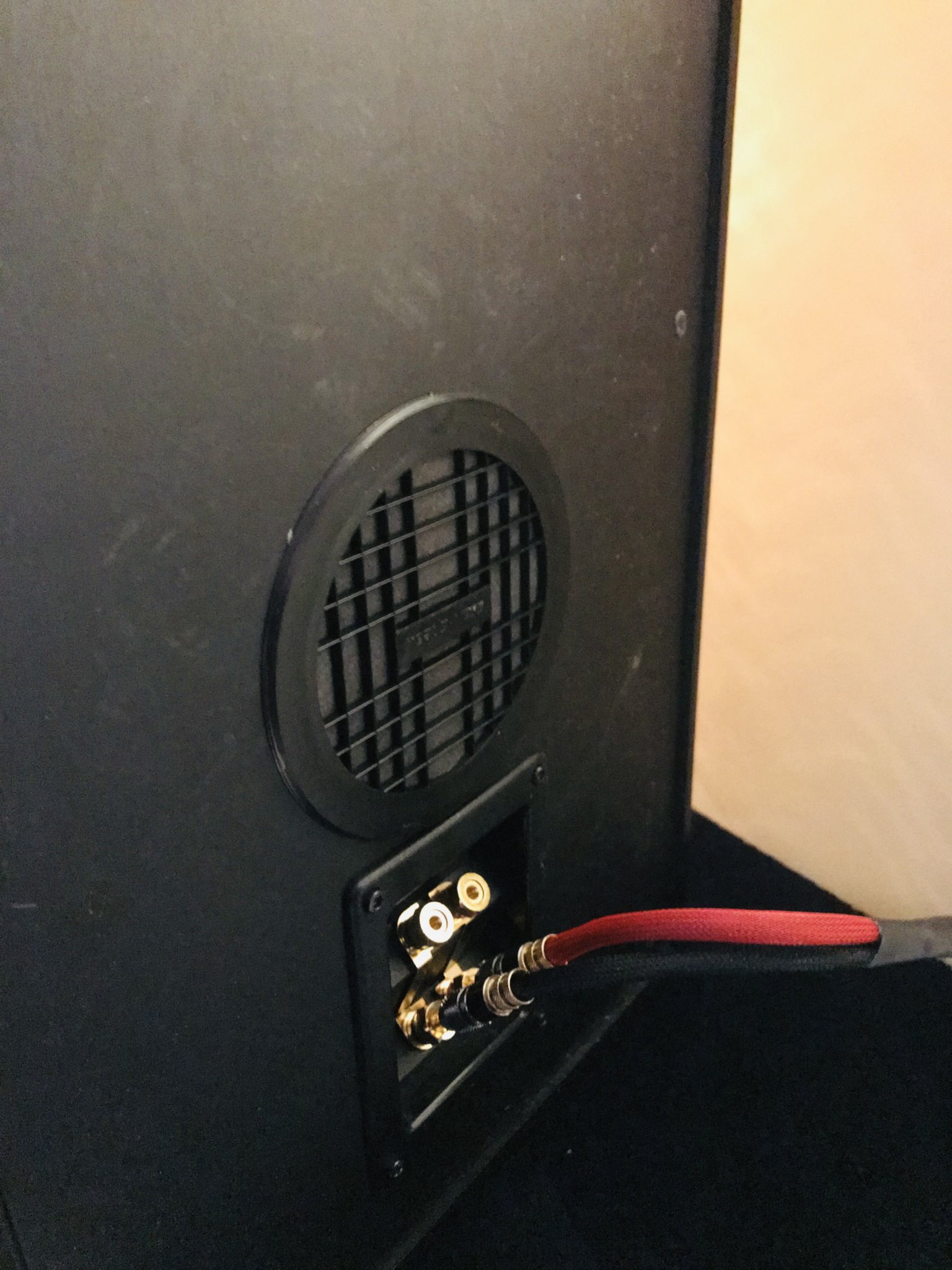

Another deviation from the A35 build: I did add an aperiodic port out back this past week to improve the bass, which it did.
A local engineer audiophile friend of mine suggests I remove the internal vent, leave the brace in place and put a few more holes in "said" brace to further improve the bass response of the enclosure.
I'm thinking about it. If I do it, I'll be closer to the A26 speaker with a bigger cabinet. Based on the driver's specs, it should be able to handle the extra volume even if aperiodic.
