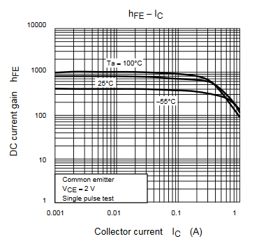

TTC007 is a high beta transistor, Hfe 400 1000.
It is not a super beta transistor with Hfe well beyond 1000.
I see TTC007 has base emitter limit 7V, this means it is a classic bjt that doesn't need special protections as needed by the true super beta transistors because they have extremely thin BE junction.

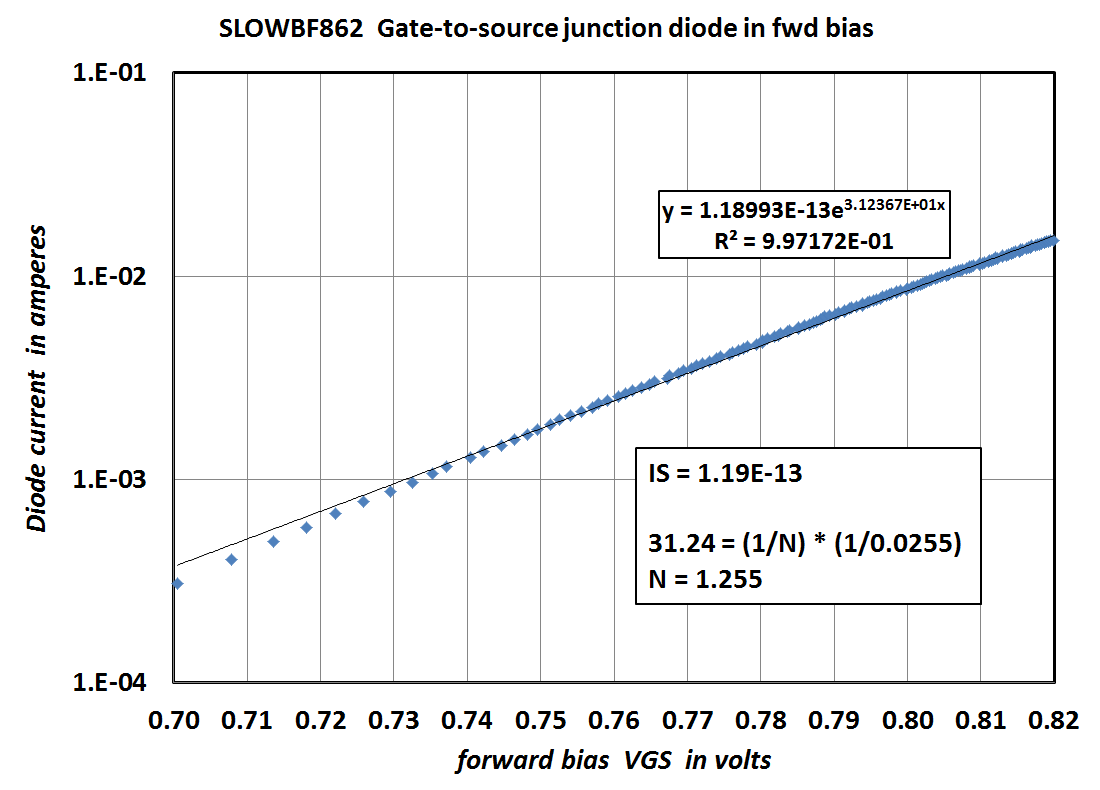

The gate of a JFET is just a diode; and on a silicon JFET it's a silicon diode. I myself fitted the spice parameters of a JFET gate diode, the NXP BF862:
_
Each of the light blue diamonds is a measured datapoint (from the LockyZ curve tracer) and the black line is Excel's best fit via linear regression. The output from Excel is in the upper box, and the spice parameter fitting (parameter names "IS" and "N") calculations are in the lower box.
It's all in post #1 of this thread
https://www.diyaudio.com/forums/solid-state/296335-ltspice-models-worst-bf862-jfets.html#post4821746

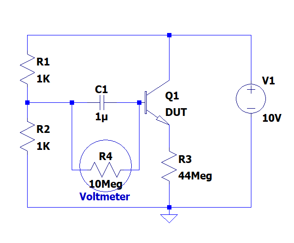

I have just measured a dirt-cheap, Chinese (but recent) S9014.
At Ic=1mA, the Hfe is 330, quite normal, and at Ic=100nA it drops to 250, which remains perfectly acceptable.
This is the test circuit I used for the low current measurement.
It is easy to reproduce

Good to see reliable data at 0.1μA Ic.
That must be pretty tought to deal with 44 MegOhm resistors.
To measure below, one could put the DUT as a driver to a known transistor in a Darlington configuration.

44 Meg is still easily manageable (2 x22 Meg), and indeed now that we know that the base current is 0.4nA, it can be used to load a darlington stage in front.That must be pretty tought to deal with 44 MegOhm resistors.
At this level, some more precautions will be required to obtain a stable measurement
