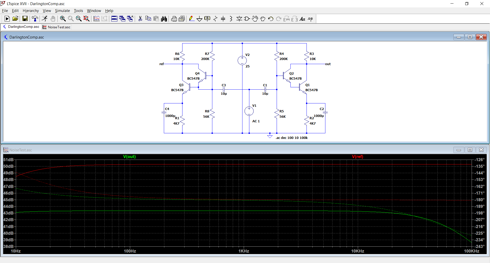

Rather than cascading a LM1818 ( a fixed 18V series regulator ) to obtain a 50dB improvement, one can Darlingtonize the pass transistor adding a dirt cheap low power bjt ( plenty have Beta > 350 ). This gives +50 dB loop gain, that does the improvement.
Wow, +50dB loop gain from two emitter followers in series! And I thought each emitter follower has a voltage gain of 0.99X, meaning that a cascade of two will have a voltage gain of 0.98X. Better check those textbooks again.
If I did the arithmetic correctly, +50dB loop gain is 316X. From two emitter followers in series!

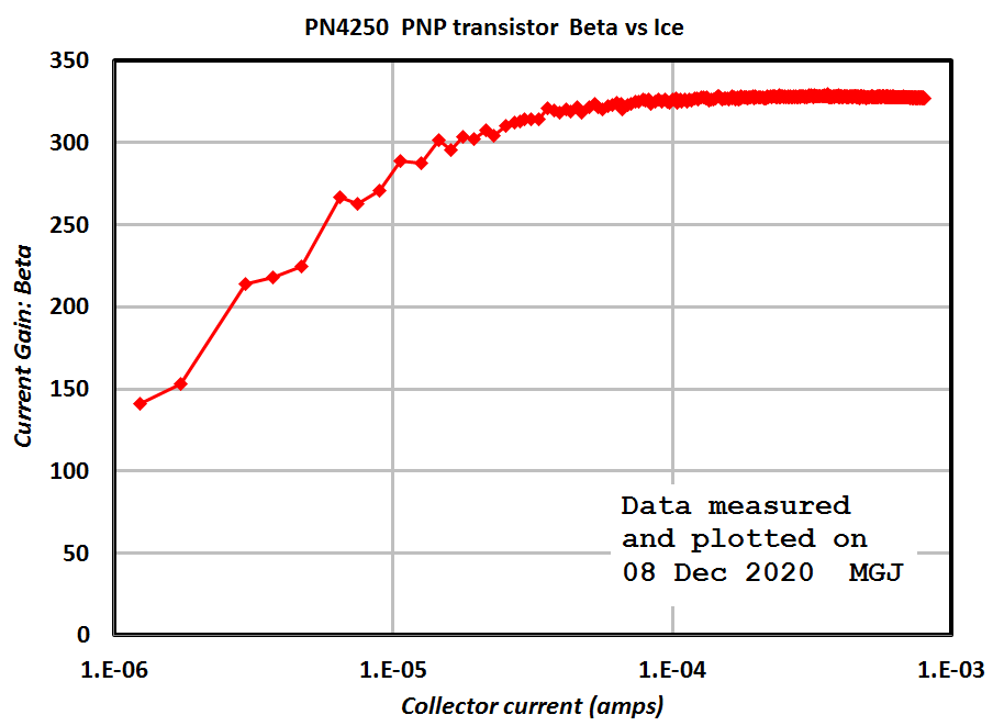

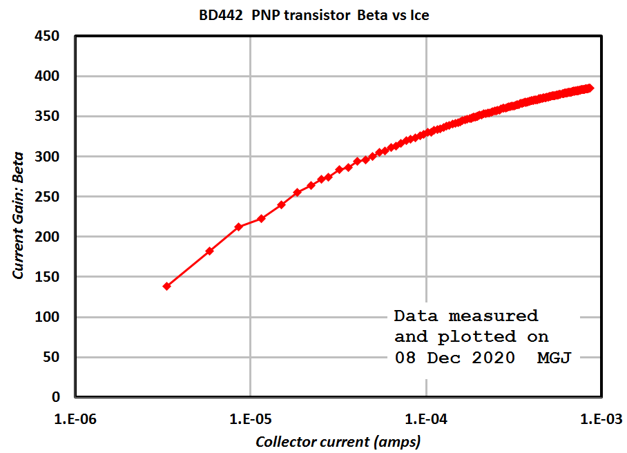

Bjts have Beta droop at low current.
How bad, is this ?
What low power transistors have good Hfe at collector currents well below 1mA ?
You will NOT work "well below 1mA".
For your stated 100mA power supply, suppose you use a TIP31 pass transistor, minimum Hfe will be around 80
Suppose you want a safety margin just in case you got a bottom of the barrel one, assume Hfe=50
So base current (which will be its drive transistor Collector current) will be 2 mA, definitely not "well below 1mA"
Using a BC548 transistor, as generic as can be, its own Hfe is ruler flat at such currents:
[see attached image below]
so no need at all to search for "special" devices for such a plain vanilla circuit.
Others have already answered.
Earlier, I also compared the voltage gain of a single transistor and a darlington.
Yeah, the darlington will not be of much improvement of the ripple rejection, since it is dependent on the voltage gain. At the most you gain 20dB by increasing the resistor 10 fold.
But another 100uF on the output will. This cannot be done with an integrated regulator because of stability.
you get -40dB at 100Hz and -60dB at 1k
Now if you add another stage -80dB at 100Hz. This is the most efficient., takes only 4V away.
