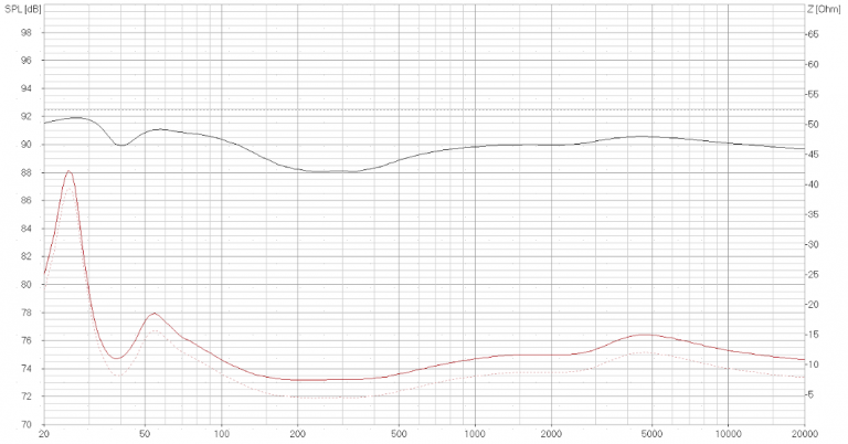

A more suitable relationship in the present case is V = E - Ir where V is the voltage available at the loudspeaker terminals, E is voltage developed by the amplifier and Ir is the voltage 'lost' across the internal resistance (r) of the amplifier. N.B. For internal resistance (r) we should really read output impedance (z) in the current discussion.I thought Ohm's Law was V= I x R as it goes.
From this relationship it is seen that the greater the current, I, drawn from the amplifier, the greater the 'lost volts' (Ir) and the smaller the voltage available to the loudspeaker.
In other words, if we ask the amplifier to deliver more current, the output voltage at its speaker terminals sags.
This is particularly of note with an SET amplifier of high output impedance when used with a loudspeaker which exhibits large variations in loudspeaker impedance with frequency.
When the impedance of the speaker goes low, the current increases and the voltage sags. The resulting SPL 'tracks' the impedance curve - dropping low when the speaker impedance drops low and rising high when the speaker impedance goes high.
The SPL is modulated as shown in the attached graph obtained courtesy of: Loudspeakers and Single Ended Tube Amplifiers - TestHiFi
So, as Steve correctly says, the ideal match woud be a loudspeaker with an overall flat impedance curve.

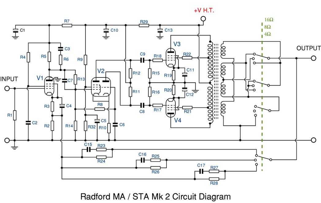

But what we are talking about is Valve amplifiers. I inherited this astonishing Radford STA-25 amp. Goes for big bucks on eBay.
Very different animals from your more usual Rotel Voltage Feedback jobbies:
Honestly, price no object, give me valves any day:

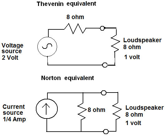

Damping factor is an indirect measure of output impedance and is a term mainly intended for the layman.
It's more easy for the average punter to understand that a high damping factor gives better control of the loudspeaker.
Of course, output impedance is the correct measure as it remains the same regardless of the impedance of the speaker load.
If an amplifier has an output impedance of 1 and it drives an 8 ohm loudspeaker then the damping factor (Zls/Zout) is 8.
Connect a 4 ohm loudspeaker and the damping factor becomes 4, suggesting damping has decreased, when in fact output impedance remains the same.
