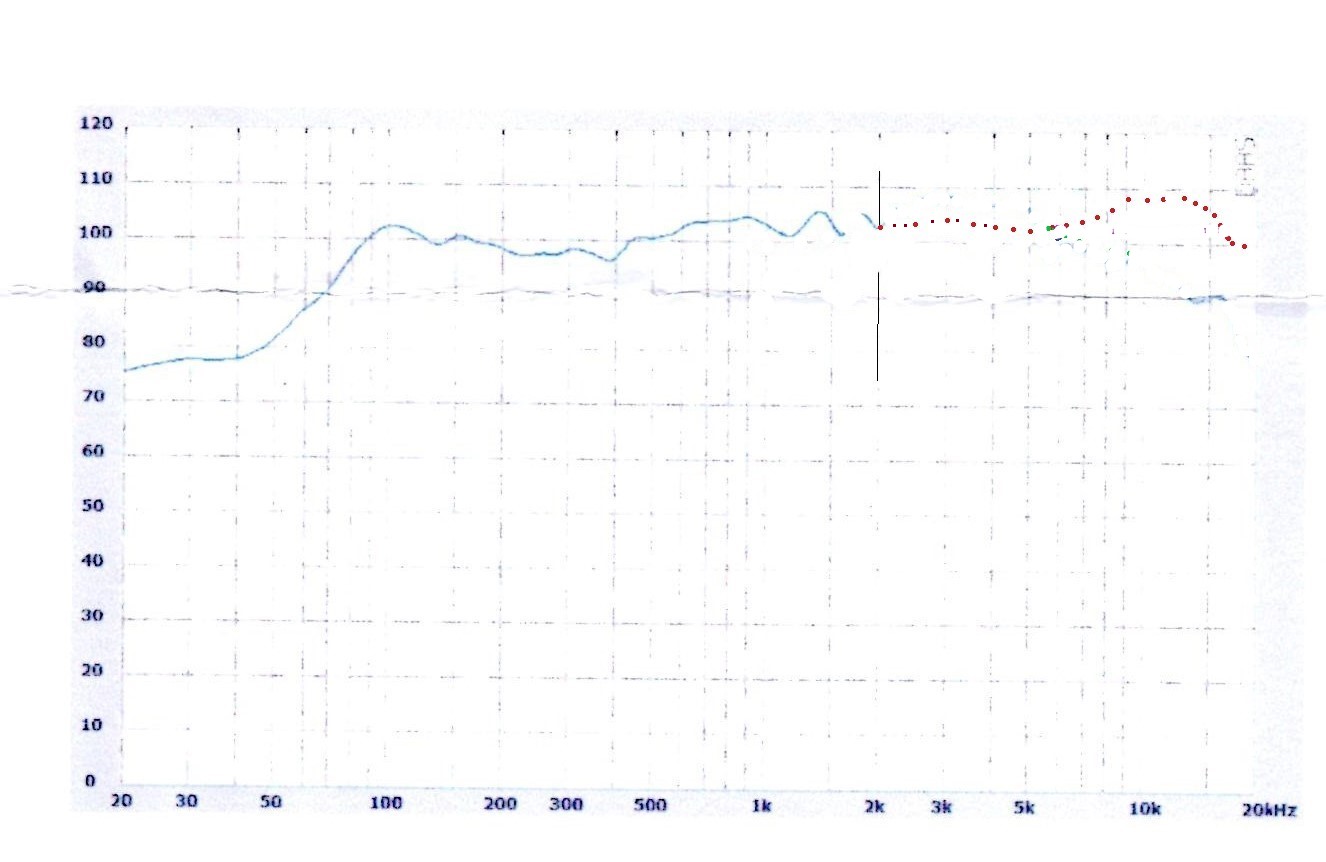

My choice for an ultra-efficient two-way...been tossing this one around for awhile
Audio Nirvana 15 classic ferrite, a fifteen inch so-called full-ranger, and the Aurum Cantus G1 ribbon driver on top.
With sensitivities well in excess of 100Db...
A vented enclosure of 375 liters, tuned at an fb of 33.5, giving an F3 of 31.62
I believe it will get the job done & done...

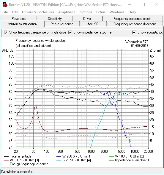

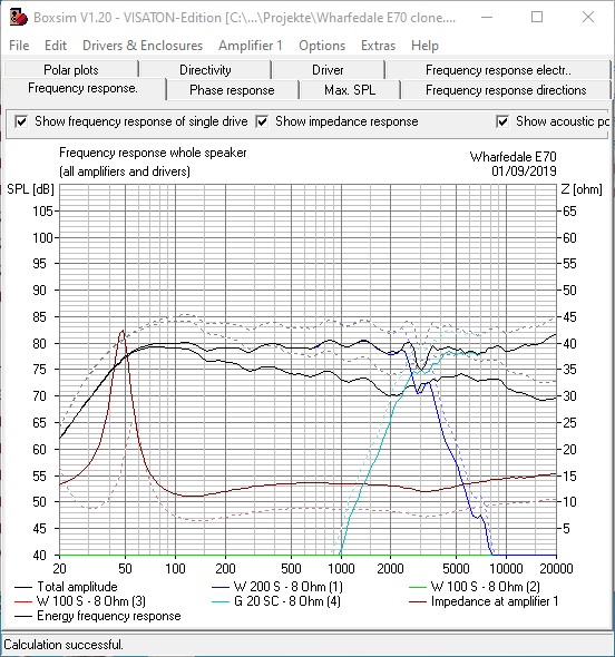

I have delved into this closed box/reflex issue with SET. 8" plus 1" as it goes. Closed Box (single peak) works nicely, even deeper, with SET. Reflex (double peak) gets a bit uncontrolled and flabby.

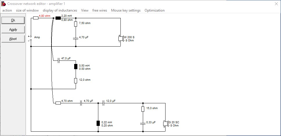

Below a few comparisons. I corrected the midrange impedance with an LCR, because that keeps things flat.
I think my added 4.8R resistor is doing the right things to simulate a SET amp.

Anyhow, the answer to the SET amp question is Closed Box IMO. It stays well-behaved with an output amplifier resistance added.
Software | Visaton
Valve amps in general don't like reflex loading. Not surprising since Reflex is designed for tight control from a low output impedance Voltage feedback amplifier. With SET amps, you must also try and keep overall impedance flat. Otherwise the frequency response goes wobbly.
