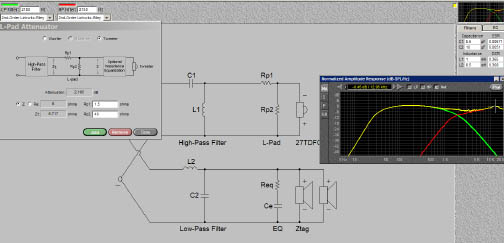

Something I put together at lunchtime. Starting to look good. I don’t understand why X-Over pro is predicting a slight bump in 13khz region even with Zobel but I don’t think it will make a difference. The drivers natural roll off will compensate for it. If necessary, a notch (LCR) could be added later,,,,,, if it’s really audible.
From the graph it looks like Z-tags are also going to sound heavy from 1000hz down, but I don’t think this will be the case because of the eminent baffle step comp. In order to determine roughly and predict it, I would need the geometry and positioning of the drivers.
If it is indeed the case with a pair of Z-tags over powering the tweeter, then a simple L-pad will correct the problem. However, it has to be decided by you after the x-over is together and the drivers are installed.
BTW, what is the spacing between the center of the tweeter and the center of the lower woofer? It will actually help determine correct crossover frequency.
I don’t have enough knowledge and experience to design a 2.5 x-over and I am not a big fan anyhow. Attached picture is a predicted model based on available info and woofers, wired up in parallel. I’ve also changed from Butterworth to L-R type which gives slightly flatter frequency response.
Any other opinions?
I don’t know how to post a high res picture so there it is.

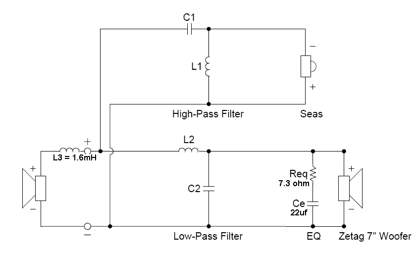

I kind of lost this thread.
For 2.5 way, you just cross one of the woofer (usually the bottom one) lower, like a real woofer. The other woofer would be crossed to the tweeter and go all the way down.
The distance between the tweeter and the bottom woofer is 16" center to center on the mains. The MTM center distance between the tweeter and each woofer is 8 1/2" center to center.

I can't tell by screen shot on the x-over design, from where to where is the frequency response within 3db?
I can email you a hi-res shot but it’s still a very raw version of x-over. I modeled it on the unshielded version of the tweeter. BTW the bump at 13khz is caused by a Zobel. It evened out response at the x-over but added that small hump. More playing around is due.
BSC will start around 1700hz and my guess is that it will gradually lower frequency response by 3db. Therefore, I wouldn’t worry about efficiency of the tweeter.

Same ideas, similar crossover designs. He modeled on shielded version of the tweeter and I modeled on unshielded. He also used X-over pro software.
So, which tweeter do you have? TDFC/TV or TDFC or TDF? There are slight differences that needed to be accounted for in the x-over design.

Jon, don’t you think that a second woofer should be after L2 and C2? You need to cut hi frequency from going to both woofers anyways right?
R-Carpenter said:Jon, don’t you think that a second woofer should be after L2 and C2? You need to cut hi frequency from going to both woofers anyways right?
Hi Roman,
L3 cuts out anything above ~600hz on a 1st order BW slope. This driver would act as woofer. The second one acts as a typical midwoofer in a 2-way, with it's xover point with the tweeter.
This reinforces the bottom end and provides some BSC.

Ok, so how would you go about calculation of impedance curve of the lower woofer and it’s effect on the crossover performance? Also, Since BSC starts at 1700hz, would it make sense to cross it over higher? Do you design the x-over as a 2-way with Zobel and then add secondary woofer with coil and hope for the best?
I understand the general concept; I just don’t know how to go about calculations. I think it’s an interesting opportunity here. Would it be possible to come up with a good x-over design without actually measuring response of the speaker?
