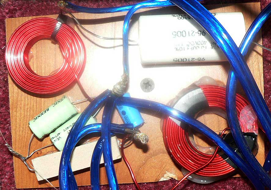

That looks like a 2nd order filter on the low pass, 2nd order on the high and a Zobel.
All of those wires hanging around untaped is asking for a short. Could be made more tidy.
I second that.
Impedance EQ with resistor and a electrolytic cup.
I usually place and glue all components on one side and do all wiring on the back. I also silicon the wires so they don’t hang around like that.

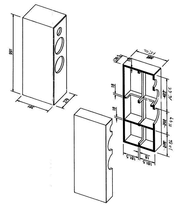

BTW, it is not MTM. True MTM has a tweeter in the middle and the distance between the center of the tweeter and each woofer are equal to a length of the sound wave at the crossover frequency. I had an idea that we could backtrack crossover point from the location of the drivers.
Is this my correct understanding that you have 2 main speakers ported and center closed?
Yes the mains are ported, they are the cabinets that I referenced the sizes of before and the drawing that he posted for me is. The mains are not MTM, the center is MTM, is sealed, and is smaller. I could measure that cabinet or look for my notes on that if it would help. Same drivers and x-overs as the mains, I wanted to maintain the timbre for the HT application.

What are the component values in the crossover???? Can you draw a diagram of it???
The photo shows 2 coils, 1 big cap, 3 small caps, a resistor and a snakes nest of wires.
Did you build the crossover? Is it wired correctly?
I did not build the crossovers, I bought them from the same person I bought the drivers from. I could try to get the valuse and write them down tomorrow evening if that would help.

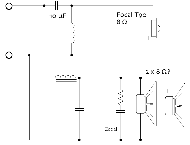

MJL21193 said:What are the component values in the crossover???? Can you draw a diagram of it???
Here is the probable scema. Anyone venture a guess as to the tweeter XO given the 10 uF cap?
If this is indeed whatthe XO looks like, the problem isn't the tweeter, it is the 2 midbasses going all the way up... it should be rejigged as a 2.5 way.

I agree with the schematic, but it's a little funny: 2nd order on both high pass and lowpass give near equal values for the inductors and the caps. Therefore, there should be another high value cap (that small blue one doesn't look like 10uF). Unless, the filters are mixed.
My guess is 2nd order Butterworth on the tweeter@ 2000hz and 2nd order LR @2000hz for the woofers. Coils would be .6mH on the tweeter and .95mH on the woofers.
100% agree Dave, it should be reconfigured as 2.5.
I believe the blue cap is 9.1uf.

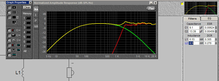

fantfool said:The tweeter inducter is .33mh.
IF the tweeter is filtered with a 2nd order Butterworth with these values you have tweeter impedance at 4 ohms and the crossover at 2800hz. That doesn't seem bad. Is this the tweeter impedance though?
For the mid woofers, you haven't said what the inductor is on those. Assume that coil is nearly the same (.33mH) and that with the paralleled impedance (the woofers are parallel, right?) and you have a 2nd order Linkwitz-Riley at 2800hz.
This seems reasonable for the drivers involved, though probably not optimized. Better results come from testing to determine the impedance at the crossover region, with the effect of the Zobel counted in. Then a whole system test to see the combined impedance.

OK, I went to the effort of looking for the specs on the tweeter - TC90, right? Impedance is 6 ohms. At this impedance and with those components, this crossover is no known alignment (not to me anyway).
Woofers DCR (as posted by Dave above) is 5.6. given the Zobel and the assumed crossover point, their parallel impedance should be 3-5 ohms.

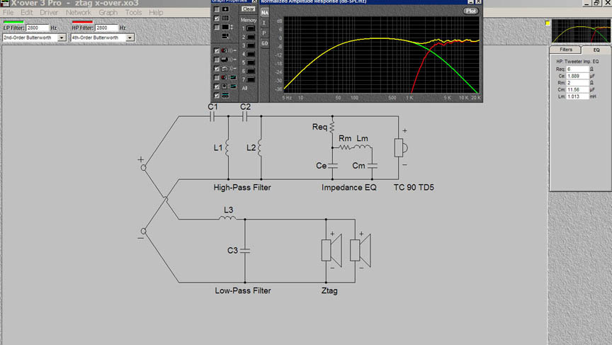

OK forget the x-overs I currently have since we are not quite sure what thet are, if you were to design a x-over for the given drivers, how would you recommend doing it to optomise those drivers, and would you use the TC90 or the 120?
This is roughly, what’s going to happen with the info that we have. I haven’t calculated Zobel or effects of the box and port or closed box. I also played with the inductor value for the woofer and 0.5 gives well-mannered results. According to the graph and my previous guess, TC90 is going to like 4th order x-over more then 2nd. It is quite possible to finish this x-over or design a better one. TC-90 definitely needs impedance EQ also.
