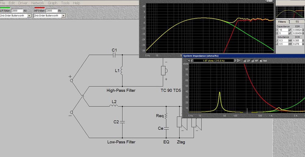

OK tonight I measured the woofer resistance and got 3.5 ohms on each. Also, I wrote down more of the information off the crossover parts shown in the picture posted earlier. Can I get any other information that would help figure out what is happening?

Based on the provided info, this is what I got. It appears from the modeling that this speaker has a nasty deep in the 1200hz. It also has a loooow impedance and drops down to below 2ohm. It also looks like these x-overs were put together rather in a hurry with less then perfect components.
I would just build new x-overs after you get more data from your engineers.

Nice work R-Carpenter.
If this woofer is simulated, there may be cone breakup with the real one at 1200Hz that would fill that hole.

Like I said, it's only a predicted response based on provided components value. Fant is hearing something bad and it may be that deep in the frequency response (I am guessing again).
Real crossover design will take some hours or so and would be different for a sealed center channel and ported sides.
I also can see there his Pioneer will constantly clip from a under 2ohm impedance. Not a good thing to have.
